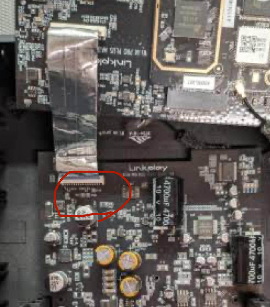

I think already nobody care about this topic, but today I got I2s signal from Wiim pro plus successfully (not pro, sorry).
I found out good points about pick up I2S signals.
But I have one critical problem right now.
I can listen until 96khz music but not 192khz …

Please tell us how you managed to do this?
Just seeking solder point of I2s output with tester.
You can see 4 point at red circle point, and buffer IC right hand side.
I forget to take any pictures about detail but you can understand detail with tester and dac chip (AK4493seq) document.

No, I don’t take the signals from ribbon cable. There are some “test points” on the pcb (sorry, pic is unclear but I think you can check other person’s photos), so I use these points. It’s not difficult to solder.Super interesting! Did you take the connections directly from the ribbon cable or elsewhere like the buffer you mentioned?Just seeking solder point of I2s output with tester.
Also do you maintain the rest of the ribbon connections?
Have a great day!
Jules
And I don’t test all functions yet but believe most function except analog output is still working.

I posted that I had a problem with 192khz data playback but now I solved.
actually I need to double mclk freq with ICS570B.
I don’t know all dac environments need this care, but it is needed for my environment, es9039pro based dac.

Hi narinari2106. I found a somewhat clear photo of the testpoints you tapped into. I see 4 test points tp17, tp18, tp19 and tp20 that you referred to in a previous photo. Do you recall what signals are associated with which test points? Did you utilize all 4 or just 3 of the testpoints? My external DAC has an HDMI input for the i2s signals and expect 3 differential pairs. Did you have to convert single ended signals to differential? Thanks...
Firstly, I can not say clear answer about which tp I used but I use 4 tps.Hi narinari2106. I found a somewhat clear photo of the testpoints you tapped into. I see 4 test points tp17, tp18, tp19 and tp20 that you referred to in a previous photo. Do you recall what signals are associated with which test points? Did you utilize all 4 or just 3 of the testpoints? My external DAC has an HDMI input for the i2s signals and expect 3 differential pairs. Did you have to convert single ended signals to differential? Thanks...
And I use I2s to HDMI conversion board, you can easily find out on eBay, AliExpress etc..

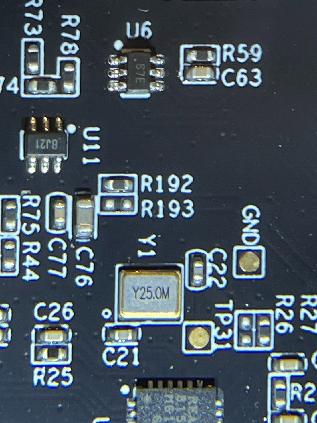

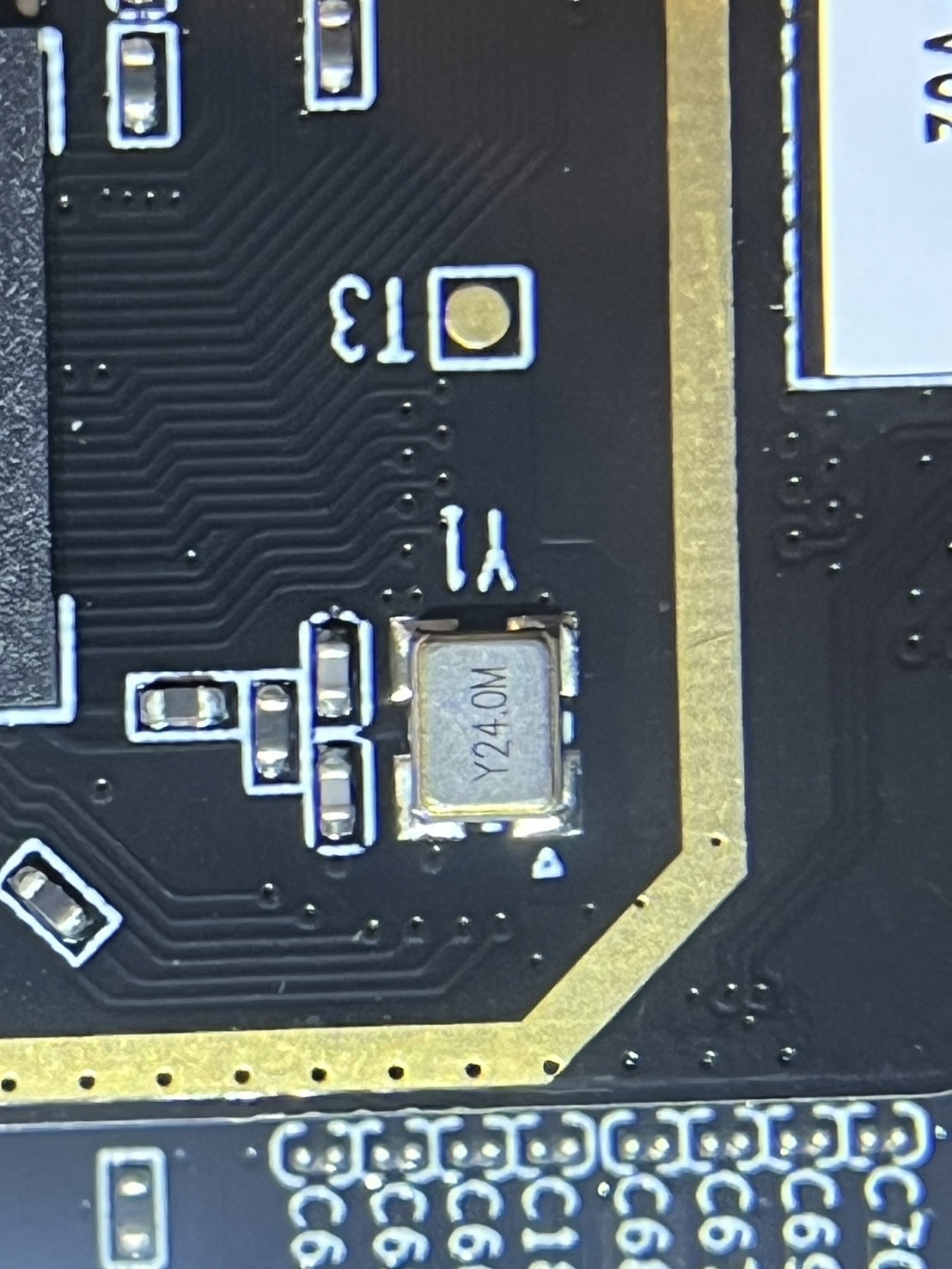

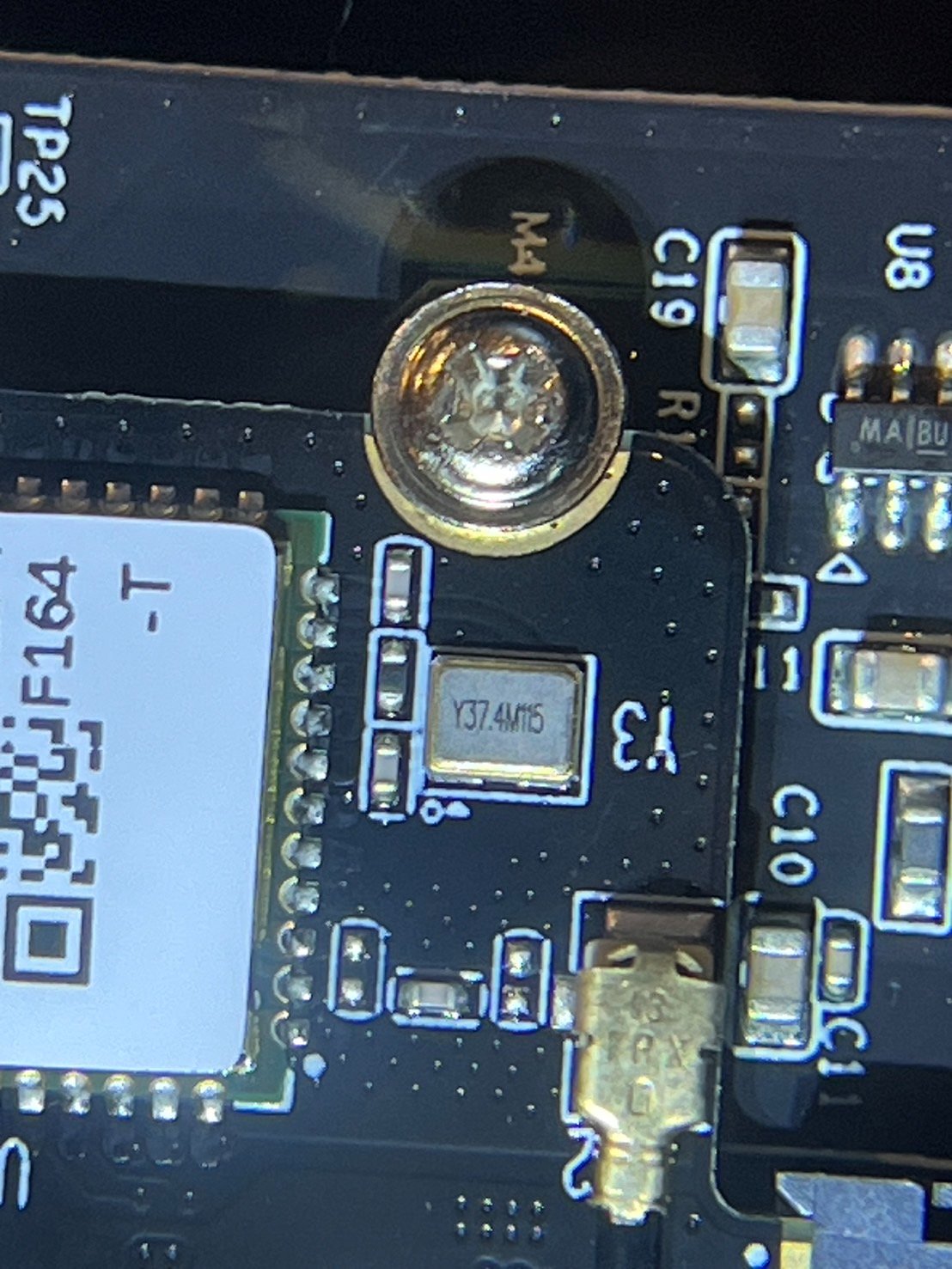

Hello everyone, an interesting topic. I was thinking to improve the SQ (I use digital coaxial output 99% of the time) from the wiim pro and had a look of the clocks used in it. I took some pictures of the 3 clocks being used.
I believe the 37.4M is for the wifi module, 25M is for the ethernet and 24M is the clock for the microprocessor.
They seems passive oscillators to me. In Rpi people claim replacing the passive XO to better quality active XO for USB, Ethernet and processor does improve the SQ, especially when connects to USB DAC.
I mainly use Ethernet connection and coaxial output, therefore I am thinking to replace the 24M and 25M XO. worth a try? any thought?
