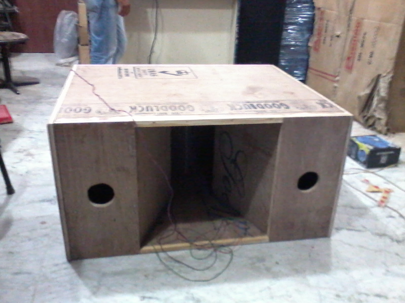

Posting for a friend just completed the WO32 Subwoofer.
http://www.decware.com/
The WO32 is a dual 10" subwoofer is a unique hybrid acoustic suspension and horn subwoofer.
Currently using a Vifa M25WP-09-08 10" woofer, Fs = 28Hz, Qts = 0.29, Sensitivity 92dB/W.
Sonically very impressive subwoofer, we had on hand a Linkwitz Thor sealed box subwoofer for comparision as well. The WO32 bass is fast and tight and IMO the horn loading arrangement moves quite a lot of air and presents a huge sense of scale in the bass, a most interesting effect.
The WO32 sounded best with the subwoofer flipped over resting on a piece of carpet.
Crossover used was a Behringer and a battery Gainclone were used as sub amps.

danvan said:Wow, if those are 10's how big is that beast?
The dimensions are 32"(W) x 24"(D) x 12" (H), some guys double up by using is as a Coffee Table.
I suppose he likes his coffee shaken, not stirred 😀 .

I dont know how anyone can really call that a horn Subwoofer. The horn length cant be more than 5 feet or so which gives a cutoff above 50hz which isnt close to a sub at all. Even a 30hz horn isnt truely a sub, but its ALOT closer. It might be loud... but I know it cant go very low
BassAwdyO said:I dont know how anyone can really call that a horn Subwoofer. The horn length cant be more than 5 feet or so which gives a cutoff above 50hz which isnt close to a sub at all. Even a 30hz horn isnt truely a sub, but its ALOT closer. It might be loud... but I know it cant go very low
Not a horn expert but this hybrid type horn can definitely go down below 50Hz, the Behringer was set to cross at 40 Hz and there was still quite a bite of bass comming out of the subs... Of course the Thor subs had more lower bass but the Fs of the Thor driver was 20Hz compared to 28Hz(Vifa) of the WO32 . We will be trying out some vinatge 10" woofers with FS around 20 Hz so we'll see how it turns out.....

The site claims bass down to 28 Hz, but given the size, they have obviously gone for fairly low eff for a horn, claimed at 93 db. I'm a little surprised they are able to get that low with such a small box.
i had not read that the site said 28hz, but that is neat because my ears agree. i must have done something right.
Here is a pic of my very small downscaled WO. I use two 5½ inch "woofers" (ex coaxials with tweeter stripped of) and NOBODY who hears them belive that its only two cheap small 5½ inch woofers shaking my apartment. I love playing techno and bassheavy music so loud it rattles my windows and bookshelf. It does well down to 35 hz but falls rather quickly below.A funny thing is that it gives a better impression of going realy deep than my previous subb that realy did hit 20 Hz.(Two 10 inch woofers in a closed box with electronic compensation)

I just thought I might inject a pinch of clarity here: the original post is regarding the WO32; some subsequent posts mention the free version which is a fourth order bandpass with a horn port. Maybe everyone already had it sorted out but I thought it couldn't hurt to mention.
good point.
on that note, on the website it claimed chamber volumes were not critical because of the horn loading. I believe that to a point, but there must be a way to get even better performance with a properly tuned box. any tips?
obviously it would be tough to increase box volume, but we can damp and derease it.
