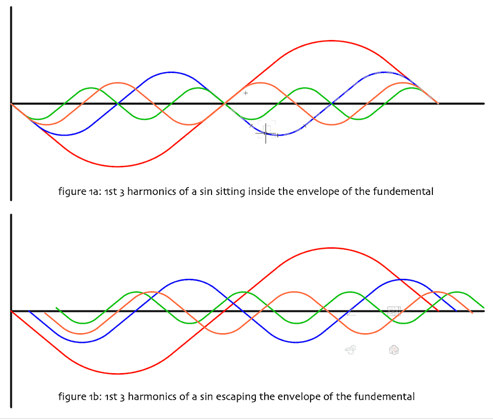

Phase of partials can change a sound

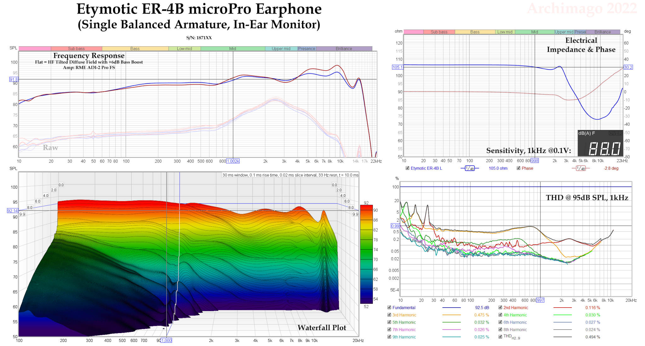

Unknown without reviewing. Regarding "Audibility of Linear Distortion with Variations in Sound Pressure Level and Group Delay", unfortunately the protocol's trust in what at that time was a class leading IEM could be questioned as subjective. Distortion plot below courtesy of Archimago. http://archimago.blogspot.com/2022/03/measurements-etymotic-er-4b-classic-in.html
"The stimuli were presented via the Etymotic ER-4 MicroPro insert earphones."
It's reminiscent of a similar "trust oversight" rendering the results of a published Redbook vs 24-bit "shootout" essentially valueless IMO. From memory three independent kiosks were erected giving listeners the opportunity to compare music cuts in both formats in a completely relaxed and no pressure environment at their leisure. All sources were silver disc. Statistical analysis returned a null result. Unfortunately the experimenters apparently didn't check that all three players were technically capable of 24-bit performance, nor do I recall (perhaps unfairly) that the music selections were true 24-bit sourced beyond looking at the packaging. Test results elsewhere on one of the machines suggested it topped out a little over 17-bit. This was all prior to sites like ASR helping to clear up the mess.
Measurement instruments aren't a shield against bias when science practitioners divide into ideological camps. Which isn't intended to accuse Geddes, which I believe was a genuine oversight.

Phase difference of only some spectral components always changes time-domain waveshape.
Interesting to consider what happens in a 3 way design. The midrange is a bandpass, with both a high-pass and a low-pass slope. On the high-pass edge, phase leads. On the low-pass edge, phase lags.
While I'm pretty sure this problem has been long solved by crossovers designed to not do this, I'm pretty sure that was a subjective perception initially, solved by an objective application of mathematics and corresponding circuit design.
