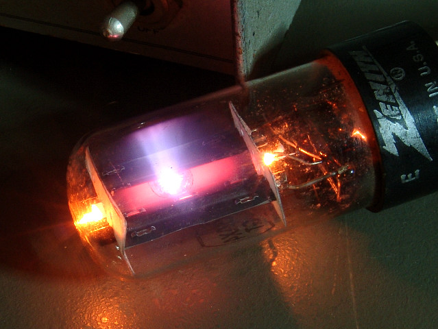

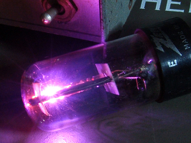

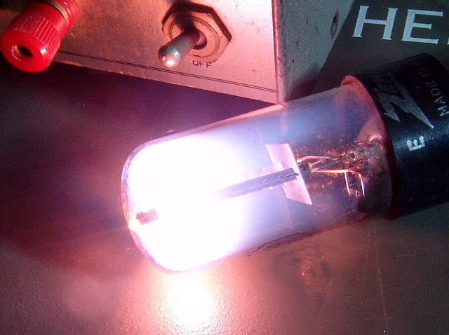

Back to rectifier tubes. I, and my customers have all had brand new production 5AR4's spark out on initial start up. Sometimes 2 or 3 will blow on power up, but once a good one is found they will usually live for a few years. Autopsy on failed tubes reveals sloppy construction, either an uneven cathode coating or sometimes poor plate / cathode alignment. Either of these conditions causes all of the cathode current to flow through a small area exceeding the current density causing an arc. This has been seen in all of the current production tubes and seems to be batch related. I do have an old RCA (made by Sylvania) 5AR4 that I have been using for about 10 years and it has no problem starting up into a 100uF input cap.
Lets assume we want to test the rectifier tubes before use to find defects. A conventional tube tester is virtually worthless for finding anything but a stone dead rectifier tube. I have rigged up testers for many different tubes, but I have yet to find a method for finding rectifiers that will explode, except for an actual power supply.
There is however a simple test that can be done to find the tubes that pass a tube tester, but can cause hum or IMD in an amp (yes you can hear it if it is real bad). A full wave rectifier tube like the 5AR4, 5U4, or 5Y3 can have a mismatch between the two plates. It is usually worse with indirect heated tubes like the 5AR4. To test for this, light the heater, ground the cathode, and apply a fixed current to each plate (use a CCS or current limited power supply) of a magnitude equal to the maximum tube spec, aor the amount that will be seen in the actual circuit. Measure the plate voltage for each plate. It should be considerably below the value given in the tube manual, and each plate should match within a few volts. A mismatch will cause 60 Hz (or 50 Hz) ripple that can cause hum, or low level 60 Hz IMD.
I use this method to select a handful of good tubes to keep from a large box full of used tubes. If you are going to make a bridge with damper tubes, use this method to find 4 that match for lowest B+ ripple.
So I find a big box full of 6AX4's, grade out some with the lowest voltage drop, writing the number on each tube, select 4 with matching numbers that are all made by the same manufacturer. I stick them all in an amp, flip the switch and zap the line fuse blows. In my usual style I stick in a bigger fuse and repeat. This time one of the rectifiers sparks out, glows blue, and then the fuse blows. New tube, amp works. The tube that tested good, but sparked out has a hole through the plate! It has obviously seen some hard use. End of story????? Is my name Tubelab????? Do rectifiers glow????
I decided to repeat my matching setup, but this time I set the power supply current limit on 1 amp instead of 200 mA. It would see 4 amps before I was done.
