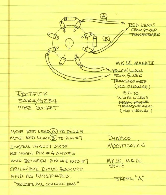

Why not just do this , post #34. You still keep it with the benefits of the slow warmup. Low cost, will last and NOS preserved longer! Nice on vintage amps to keep the same tube too!
http://www.diyaudio.com/forums/tubes-valves/214534-why-gz34-rectifiers-so-expensive-4.html

Your B+ goes up by the voltage drop of the GZ34 (only 15 or so volts for GZ34).
SS diode characteristics are different than tubes, faster turn on, turn on at higher peak with greater current draw vs the tube with a greater voltage drop. This impacts power supply ripple.
1N4007s are noisy, but UF4007 would be quieter. Or you can add snubbers.
If I were to do that, I'd use a octal plug and build a module to replace the tube without modifying the chassis. Thus if I ever found a reasonably priced NOS GZ34 I could swap it out.
a 60R 3W resistor in series with the diodes might drop the 15V, but I suspect the dynamic resistance of the GZ34 is lower and so there would be more sag in the B+ supply with the SS/Resistor combo.
Hmmm. Just looked at the curve for the 5AR4 and at 225mA the dv/di is 1V/25mA for a dynamic impedance of 40 Ohms, so the SS/R combo would have more voltage sag.

The tube still works as intended and you don't get any change in voltage. It takes a fair amount of the load off the tube in so helping high load situations (bigger amps). If the power flashes off and on in a failure or accident that can help expensive NOS too.
You don't have to put the diodes on the spare pins as in the drawing I found. Just put them on the leads to the tube and put good shrink wrap over them.

No, there is not a slow start-up with 1N4007.
If you must use silicon diodes, then a single TV damper diode in series could be used for slow start-up though.
They don't replace the tube, they just fortify it! You still get exactly the same slow warmup. Just try it!
The added series diodes do not actually take load off the tube. Since it is a series circuit the current through the tube is still the same and the VI curve of the tube rectifier still dominates in the forward (conducting) state so the tube rectifier characteristics are retained.
What happens is that the diodes dominate in the reverse direction removing the PIV stress on the tube rectifier. This will often stop a tube arc from starting, or kill the arc before the tube blows up. A tube won't arc over when it is conducting since the voltage across it is small. If the forward current is concentrated in a small area due to poor tube quality, creating a local hot spot, that's where the arc will start when the polarity reverses and there is 800 volts across the gap.
I have tested the diode mod several times and it will even save a tube that has already arcced over and become useless. it works so well that I added the mod to the new SSE boards since that design runs the rectifier near it's spec limit and has blown a few new production 5AR4's.
I've been using the diode in series with the plate approach on 5AR4 since the late 1990s, and can confirm it really prevents a lot of trouble for the reasons tubelab explained in the previous post.
I use them also in applications with 5U4 when the tube is used at voltages close to its rated maximums.

It enhances the tube circuit by blocking PIV. I'll implement that before installing the JJ GZ34.
