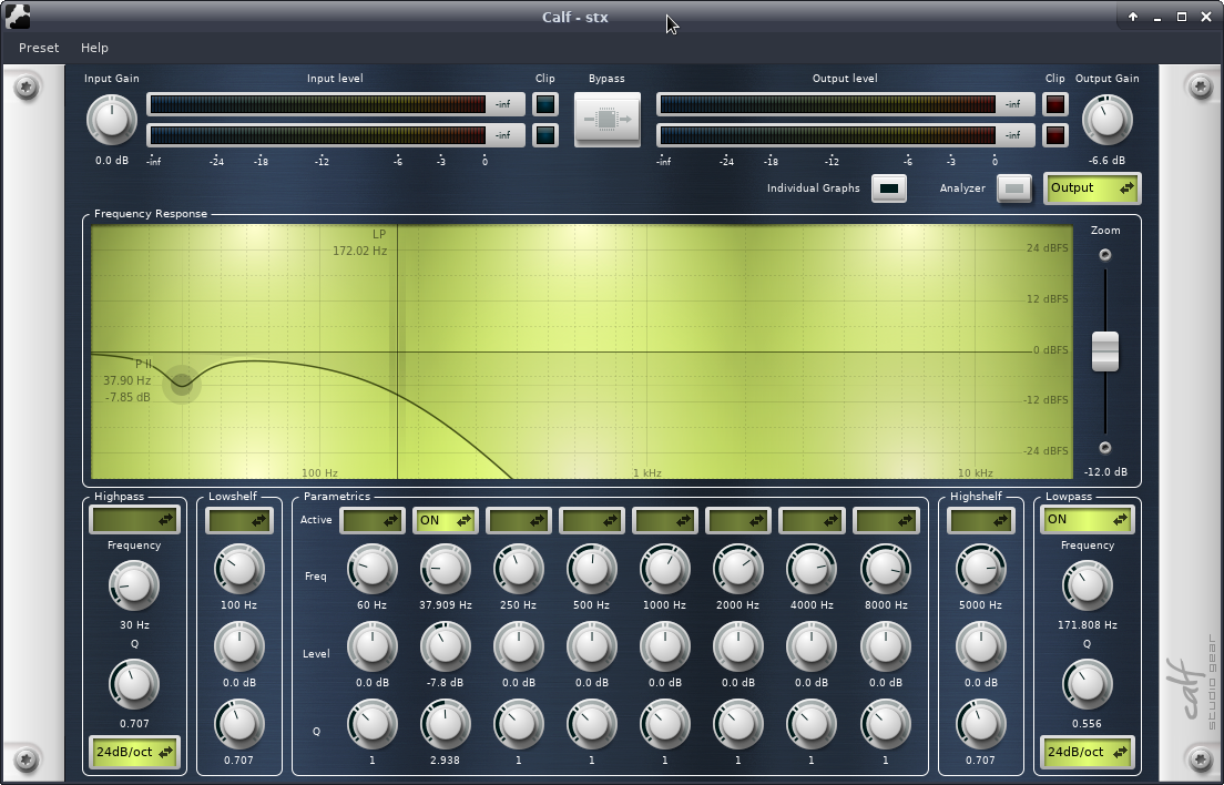

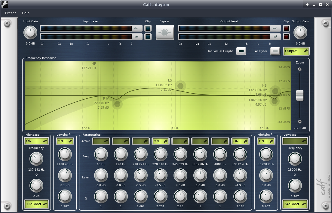

My latest project uses sealed STX 10" woofers that I had lying around, paired with Dayton 3.5" bullet full-rangers as mid-tweeters.
Although very capable on their own, the Daytons were struggling with the shelving bass-boost I had given them. How did I know they were struggling? I could hear the IMD when playing multiple low musical notes. Isolated single notes would only produce subtle harmonic distortion, but whenever 2 or more bass notes 'collided' they would produce a lot of additional 'grit' that wasn't present in either note individually. It didn't have to be a formal test — just jamming on the left side of middle C.
So I attached the woofers to the PC's soundcard, and used the software I had available to create some "quick and dirty" filters. Note the high-Q band-reject at 38Hz. Even though the woofers use sealed boxes and already sounded very 'clean' with a simple low-pass, I found that fixing a room resonance was a higher priority than from the get-go than the actual crossover frequency! I called it a room resonance, but actually room leverage would be more accurate. The speakers' (in)ability to cushion the vibrations that they were pushing out into the room was making them resonant. The cone movement may be superbly damped by a TAS5704EVM 20W class-D amplifier, but my ears were telling me that the air vibrations in the room were clearly not well damped. I tested this on my keyboard, and the lowest D~Eb (~38Hz) notes on the piano (when playing pure sine waves) were strongly boosted compared to the adjacent A-B-C and E-F-G notes.
Furthermore, I added 10 ohm series resistors as an experiment, and found that although the relative sensitivity increased at the resonance, it was a broader peak. It covered more notes and required a lower Q anti-resonance to correct it. By relying on my ears and 'tinkering', I was able to make a finding that was completely at odds with the common forum 'wisdom' that a high damping factor equates to tighter sound.
