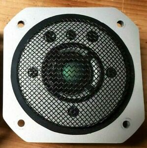

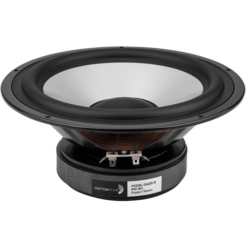

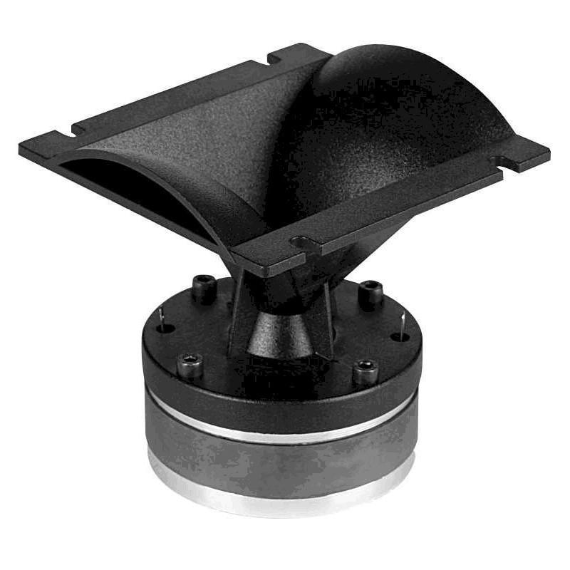

I think I understand what you are saying. Leaving aside the builder's skill in designing the crossovers, the careful cabinet construction (PE chamfering edges to avoid diffraction, so in fashion these days, but I fell sitting on my *** several times when I heard vintage cabinets with straight edges) and the importance of the room, what makes a cabinet sound coherent is the correct integration in the tonality of each of the transducers when they are crossed, if you want to use a horn compression tweeter, a beryllium dome midrange and an aluminum cone twoofer, there is hardly a homogeneous sound, because the crossovers could be very flat when designing the overlap frequencies according to the FR extension of each conductor, but the tonality and coloration generated by the different materials and technologies of each conductor will give a sound that is not homogeneous. An acoustic monstrosity, I would say. That's why RE speaker lovers aren't ditching their high-efficiency cabinets and SET tube amps. And they tend to be people who love good music and are used to listening to concerts.
