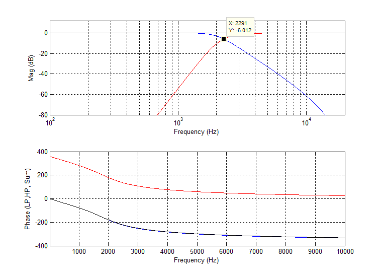

Got it, the delay is supposed to be an all-pass filter matching the LPF's phase, as opposed to a pure delay. This also renders the (summed) output phase non-linear, as shown below in black. Nevertheless, the high-pass section seems to roll off faster as promised, with the actual crossing happening at 2290Hz.Could you please specify the alignment delay for the subtractive HPF in Figure 9 ?

It's explained in the paper. Regardless of whether the LP filter is linear or minimum phase the required delay is the DC GD of the LP section. For a linear phase LP the DC GD is arbitrary. Remember, this is the delay of the filter, not delay associated with the impulase response for FIR processing. So the LP could, in theory, be zero phase with zero delay or 5 seconds delay. Doesn't matter. With Q = 0.707 the amplitude is that of a Butterworth filter, regardless of order and the HP section will roll off at twice the rate of the LP whent he LP is linear phase.
No, the LP section for Fig 9 is linear phase , pure time delay, to achieve a linear phase for HP + LP.
Ok, so I guess this technique is primarily aimed at FIR Butterworth filters. Sorry.Regardless of whether the LP filter is linear or minimum phase the required delay is the DC GD of the LP section ...... With Q = 0.707 the amplitude is that of a Butterworth filter, regardless of order and the HP section will roll off at twice the rate of the LP whent he LP is linear phase.....No, the LP section for Fig 9 is linear phase , pure time delay, to achieve a linear phase for HP + LP.
