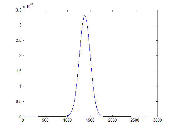

Thank you, I had a play with your wav file, converted it to use on my DSP with REW and Rephase. I think I missed where you said how you were generating them?@SubSoniks, for the time being you may obtain a Gaussian low-pass filter (77Hz) from the wav file in post #337, or the overall LP filter from post #350.
I generate it using the following function in MATLAB, and then write it to a *.wav file for sharing / compatibility. The overall filter impulse response is obtained in a similar way, but using the processed output instead of the initial Gaussian LPF.
https://in.mathworks.com/help/signal/ref/gausswin.html
The result looks like below. Note that X-axis is not time but sample count.

Code:
Fs = 48000;
x = gausswin(2763,11.49) % Normalised 77Hz Gaussian impulse response with 2763 points
x = x / max( fft(x) ); % Adjust scaling factor
wavwrite(x,Fs,32,'h:\desktop\Gauss.wav'); % Write to 32 bit, 48kHz mono wav file

@newvirus2008, it looks like you determined the parameters for gausswin() empirically, and that works. The analytical method is described in post #298, where the designer has to decide upon a threshold below which a coefficient value is "negligible". I usually use 2^(-24), though that value is entirely up to the designer and the circumstances.I generate it using the following function in MATLAB [...]
Code:Fs = 48000; x = gausswin(2763,11.49) % Normalised 77Hz Gaussian impulse response with 2763 points x = x / max( fft(x) ); % Adjust scaling factor wavwrite(x,Fs,32,'h:\desktop\Gauss.wav'); % Write to 32 bit, 48kHz mono wav file
No, that's not quite what I meant. A true Gaussian extends to infinity in both directions, and the values in the "tails" get smaller but never reach zero. The designer must decide where to truncate the Gaussian waveform on both sides. I more-or-less arbitrarily decided that 2^(-24) = 5.96E-8 is that threshold; any coefficient value less than 5.96E-8 is assumed to be zero. In a floating-point implementation, 2^(-24) is still represented with full precision.MATLAB uses 32-bit (float) by default, that's why. I guess reducing the bit depth to signed 24-bit would do what you say, wouldn't it ?
Depending upon circumstances, you might decide that 2^(-16) is an appropriate threshold, or something else. It may be that using 2^(-24) results in more coefficients than your processing power can handle. Or it may be that all of your samples are only 16 bits wide, so 2^(-24) is overkill. Etc.
Oh, a minor correction: Matlab assumes that everything is double-precision floating-point unless told to do otherwise.
OK, so that's not related to the 24 bits used in audio ?I more-or-less arbitrarily decided that 2^(-24) = 5.96E-8 is that threshold; any coefficient value less than 5.96E-8 is assumed to be zero.
OK, so you definitely mean float.In a floating-point implementation, 2^(-24) is still represented with full precision.
Yes, understood.Depending upon circumstances, you might decide that 2^(-16) is an appropriate threshold, or something else. It may be that using 2^(-24) results in more coefficients than your processing power can handle. Or it may be that all of your samples are only 16 bits wide, so 2^(-24) is overkill. Etc.
Yes, double on compiler, but wavwrite() is limited to 32 bits only, 64 gives an error.Oh, a minor correction: Matlab assumes that everything is double-precision floating-point unless told to do otherwise.
It looks like wavwrite() has been replaced by audiowrite(), which can handle doubles. https://www.mathworks.com/help/matlab/ref/audiowrite.html
It's only loosely related to that. My thinking was that, if a full-scale 24-bit audio sample hit the smallest Gaussian coefficient, it should just barely have an effect upon the output. It wasn't very scientific, but I needed a threshold and this seemed like a reasonable one.OK, so that's not related to the 24 bits used in audio ?
It is up to the designer to decide. Engineering is always about compromise.Well, looking at the 24-bit DR of 144dB, does one need to be that precise ?
