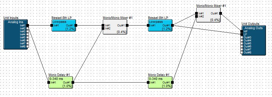

Hi Greg, i've been trying to build this version as a double check, and maybe 56Hz question solver, vs what I've built.For the people who are implementing the crossover described in the document attached to message #105, here is the schematic for the optimized version described on the final page of that document.
But I can't reconcile this version to the paper. it appears to me that this version has high and low outputs swapped vs the paper????

The paper says:it appears to me that this version has high and low outputs swapped vs the paper????
"It is actually easier to implement
h4'(t) = [2x(t-d)-x(t)*g]*g
first, and then derive
h4(t) = x(t-2d) - [2x(t-d)-x(t)*g]*g = x(t-2d) - h4'(t)
from it."
That's what is shown in the schematic, unless I made a mistake somewhere.

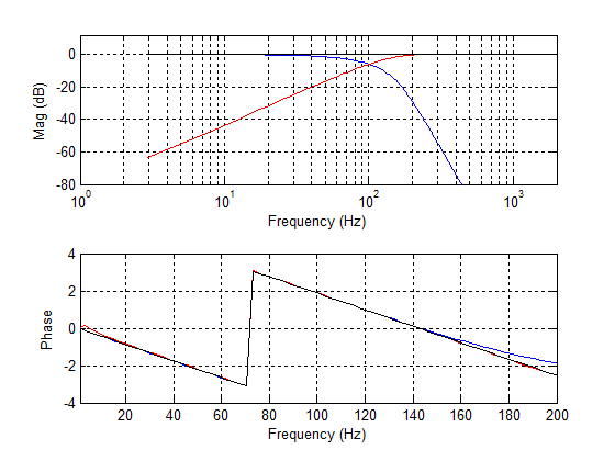

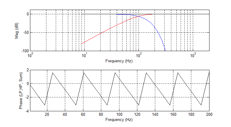

Here's the 8th Bessel based LPF & derived 2nd HPF that I get. While I'm clearly able to see how the phase alignment gets better with increasing order, my delay seems to happen at 337 samples, which is, once again, equivalent to the 7ms max delay of the Bessel. Please note that I'm simulating only one MDS (12B/octave).

What delay are you getting for the GB 4th? I'm getting a tad over 12ms, on a qsys test rig.
Oh, and with OSM, do you know how to delete all measurements at once? thx.
Re GB4, I'm getting 12ms but may need to do some more fine tuning.
I've never compared the two in any formal sense, but I guess it's not surprising.my delay seems to happen at 337 samples, which is, once again, equivalent to the 7ms max delay of the Bessel.

Yes, it's kind of intuitive, as the Bessel delay being largely flat, has almost the same value at DC (max value) and at the -6dB point (matching value at crossing).I've never compared the two in any formal sense, but I guess it's not surprising.

gberchin said:The lowpass filters used for LPF1 and LPF2 are typically, but not necessarily, Gaussian or Bessel.

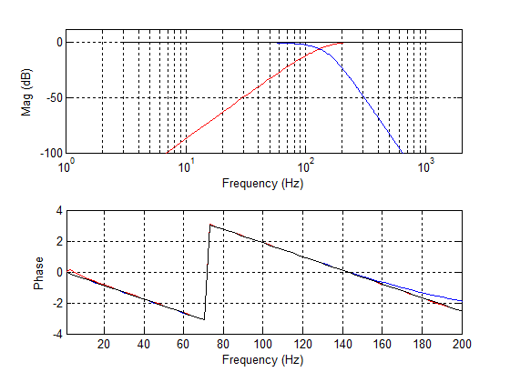

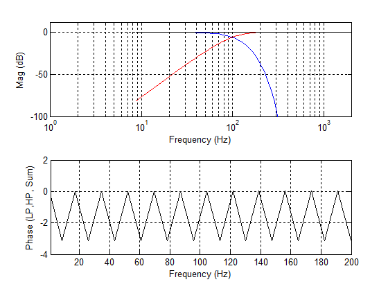

I think the Bessel is an excellent choice for not only its step response, but also the simplified delay alignment. My script now uses the max GD of the filter directly.
The Berchin 8x4 crossover also works as expected, but the crossing has risen from 100Hz to 129Hz, like @SubSoniks was having earlier. It now becomes obvious that scaling the LPF to 77Hz would bring the cutoff back to 100Hz, with an alignment delay of 9.0ms, as was seen in post #289.
Now, I guess the 8th Bessel could be replaced with a Gaussian filter replica to get the "more linear" phase characteristics, as originally intended.

I am following this topic with interest, since I own a Symetrix 8x8 DSP - which allows FIR only with 1024 tap max. With the provided schematic a few posts back, I think it is possible to implement the filter like this in Symetrix:
The gains and inversions are hidden in the mixer blocks. I need to try to download it and test if it works like it should. How difficult would it be to implement a full 3 or 4 way crossover for given frequencies? Or would it make better sense to use this for the lowest band only and then FIR above? The lowest crossover frequency in the 3/4 way would be somewhere around 150 - 250 Hz, the next higher one around 600 - 800 Hz and the third point at 3k6 if DCX464 would be used on the horn.
I think you might be able to manage a 250Hz Gaussian with 1024 taps. Here's a 1023-point Gaussian FIR for 100Hz if you want to try. I think the delay would then be 512 samples. But I suggest getting the Bessel to work first, as it makes things much easier.I am following this topic with interest, since I own a Symetrix 8x8 DSP - which allows FIR only with 1024 tap max....The lowest crossover frequency in the 3/4 way would be somewhere around 150 - 250 Hz.
