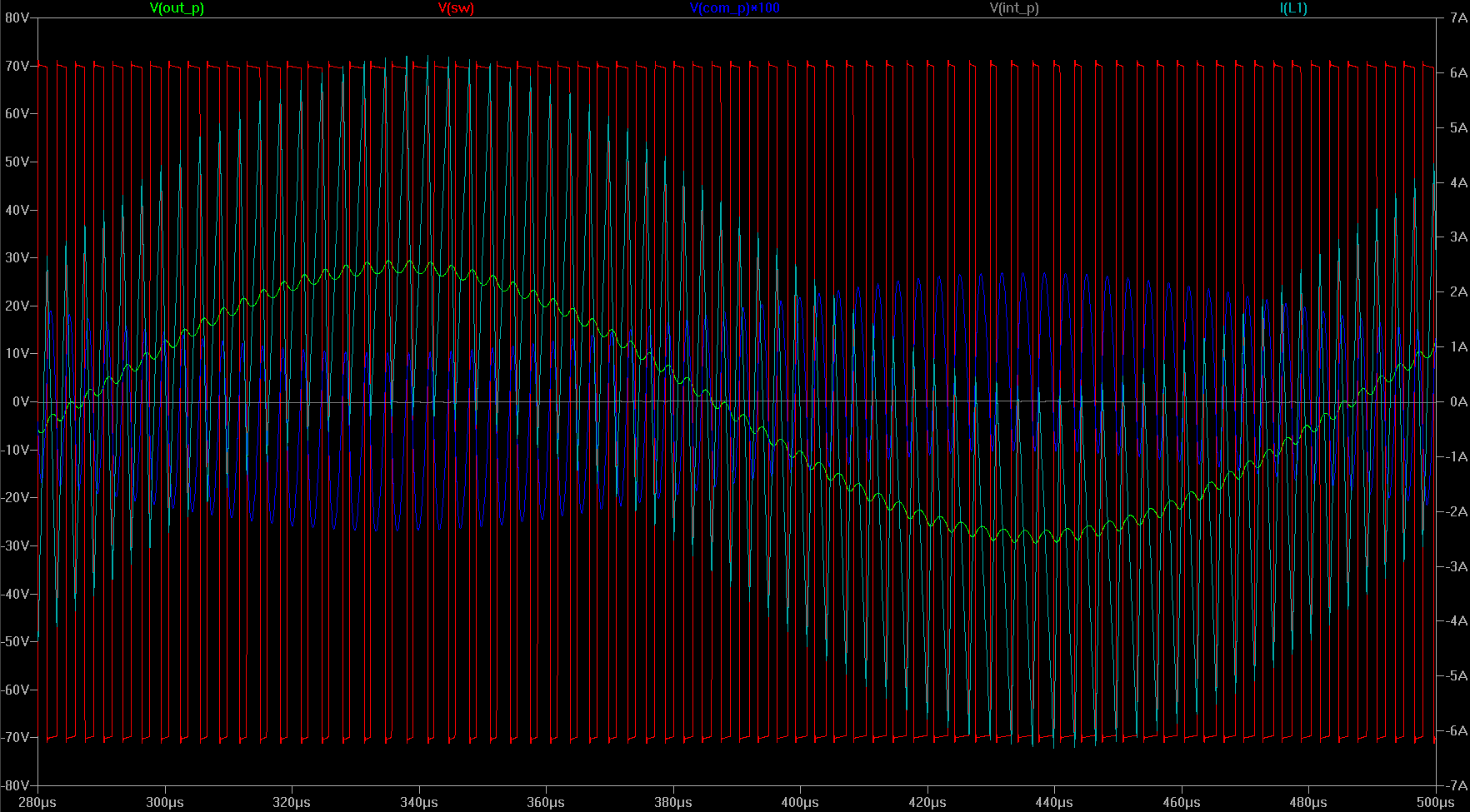

Here is a sim of the voltage and current measured at the output of an amp with voltage feedback applied. I used the woofer part of the Loudspeaker Equivalent Circuit from ESP to simulate a speaker driver like might be found in an active system.
