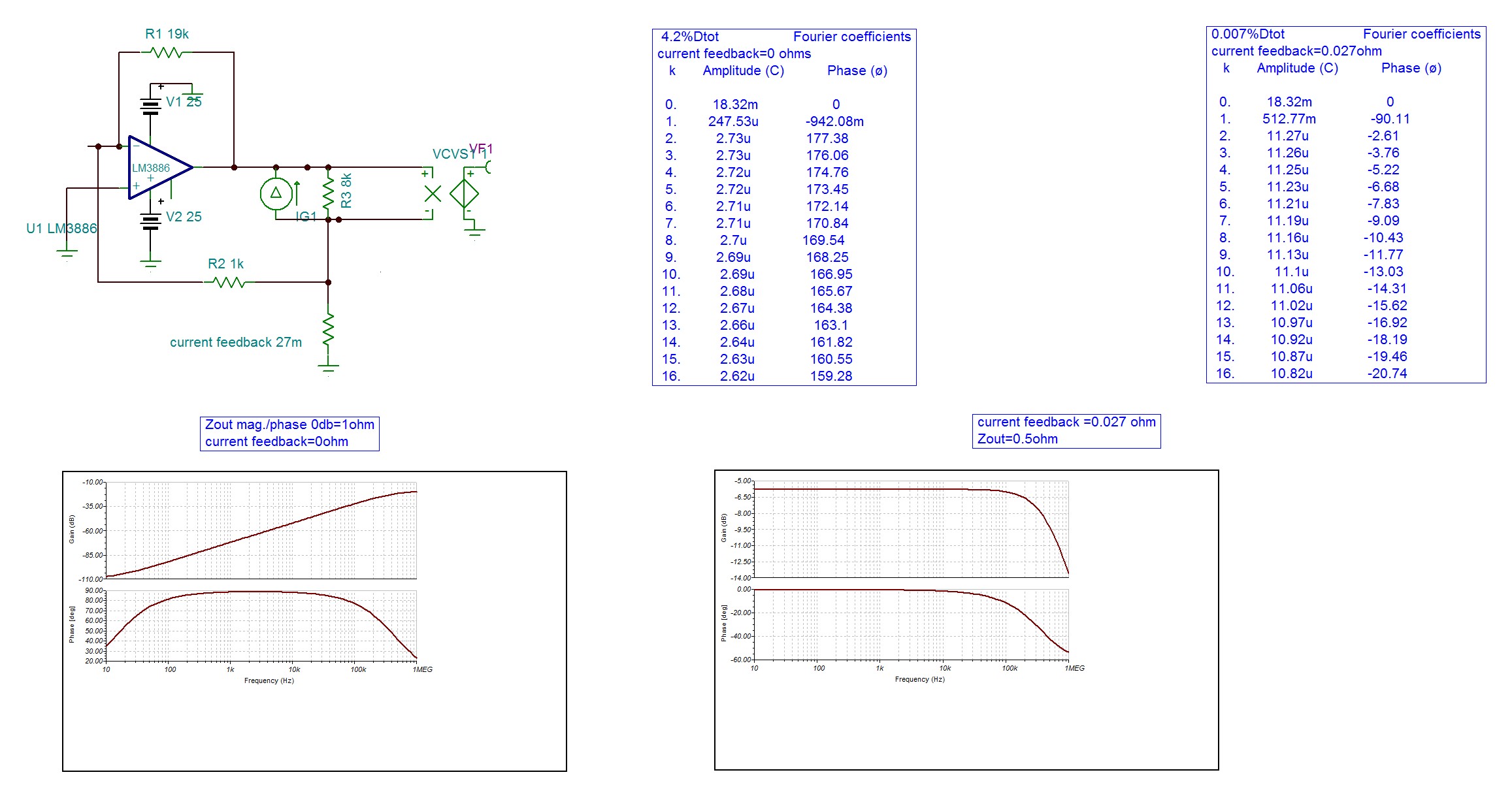

an exotic opinion
You may be served the specialty of a 3 star chef , by the chef himself , he will provide you also salt and pepper. The 2A3 SE amplifier-user enjoys 5% distortion at 2.5W . The Black Ortophone provides on its vertical mouvments, a generous 3.5% distortion to enjoy the innocent vinyl-lover. The low distorting AR3 did satisfy the most demanding ears of H. V. Karayan with only 2% distorted sound . A golden ear submariner cannot discern down to 0.1% distortion. Since Matusalem, Williamson is delivering with 20db NFB, 0.1% F-3 100khz.
An amplifier is a voltage source . It has a voltage generator and an internal impedance . A loudspeaker is a giant microphone with a series resistance . The resistance linearizes the currents both of the amplifier who's impedance is much lower and the speaker's ,while damping . Although the speaker is a voltage generator ,I don't know how ,somtimes it behaves as a current generator . The amplifier than answers the current by a voltage in accordance to its open loop tranconductance transfer function . The Williamson will provide not 0.1% but with 1% distortion with resistive component up to 10khz . If an amplifier lambda with identical performance but with 40db NFB had been used ,it would be 10% with 1khz.
