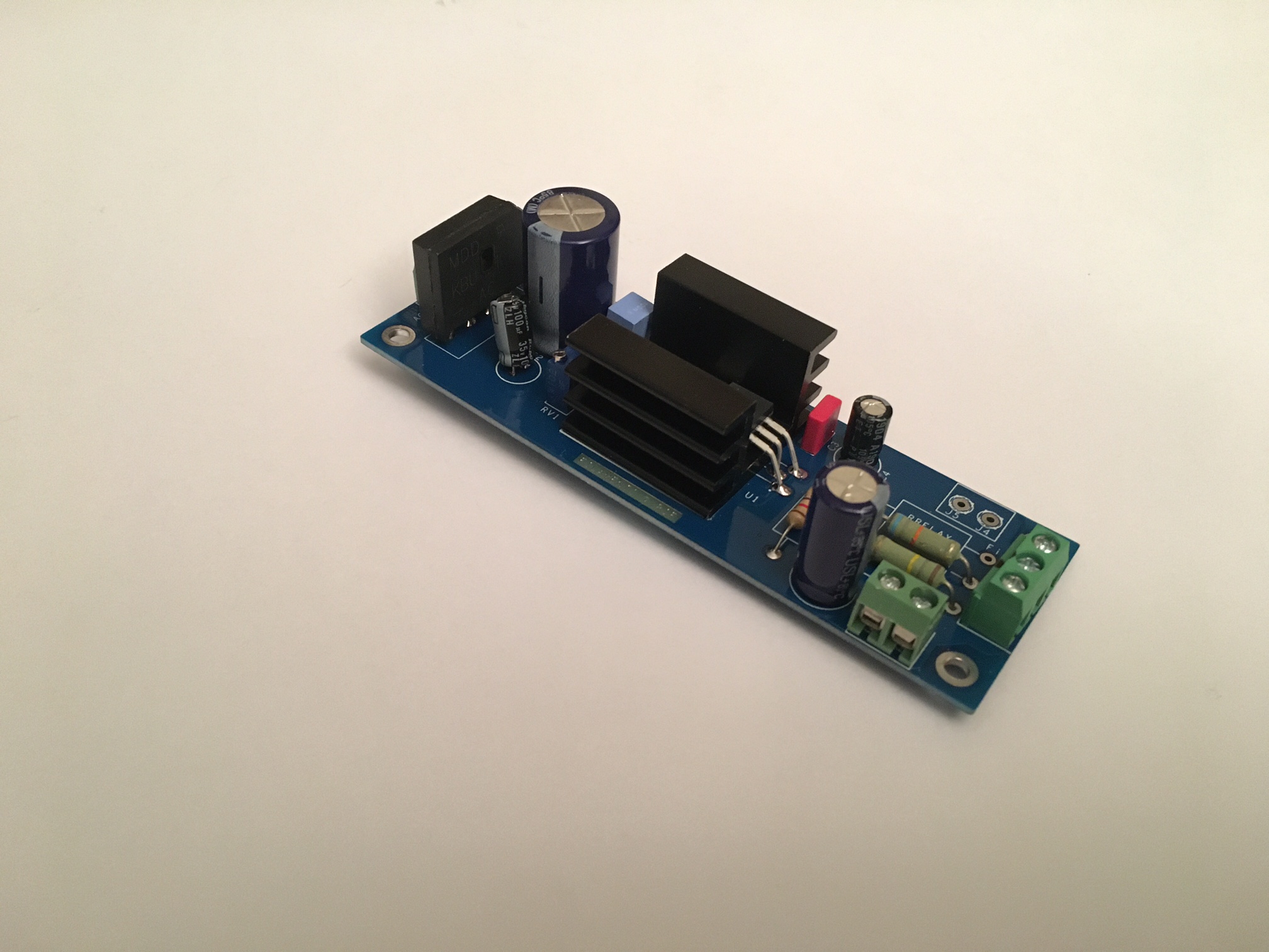

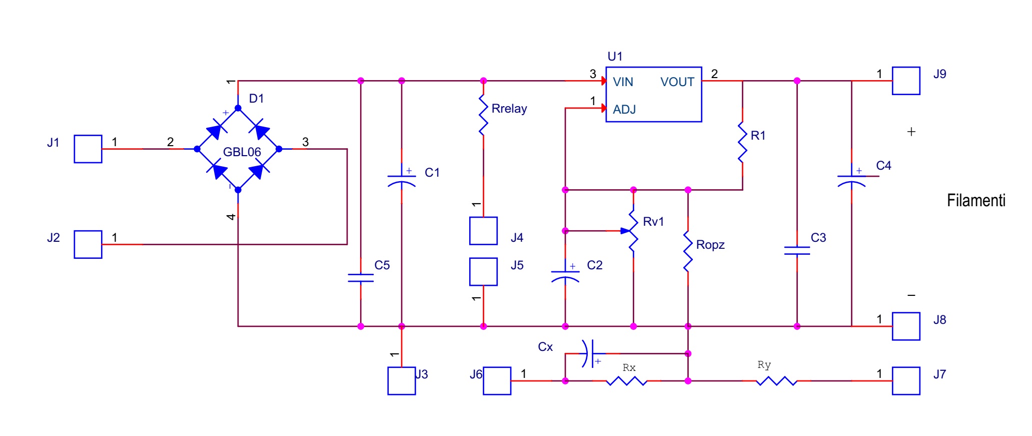

This is the pcb done by me that normally use without any type of problem, it contain also the little circuit for elevation with jumper to use , in case
The LM350 works fine; it is present also a trimmer to regulate the voltage
Walter
Walter
Nice! Putting the elevation circuit on the power supply board is something I hadn't even considered...
