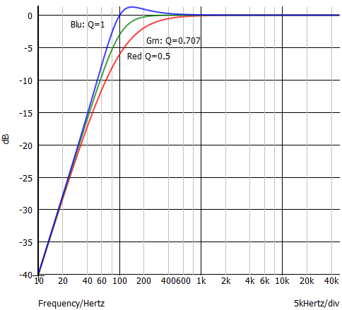

Hmmmm... I will continue to study your work, it is interesting.The matching of the acoustic sound pressure levels is an important consideration. It is complicated a little if we have a test signal with fundamental at the resonance frequency Fc, which in a Q=0.7071 closed-box system is −3dB at Fc, while for a Q=0.5 closed-box system, it is −6dB. That 3dB difference will play a significant role in the psychoacoustic perception of the two sets of responses. Add in some higher frequency content, say at 1.5Fc or 2.0Fc, and a listening test is fraught with difficulty.

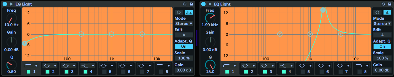

To try and alleviate this issue, one would need to EQ the signal at Fc by 3dB for the Q=0.50 closed-box system to make it at least somewhat psychoacoustically equivalent, otherwise one's perception will be swamped by the significantly reduced (50%) acoustic power being put forth by the Q=0.50 closed-box system, which can easily trick the listener into thinking that the bass is "tighter".

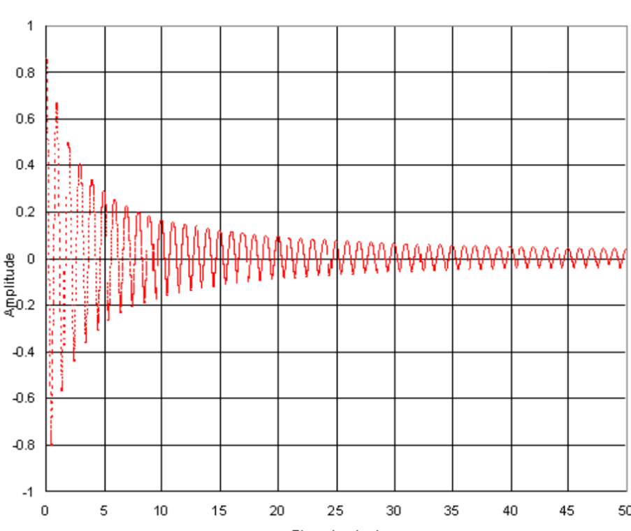

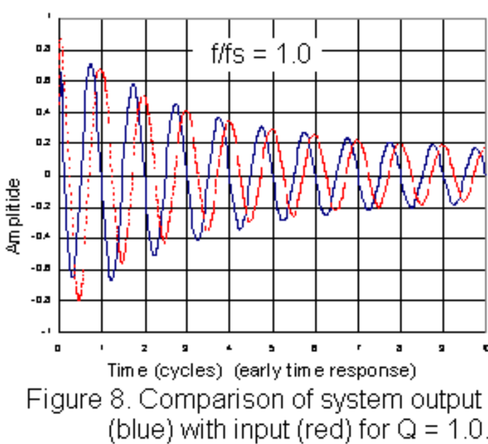

I would humbly suggest this. It seems the control is supposed to represent a bass pluck at 30hz? But is not an actual bass pluck? What is it then? It seems you want to see steady state performance so I'd guess its just a Sine wave at 30hz with the amplitude over time, adjusted to mimic something that might come out of a stand up bass. In your report you say that Q=1.0 is identical to the input, but that is untrue. Resonance brings group delay and I see the second oscillation in the test having higher amplitude than the first. Note worthy, as to what happens as Q increases.
It does appear to be a simple sine wave compare n contrast, input vs source. In my opinion, you are overcomplicating the issue of spl. All you need to do is match the start up transients of each test situation. You don't have to eq, to level match, you use gain. If you use a peak filter to change levels at Fc you just changed Q and group delay. The group delay present in the Q=1 sample throws a crook in the game spl matching. Time to max spl is not 0ms so matching the start up transient further skews things. It might be more productive to match spl of the sine waves much later in the signal.
The more I study your results the more obvious it is to me that Q=0.5 is more accurate and that the other samples are simply closer to input due to the alleviation of the attenuation caused by the high pass filtering allowing the signal to play closer to the amplitude shown in the input. 0.7 and 1.0 both have distortion in amplitude with the first 2 oscillations, group delay. Q0.7 second oscillation matches the amplitude of the first oscillation, and Q1.0 second oscillation is higher in amplitude than the first... everything else seems to be related to amplitude of input vs output, rather than accuracy.

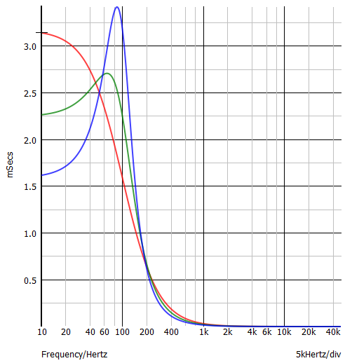

@Maxine01 Can you please outline why you might consider that the step response and group delay of a Q=0.5 system are better than that of a Q=0.7071 system? It's not entirely clear why that would be the case. Maybe you can provide some objective data to clarify the situation.[Other] As I said in my first post, I consider Q 0.5 ideal for almost all situations, due to its characteristics of better step response and group delay.
I did do something along those lines. However, it wasn't quite enough. The trick is to adjust the amplitude to ensure that the power contained in the two signals was more or less identical. As this condition was approached, any discernable audible differences between the two sets of response simply disappeared.All you need to do is match the start up transients of each test situation.
A gain change produces essentially the same result. The EQ approach was just another option that came to mind. It wasn't meant to be definitive in any way, shape or form.You don't have to eq, to level match, you use gain.

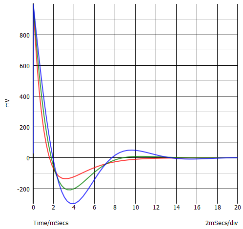

In this thread, a guy shows the frequency response, step response, and theoretical group delay for Q factors of 0.5, 0.707, and 1.0 of a second-order system:Você pode descrever por que pode considerar que a resposta ao degrau e o atraso do grupo de um sistema Q = 0,5 são melhores do que os de um sistema Q = 0,7071? Não está totalmente claro por que esse seria o caso.

The Q-factor can be compared to shock absorbers in a car.
Q=0.5 or less does not bounce back and forth after a step and higher Q increasingly does that.
The driver with high Q will constantly emit a wavelet of the resonance, additionally the response gets boomy, see the frequency plot.
Our ears are sensitive for this kind of thing, even 0.77 will sound a bit boomy and after some time listening fatigue will arise.
Q=1.414 certainly will sound crap, filters are needed, they can transform...

Theoretically, the change is small, but a Q factor of 0.5 to 0.7 is really a fine adjustment that can make a difference for some people, for others not so much.
It's too late where I live now, so tomorrow I'll try to better explain my opinion on this small Q-factor change.
The images are from his post.
These step responses and stuff is just plain nonsense and I will just continue to listen to things I like. No one could give me an indication of how speakers of different Q will sound. So I wasted my time on this thread, it is superficial and plain nonsense. Keep up the Q work and step responses guys. I will stick to electronics.

But this adds even more group delay.

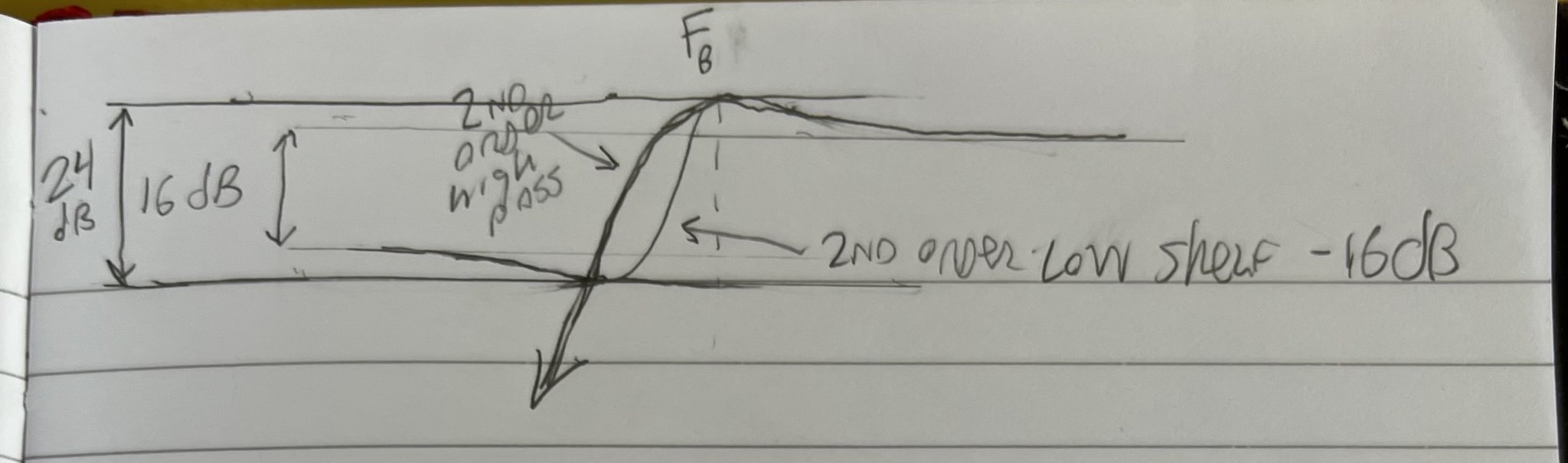

The Keele 6th order alignment uses a 2nd order electronic high pass which while helpful is not steep enough to minimize excursion immediately below Fb.
In the AX article I show a reflex tuned lower than normal so it has a soft knee, combined with a shelf filter with a Q of around 2. The combination is flat down to Fb and the shelf filter cuts the signal by about 20dB in 1/2 octave, then levels off. This reduces phase shift and the combination is quite elegant.
This is a crude sketch of the difference.

What's more important? Understanding the relationship between Filters and group delay, resonance, and decay.
TLDR = A smooth Frequency response is the highest priority.
Lets look at an undistorted FR
The FR changes, cause distortion. Regardless the Q, Regardless the Slope Order. The more gradual the changes are in FR, the less distortion
Just think a little. Qtc = 0.5 in a typical real-world scenario means a relatively high F3 (in an anechoic environment), which means that the frequency response is audibly distorted, so despite the clean impulse response, a critically damped 2nd-order system still does not provide the final fidelity as long as F3 doesn't go below 20Hz and the low frequency roll-off Q (including room gain etc.) is still 0.5..
