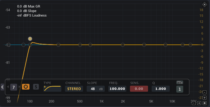

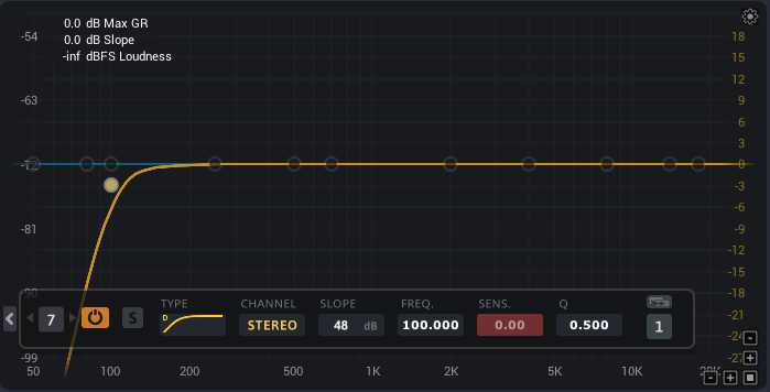

Played around with Octave a bit more, denormalized the transfer function and have this plot, for Q=0.5, Q=0.7 and for a B4, all with approximate resonance frequencies of 30Hz. The Step response functions now show a settling time in seconds. The Vented box basically has 30Hz ringing superimposed on the step, which is going to be inaudible. You might hear it if the tuning frequency were 80 Hz, but even that is iffy.
