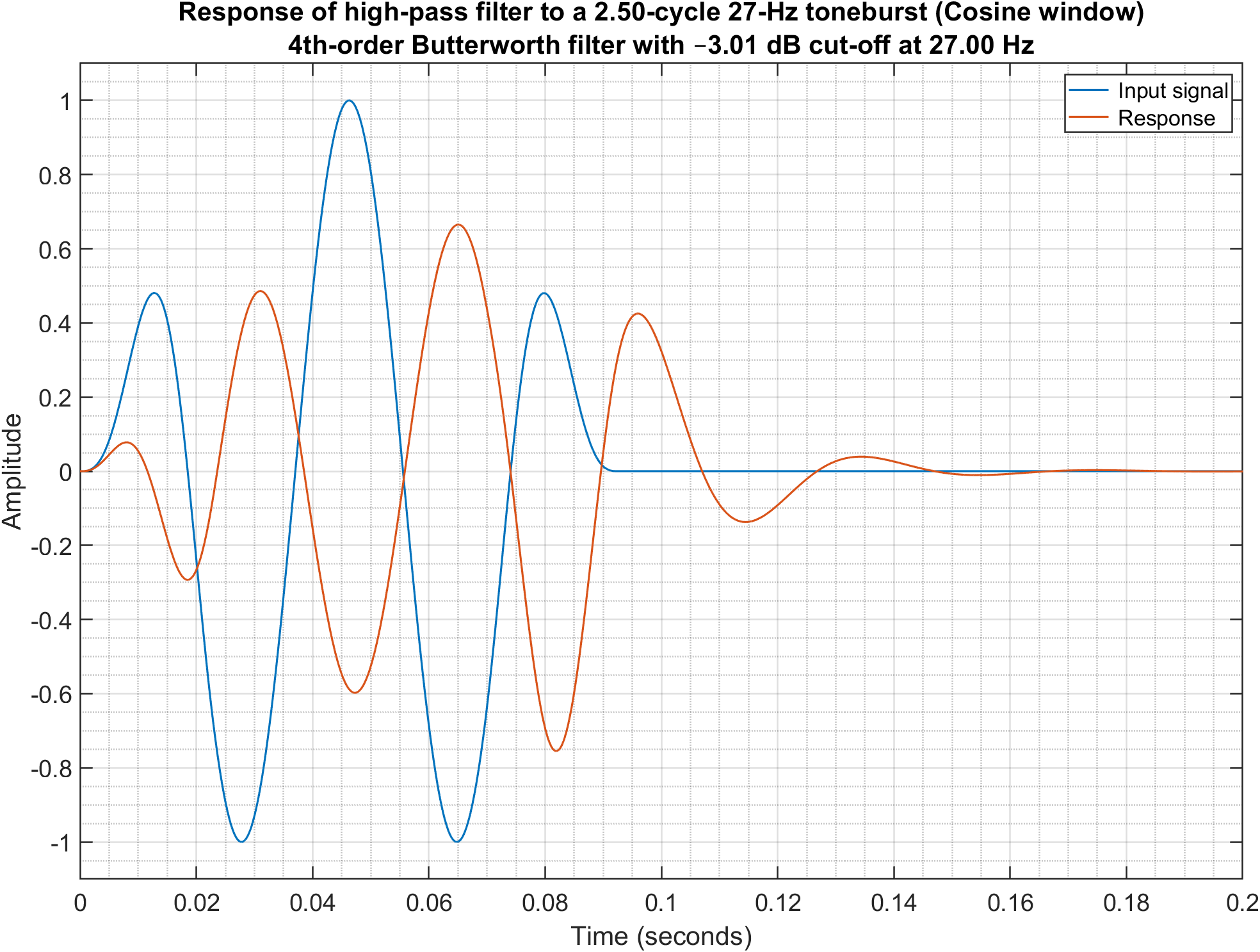

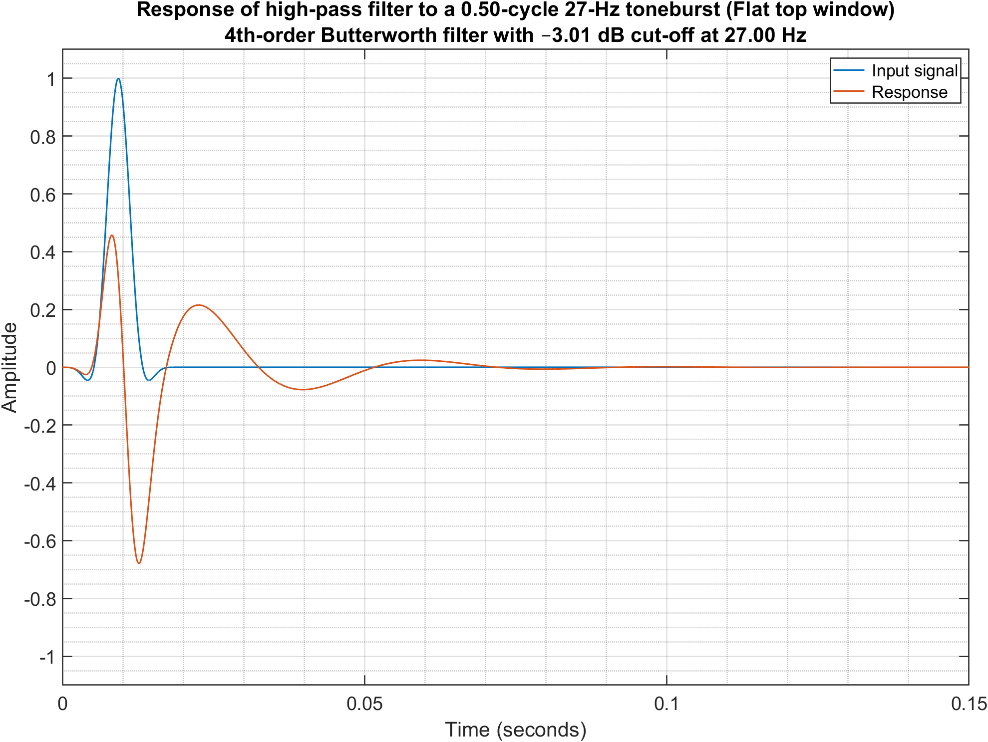

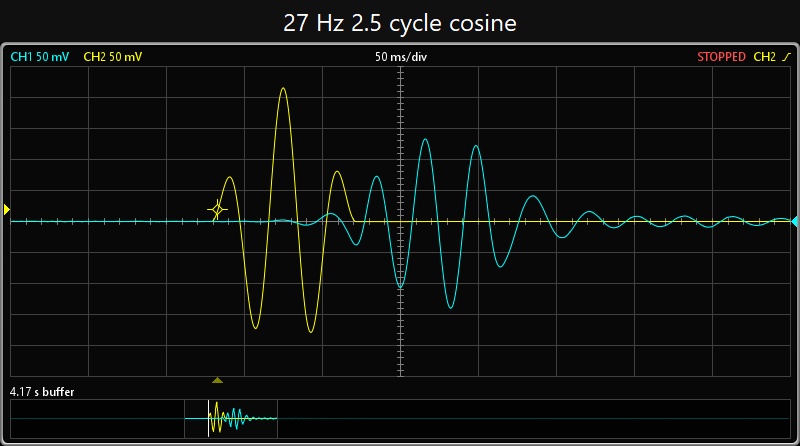

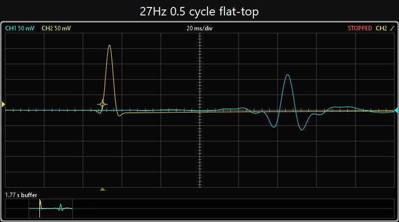

@mark100 Many thanks for going to all this effort to get a nice set of measurements.Ok, to recap, sub is dual 18" reflex with f-3 around 26-27Hz.
Below is the simulated response obtained when using a 4th-order Butterworth high-pass filter with an f3 of 27Hz. For the input signal, it is worth noting that the negative values on either side of the peak are due to the flat-top window that was applied.Here is 27Hz, 0.5 cycle flat-top window
Yellow is electrical stimulus;
Blue is microphone . (Delay is due to use of a FIR filter with about 90ms of latency.)
The results shown below are somewhat similar to your measured response. As my results appear to be polarity inverted relative to yours, is there a chance that your measurements were obtained using an inverting amplifier?
Below is a simulation of a cosine-windowed 2.5-cycle 27Hz toneburst filtered by a 4th-order Butterworth filter with f3 at 27Hz. The simulated transient response dies away more quickly than the measured one.Here is the same 27Hz, but 2.5 cycle and cosine windowing.
Notice the disparity in apparent number of cycles between the stimulus and measurement. About double, maybe 5 peaks vs 10-11.

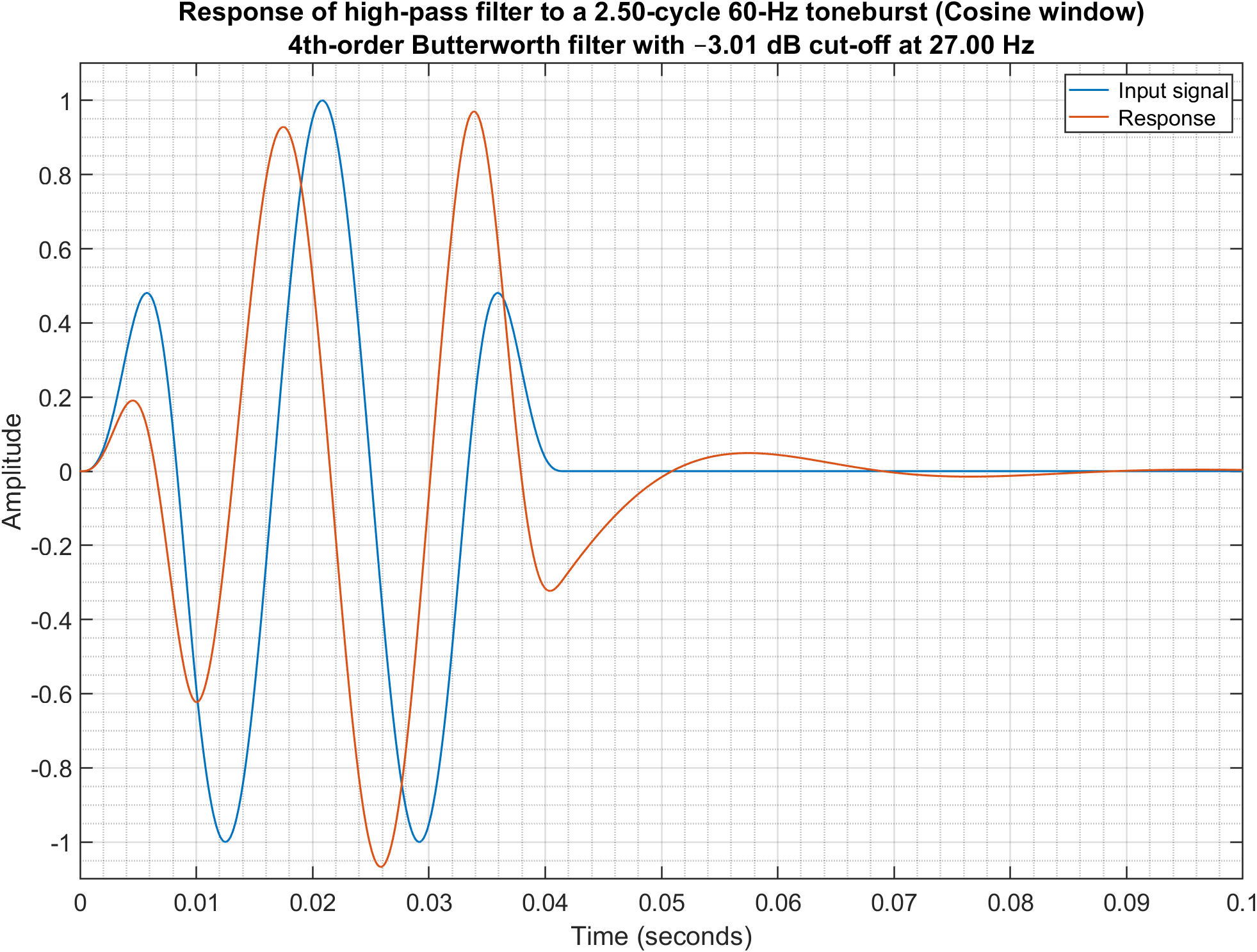

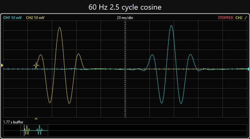

Below is the simulated response to a 2.50-cycle 60-Hz toneburst with a cosine window applied when passed through a 4th-order Butterworth high-pass filter with –3dB cut-off at 27Hz. This result seems to be quite different to the one that was measured during the experiments.To get out of port contribution range, and to illustrate how then, that the number of cycles disparity goes away,
Here's 60Hz 2.5 cycle cosine windowing. Good match I think.

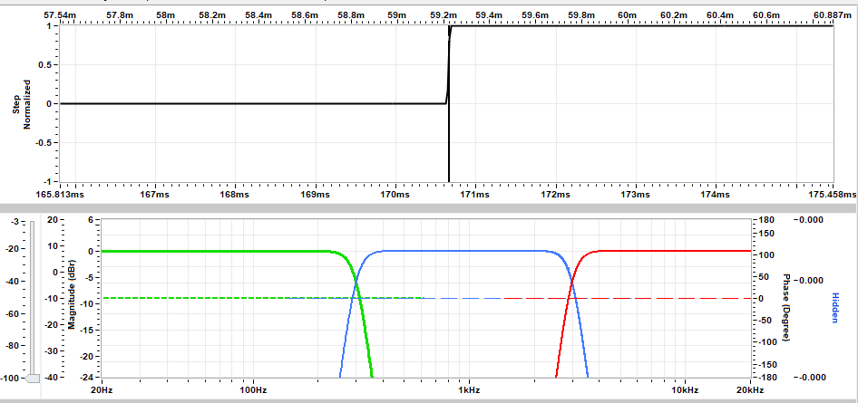

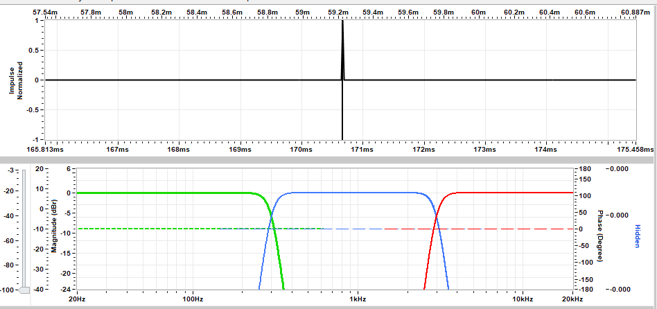

here's a myth buster example
An electrical 3-way using xovers at 300Hz and 3KHz. Xovers are 96dB/oct complementary linear-phase
First, the 3-way's impulse. Note that the summed sections' response is essentially a textbook perfect Dirac pulse.
Mag and phase traces are shown for each of the sections.
Nest, summed step response.
There's clearly zero pre-ring in either impulse or step.
The key to that is fully complementary coupling between sections. Which is of course easy in 1D electrical space. And obviously more difficult in 3D acoustic space.
