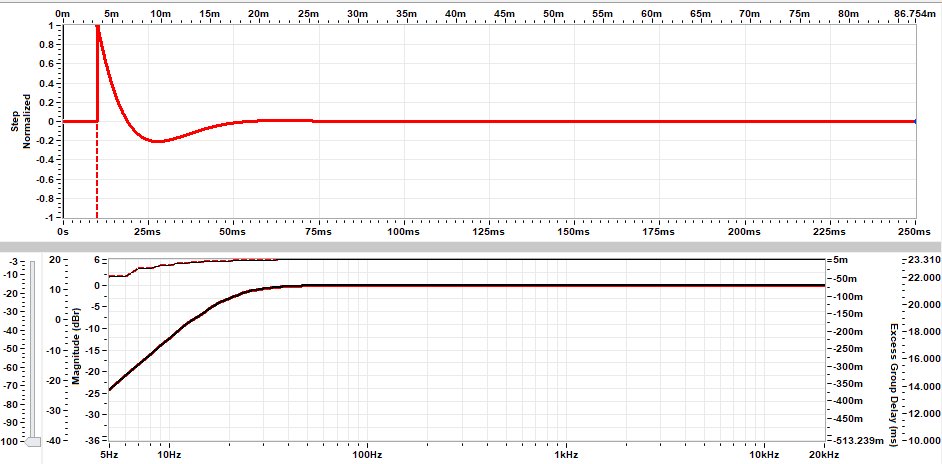

Here's step response of a BW 12 dB/oct at 20Hz, to simulated a sealed sub.
I'll let you call where step has fully settled. 15ms or less seems overly optimistic.
(Note the 10ms delayed started to move the pulse start off t=0 for visibility, that needs to be subtracted from the scale to judge settling)
Here's a BW 36 dB/oct, to simulate a 4th order ported along with a 2nd order hpf in place.
1/4 second seems quite pessimistic.
1/8 second is closer to the truth actually. But shockingly long when we only look at the bare number !1/4 second seems quite pessimistic.

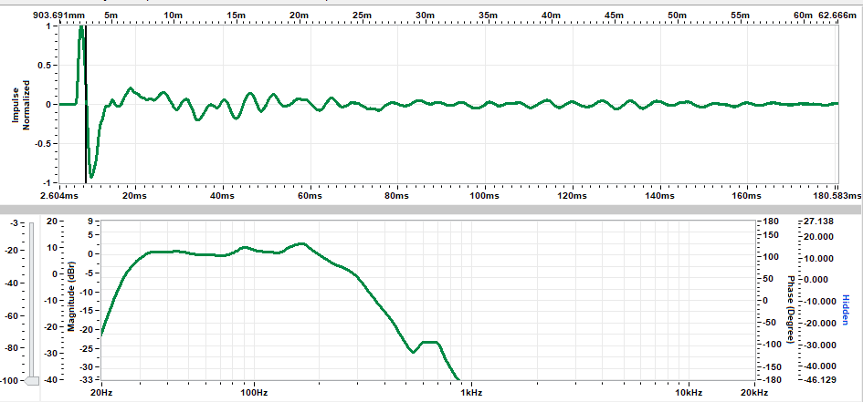

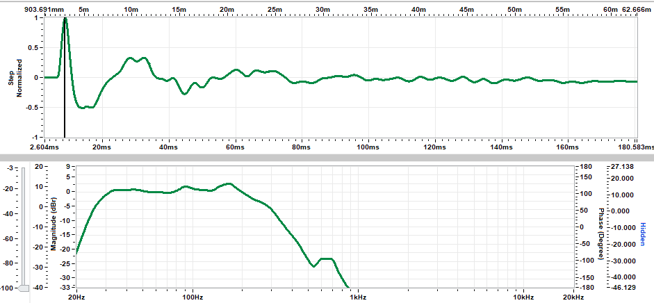

The only sub measurements that I have that are worthy of assessing step response, those made ground plane outdoors, were all transfer functions with Smaart which doesn't save an impulse response when taking transfers. So no, dammit.
Here's a just-made nasty indoor measurement of a sub currently in use, a large dual 18" reflex tuned to 25Hz.
Mic 4" from sub, in-between drivers and port, mic about 3 ft off ground. Like said, pretty nasty.
Impulse first, step second. Not sure how much / if anything, can be gleaned from indoors.
Step.
