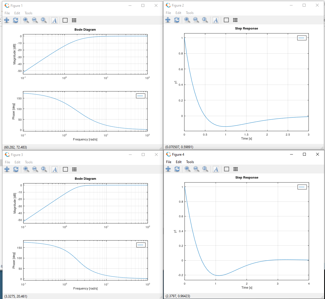

I disagree with that (@Ron E ’s link). Woofers don’t just reproduce sound at a steady state. Step response actually does matter.
Step response isn't wildly different between Qtc=0.5 and 0.7 All sealed step responses have some overshoot. Who cares if your box rings for a partial cycle at 30 Hz when your room rings for seconds at MULTIPLE frequencies, All these critically damped nuts are going after is an engineering goal or a goal that they have been told is optimmum and then convincing themselves that it sounds right. If you look at John k's presentation, you can see that lower Q boxes don't necessarily follow tonebursts better, so there is nothing there that is saying anything about steady state.
Below are bode plots and step response plots for 0.5 (top) and 0.7 (bottom) note different time scale on the 0.7 step response..
Step overshoot is 0.14 for the "critically damped" box, and 0.2 for the maximally flat box.

Your Q=0.5 version does definitely NOT overshoot but the 0.7 one does. Although not much. But in a room there is probably even a smaller difference between both.
Step overshoot below the 0 line is a feature of all of these 2nd order highpass pressure response functions. It even occurs for a Q of 0.1 You are talking about the rebound after the overshoot.
If you want to talk about why Q=0.5 gets its name, it has to do with another type of response function that doesn't correlate with anything we hear 😉 Can you guess what function that is?
I am not talking about that because it has to be always present since it is not possible to apply static pressure to a usual listening space by the use of a speaker. Also both areas below and above zero do have to be equal.
What I meant is happening at about 2.8 ms where the higher Q case crosses the zero line again while the one for the lower Q case nears the zero line asymptotically.
But as I said the difference is minumal.
I already addressed that in my comment #30 by talking about rebound. You didn't answer my question though. There is a response function for which the Q=0.5 speaker is critically damped. Few people are likely to know it.
I'm not sure why step response will matter so much. I fully recognize that it can be used as a means of assessing the low-frequency transient response of a dynamic system, but it is quite an unusual signal. For loudspeakers, which generally have zero response at DC, it seems to be a somewhat poor choice of test signal. Maybe because it's so easy to apply it has sometimes been used, but I doubt that it would appear in music all that often.
Would not a tone-burst provide more information? Or even a shaped pulse-like test signal at an appropriate test frequency?
Keep in mind that the measurement of the low-frequency response allows us to infer the behavior of the step response, so why even bother with using a step?
I am not so sure about the room effect. After all, there is a noticeable difference in the response function of these two systems. In the absence of the room, the system with Q=0.7071 will be −3dB at fc, its resonance frequency, but the one with Q=0.50 will be −6dB at fc.
If we input a half-sine pulse or a short tone-burst with main frequency equal to fc, then the Q=0.50 system will likely sound "tighter" because its bass output has been reduced by 3dB. That will be the dominant effect. If we amplify the output of the Q=0.50 system by 3dB (i.e., turn up the gain), then it will be very difficult to discern any difference between the Q=0.50 and the Q=0.7071 system.
Would you be able to create a simulation of a 1/2-cycle sine-wave pulse whose frequency is placed at the resonance frequency of the high-pass filter? The results might be insightful.
