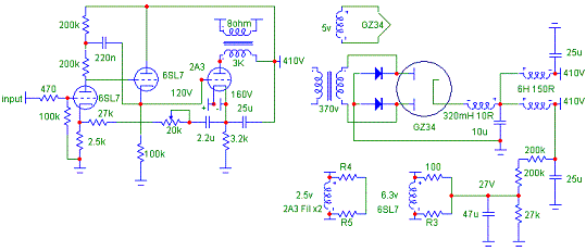

I'm wondering how this circuit manages to pass a 75Vpp signal to the 2A3. I mean, the CF has circa 3 volt bias... is its grid driven positive?

As the current changes through the cathode follower with the signal, it's cathode rises and falls due to the voltage drop across the resistance in the cathode circuit This allows the follower to move its cathode voltage over a wide range whilst still keeping the cathode more positive than the grid.
But the 2A3 is typically operated over a range of 45Vp to 50pp not 75Vp. You'll see that the grid-cathode voltage of the 2A3 is the difference between 120V and 160V, so only 40V and if you try to swing the grid more than 40V positive it will clip the signal due to the 6SL7 being unable to provide very much grid current to the 2A3.

If my math is not too rusty an output power of 4,5W equals 6,0 Vrms into a 8 ohm resistor. The 8:2500 transformer has 1:17,67 turns ratio, so our 6,0 Vrms comes from at least 106Vrms on the primary. That equals 296,8Vpp coming from our 4,2 times amplifying triode, which would take 296,8/4,2= 70,7Vpp on its grid.
Or ~ 35Vpk which is consistent with what Bigun noted in the previous post..
(My comment: 150Vpk on the primary of the output transformer, mu assumed 4.2 gives 35.7Vpk on the grid, with losses likely more like 40Vpk)

OK, after sorting out the misunderstanding about peak-peak and peak back to the circuit.
The CF has its cathode riding on the audio signal. That same audio signal is applied to the CF grid, but now at half the voltage. As a result the CF stage has no longer unity gain but amplifies while output impedance is still low. Is that correct?
