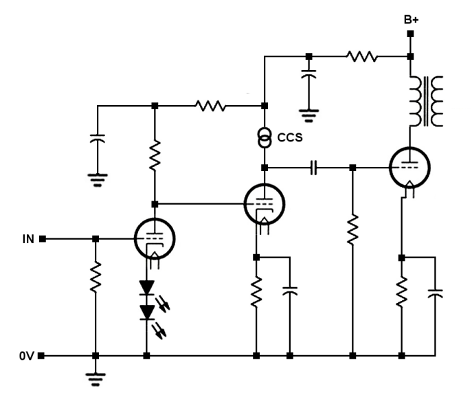

Something along these lines...
One could also rearrange it to DC-couple between the driver stage and output.
Glad I asked. That's a two stage input/driver, consisting of grounded cathode amplifiers in series. It's different in several ways from the amp I suggested:
One input voltage gain stage/ two voltage gain stages.
Non-inverting/ inverting.
Un-bypassed/bypassed cathodes.
PS noise canceling/conventional.
Direct coupled/ cap coupled (or cap placed after input tube).
0.9V sensitivity/0.3V sensitivity
In other words, a completely different amp. Better or worse sound or measurements? Depends on taste and operating points.
