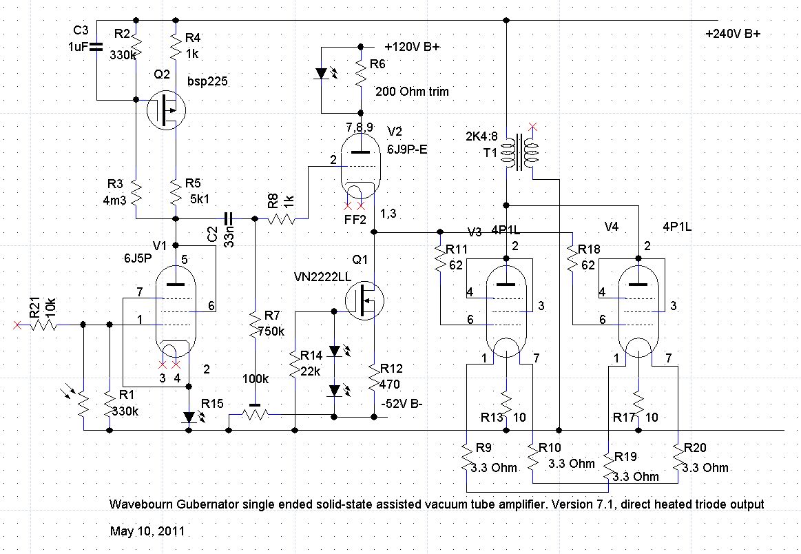

Just a question about the tube types used... Is that 6J9P-E a small signal pentode wired as a triode? The Russian 6J9P I know of is a pentode similar to a 6688. Is that the cathode follower in your circuit , or is that different tube?
The Cyrillic-to-Latin conversion of letters and numbers can really get confusing.
Thanks.
Yes, it was triode strapped pentode. Before that I used paralleled sections of 6N16B, and did not redraw it properly.

Forget the coupling cap, the circuit I referenced at the start doesn't use one. It's direct coupled.
In such case I have no idea what you like in sound of low current driver stage, except may be rolled off highs.

The mentioned direct-coupled amp is similar to the below circuit. I tried something like that before and it sounded fine and I think the direct coupling approach beef up the wimpy driver a bit due to not having to drive a cap, input resistor, etc.... So it's not that wimpy after all. While I like the transparency and fast transient of direct coupling, it lacks tonal richness. I will fully admit that I prefer sound with richness in tone and color. Yes, I prefer coloration over "neutral" amp. Now, that does not mean I don't believe in measurement or technical merit. I just like to learn and use whatever technical means to get to a certain sound that I like. I have no interest in achieving the ascetic ideal of "straight wire with gain," I'll let the masochists to deal with that. Yes, wimpy drivers can work surprisingly well. One example is the Pilot SA-232 6BQ5 PP amp. My jaws were drop when I heard it. After that experience, I can no longer laugh at any amp's perceived wimpiness. Deng Xiaoping once said "Whether a cat is black or white makes no difference. As long as it catches mice, it is a good cat." Amps are like that to me.
