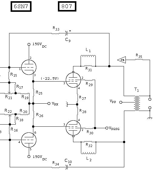

The only reason I don't like ultralinear is that once the OPT is wound, the die is cast. You take what they gave you. OTOH, parallel local feedback does the exact same thing, but it's tweakable so that it's NBD to determine what amount of local feedback works best. Don't like the initial results? Simply change one resistor and wash, rinse, repeat.
Parallel local feedback also works best with VTs where G2 requirements are significantly lower than the Vpk requirement (807s, 6L6s, most TV horizontal deflection PAs).
Other than that, it's just two different ways to accomplish the same thing.

What do you mean by parallel local feedback.
In the 6V6 Ultralinear I've just finished I use Ultralinear connection plus balanced shunt feedback from the output tube anodes back to the diffamp front end (Baby Huey scheme with source follower MOSFETs in between diffamp outputs and output tube inputs).
Very similar to this one I posted yonks ago (post #58) except higher shunt feedback (27K in lieu of 13K shunt feedback set resistor) and some additional supplies so I could use my favourite little E-Line Mosfet - a 600mW Zetex ZVN0545A

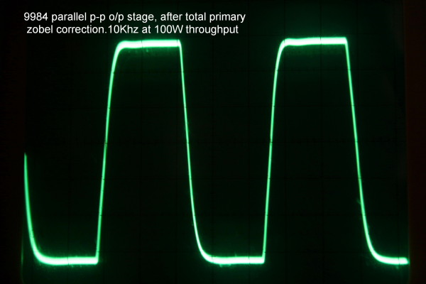

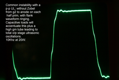

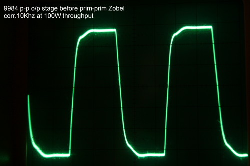

Below is a common waveform problem of many typ UL o/p stages, poor square wave slewing caused by high interwinding capacitances. In this case, a high power 150W wide b/w has large core (10kg) so gets a large area copper exposure. Leakage inductance isn't a problem and maker claims self resonance around 60Khz. The problem gets worse with high drive at high frequencies and leads to waveform ripple. The cure is a Zobel across whole primary, but other parts with compensation i.e front end phase and cap fitted in global nfb line can also effect.

the 2nd photo is after correction.
Not every UL amp will require correction but in this case as the transformer has a 14 section design only a light Zobel compenation was required 500pF and 3K resistor. At full sine or square wave drive (rare in music) considerable power is dissipated and components rated accordingly. I used polypropl cap and metal film resistors.
G2 to anode snubber deficiency wil cause ringing on each waveform half.
richj

gingertube said:
Miles,
See attached.

Miles # That particular distorted UL waveform was within 2dB from rated power headroom in an output stage behaving goodenough class A i.e Iq 95mA quies was 105mA at 20W o/p(mere 10mA increase). Thd at 20W 1Khz was 0.03% very good.. but at 10Khz = 1%(!!) and there was the problem. Increasing primary current to 110mA per tube reduced thd to 0.5% is a cheap solution but wasteful.
The problem was an o/p tranny with high leakage capacitance, i.e somewhat oversized for the amplifier design. The result is an extended LF response bonus to single figures, I measured thd at 20Hz at around 0.3% confirming high prim inductance combined with an overkill of iron -> to reduce copper area which still cripples the HF response. So there is an equilibrium where oversize can ruin other parameters.
what I'm implying is there's no point using an expensive 18 sectioned o/p tranny where low power is used. Case of going over the books to see the tradeoff between core area, leakage inductance and capacitive losses. No easy task and law of diminishing returns prevails. So there are unskilled manufacturers still around.
I personally like to use o/p tranny size in a circuit where LF cutoff -3dB is around 20Hz giving 1% thd which is around the old industry standard and most designers work to this.
> The result of Zobel trimming is the Penalty for stability by reducing the upper b/w to -3dB at 30Khz not really acceptable for digital reprod but the circuit now accepts the electrostatic loudspeaker whereas before it didn't.

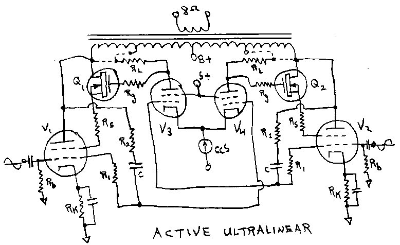

How to Fix UltraLinear:
Active Ultralinear design attached:
Half of the CCS current, times RL, determines the V DC drop on the screens from the plates for the main tubes V1 and V2. Can play with the connection of RL to the xfmr UL tap, instead of to the plate tap, to get correct bootstrap voltage across it. It will then act as an effective CCS load for V3 or V4 and give very high gain to the correction loop from V3 and V4 LTP. Ratio of R2 to R1 sets expected gain or Mu for the output tubes. When the output tubes are operating correctly at this Mu gain, the grids of V3 and V4 are stationary. Any deviation from this Mu rule upsets the V3 and V4 grids and gets corrected by LTP V3 & V4 varying the main tube screen voltages thru the Mosfet buffers.
