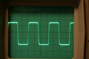

Strapping pentodes as triodes is one of my favourites. Despite mixed commentaries regarding UL, I've found tampering with the R/C screen snubbers makes a large difference in sound quality. Skill is required as g2 snubbers is part of the NFB network and can effect overshoot originating elsewhere in circuitry. I.M.O the 10Khz square wave test at half power into a dummy load is ** tough and highly revealing and all the triode amps I've sampled can't create decent waveform without massive slewing.
The AB2 amp I botched up from clear 6550B's is indictative how excellent the UL class is. Beat this waveform ??

Unbelievable!!!
Can you draw your trick with resistors/capacitors?

Wavebourne# As you know going into AB2 with a conventional p-p UL setup carries a severe overcurrent penalty, in my case Iq = 60mA and full load (which is somewhat unreal) can hedge 200mA per tube and drastically limit tube life. (Although is tempting Don't do cont sine wave on this!) My safe hedge is to limit B+ in my amp to 350V and this provides roughly 35W from a pair of glass button gettered 6550B's. (Be honest ...I would have never expect such craving performance from such boring plain looking tubes). ??
The trick... since I use ECL82 pents (as triodes) Lowish'' Z phasesplitter drivers and used the surplus ECL82 triodes signal section as diodes which behave soft. The caveat is to run the o/p tubes with an over impedanced primary 4.5KA_A. (43% taps). For the 6550 stats this would appear to break the rule books regarding power throughput and forcing a 5Khz sinewave through the block gave an overload waveform too ugly i.e it was creating foldback rectification voltage limiting by upsetting the real DC component of g1. SO I did the old AB2 guitar amp trick of strapping the ""tube diode"" from g1 to fixed bias neg via resistor. (cathode to signal) This forces the o/p tubes to respond and care must chosen with series resistor value to actual power throughput.
The initial problem was high THD at 10Khz. The output stage impedance reflection match was wrong ( I knew it was) so I tried AB2 forcing and it worked and reduced thd by more than half. A masssive improvement. It can only work if the power supply can hold up such enormous signal transients and not voltage droop. Bear-in-mind AB2 condition is really intermittant i.e music and speech, and doing sine wave tests can also Jarr up the output tranny ! Fit a fuse !!
To the crux.The g2- anode snubber R/C value is critical for optimal waveform squarewave ripple BUT the Global NFB (my case 20dB)also throws the towel in as well as the phase compensation in the first stage in a 4 stage amp. This is the surprise jewel....A good amp design of nom 20dB global NFB should be able to take an extra 15dB NFB before instability sets in. I found improved transient reproduction with correct g2 to anode RC components, in my case with a good quality o/p tranny with low leakage L , I arrived at the values of 1K5 and 330pF (silvered mica). This was a vast improvement to the recommended 1nF/1K which created considerable overshoot. The low freq end, using a 100W p-p o/p tranny on 35W should enable a single frequency figure power throughput. In my case 7Hz. This is too low so I reduced phasesplitter coupling cap values to create 1% thd at 10Hz. This created enough loop gain (15dB) at 25Hz to effectively dampen the LS. Got the Jist ?? With single shot LF square wave YOu might find the amplifer transient response also coincides with optimum Q. Yes.

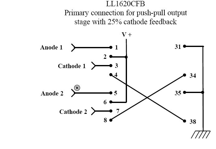

Wavebourn said:
What ratio is optimal for cathode windings?
LUNDAHL uses 25% in its LL1620CFB model.
