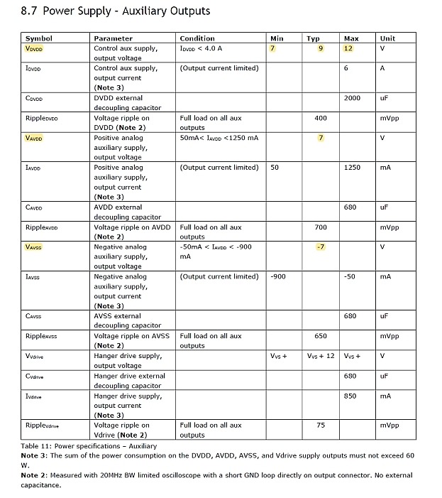

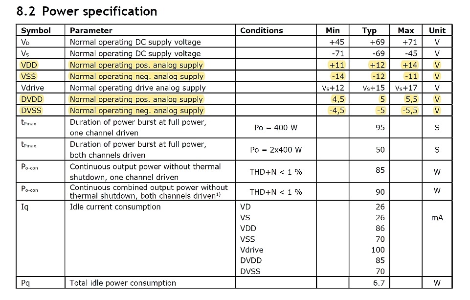

The auxiliary supply voltage is an interesting question.
As you note AVDD/AVSS are +/- 7 V from the 1500S, if you look at the 400A2 datasheet the acceptable voltage range for VDD/VSS is +/- 7 to 17 V however the normal operating range for VDD/VSS is shown as +/- 11 to 14 V (12 V nominal). My current assumption is that AVDD/AVSS from the 1500S are meant for VDD/VSS but it seems odd that the +/- 7 V is on the very low end of the acceptable operating range.
Using +/- 7V from AVDD/AVSS to DVDD/DVSS also doesn't make much sense as the acceptable voltage range shown on the 400A2 datasheet is +/- 4.5 to 5.5 V.
I plan on buying a 1500S when they come back in stock for a 300A2 build. My current plan was to try AVDD/AVSS to VDD/VSS and if that did not work regulate AVDD/AVSS down to +/- 5 V and use that to DVDD/DVSS.
Definitely curious to hear about how your build goes and how what you end up doing with AVDD/AVSS. I also sent an e-mail directly to IcePower with this question but received no response.

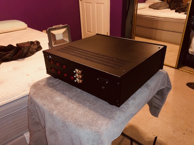

Love the build! That chassis is f'ing pro level. The perforated base plate is tight. Is that a sub-floor? IT appears you're running three stereo pairs and one BTL mono? Did you sell your fitted sheets, comforter and bed frame so you could pick up that fine Italian coachwork? LOL! Sorry, I couldn't help myself.

Thanks man.So are you drilling the rear panel free hand? What type of punch are you using? Agreed, drilling the holes, properly spaced on metal is always nerve wracking. I've only done so on twenty dollar bargain aluminum chassis to date... Now on that beautiful Italian chassis?!?! No pressure!
What I did was to start with I covered both sides of the piece with clear packing tape that you use for taping up moving boxes then I marked placements and set up a fence on the drill press so that all of my holes would line up. Then I start with a smaller bit first then move up to the size I needed to finish with. Then I burnish the edges. The hardest hole to make was the square one for the USB port in the upper left corner. I had to use a file on that one. The back plate already had the hole for the power cord punched out so that was one less hole to deal with. Ultimately a hydraulic punch would be a much better way of making the holes but I don't have one of those and wouldn't use it enough to justify buying one so I made due with the drill press that I do have. Drilling the large 7/8" hole through the 10mm aluminum front plate for the power switch was a bit sketch but it came out good. Aluminum is a lot easier to work with then steal in my opinion. I had to fabricate a shield and riser to mount the DSP in the box and did that out of aluminum. Hear is a pic with all of the wiring pretty much done.

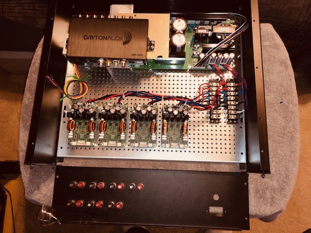

I still have to wire the power for the DSP and there are a couple of LED's that I am going to hook up but I'm waiting on some resistors to be delivered. They should be here tomorrow. I'm thinking that I might make a PSB for the power delivery that I can mount down the middle of the chassis to eliminate all of those wires and the bus bars. I think it would make the install a whole lot tidier with out all of those power wires bundled up and running through there.
At first it was making a little bit of noise and I was thinking that I was going to need more shielding but then I realized my WiFi antenna was like a foot away from the open box and when I moved it and put the lid on the box it went away so It looks like I probably won't need any but I might put some aluminum dividers between the modules to isolate the toroidal chokes anyways. I don't know yet we will see.
Right now I have to get power to the DSP unit. It needs between 12 and 16 volts to operate and I don't want to run a separate cord into the box using the wall wart that came with it. I have to check the voltages on the auxiliary power supply and see what the voltages are. The documentation has conflicting data so I need to break out the volt meter and check it for my self. It might only have 9 volts available. In that case I will need to buck it up to 12. Also I'm thinking I'm probably going to use two of the modules in bridged BTL mode to power the woofers with. Which reminds me I was going to start a build thread for the speakers that I'm in the process of building right now. I should probably do that soon.
But thanks for the kind words. I've never built one of these things before and was feeling a bit intimidated for minute but I never let that stop me and I'm glad you like it.

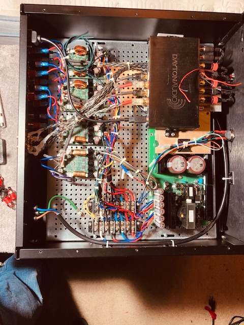

I have one more question if someone smarter then me can chime in here. I need to get +12/16V to the DSP unit. 12V is the min but 14 or 16V would be preferred but not completely necessary. The two voltages on the auxiliary supply are +/- 7V and +9V which is confusing because the 400A2 modules are expecting +/- 12V at the VSS and the VDD inputs but the PSU only gives me the +/- 7V. It seems to work alright with 7V so I don't know.
This PSU was designed to power these modules but the implementation I think could have been better or at the very least their data sheets could have been better.
Anyways back to my question, How do I get +12 to +16V to the DSP unit using the AUX supply of this PSU? Do I need to use a DC/DC buck converter or is there some other trick I don't know about? The data sheet for the PSU says the DVDD indicates a range of +7V to +12V with the typical V being +9V which is what it measures at. (+9.3V to be exact) I don't understand why they list the min/max rating as an output when there is only +9 volts present. Can anyone help me with this please?
