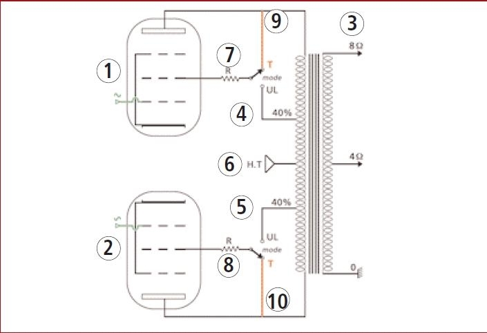

I'm not sure if my amp uses global negative feedback. I think not, it is classified as "ultralinear", does that clarify something? I have been told that the first section of the pre with 12AX7 works in class A with local feedback .....
But I was never able to access a circuit, the user manual did not bring it and everything is absolutely basic.
And really, I don't feel like handling 30 Kg of weight to examine it inside and see if I can find the classic connection cable that reintroduces part of the output signal from the OPT to the inlet valve ...
The attachment is the only thing I have been able to access.
Failure to deliver the diagram to the buyer is an absolutely detestable practice and is currently done by all amp manufacturers!
