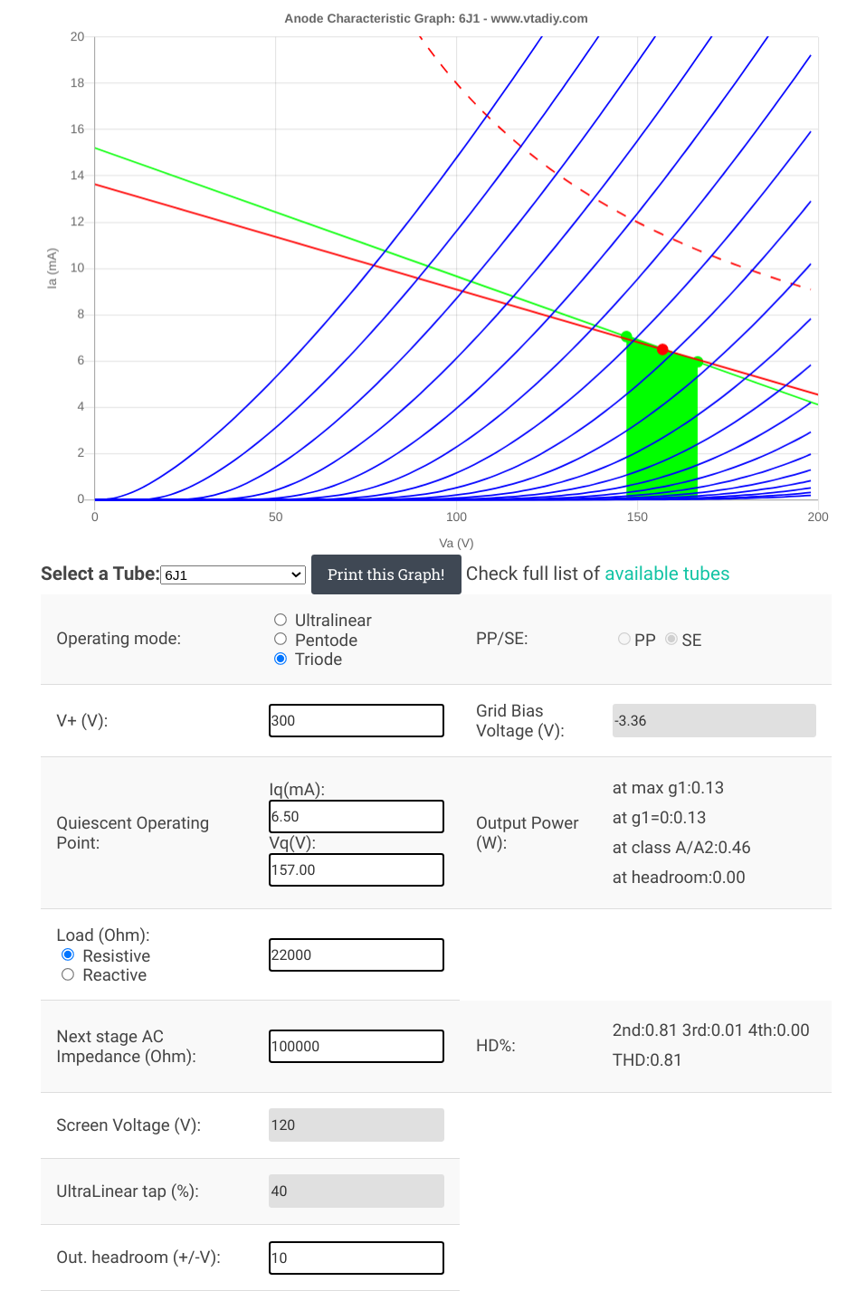

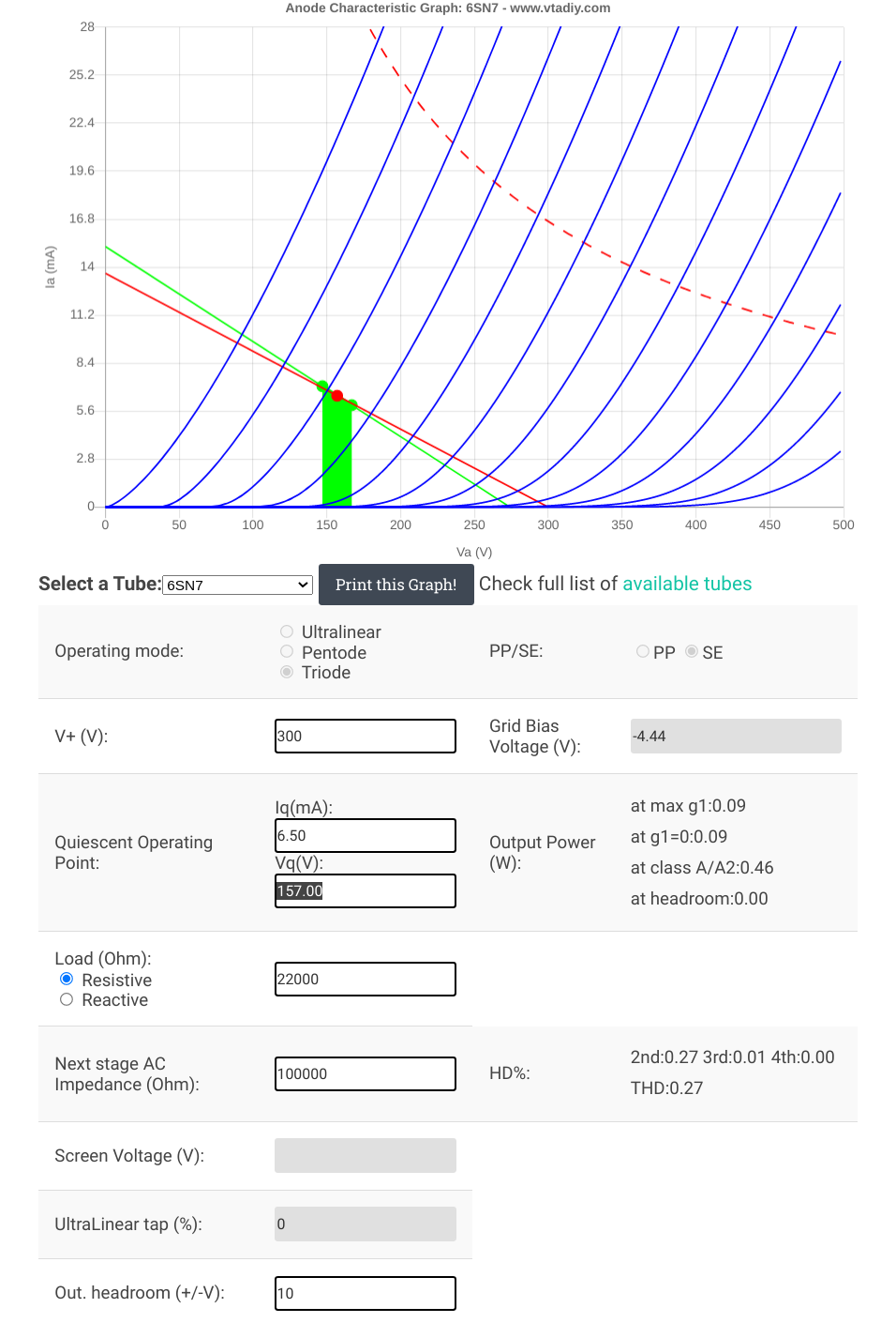

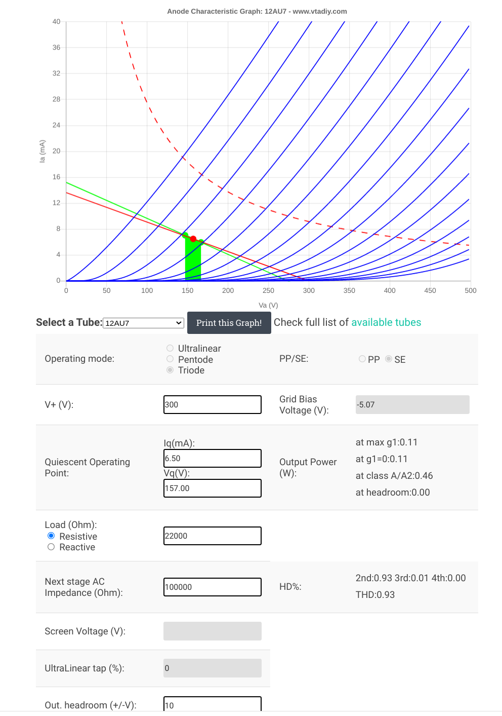

According to this, I'm right (if the OP is identical for each tube rather than being "optimized").
All three plots show 300V B+, 6.5mA idle, 22k load resistor, 100k next stage input.
EDIT: I've added the 6SN7 as most people say it's one of the most linear signal triodes. Indeed it's slightly better than the 6N1P.
That's largely meaningless. There is no reason to believe that any one operating point is best for all tubes in question. It's not a matter of optimization, it's a matter of picking the operating point most suitable for each tube to begin with.
And some tubes may not be suitable at all for a given set of conditions.
Feel free to run more data points and see other OPs to compare. It's typical to have 300V B+ and 6.5mA is typical of the average biasing though, isn't it? Of course there are many other OPs. That's why I bothered to preface it...
