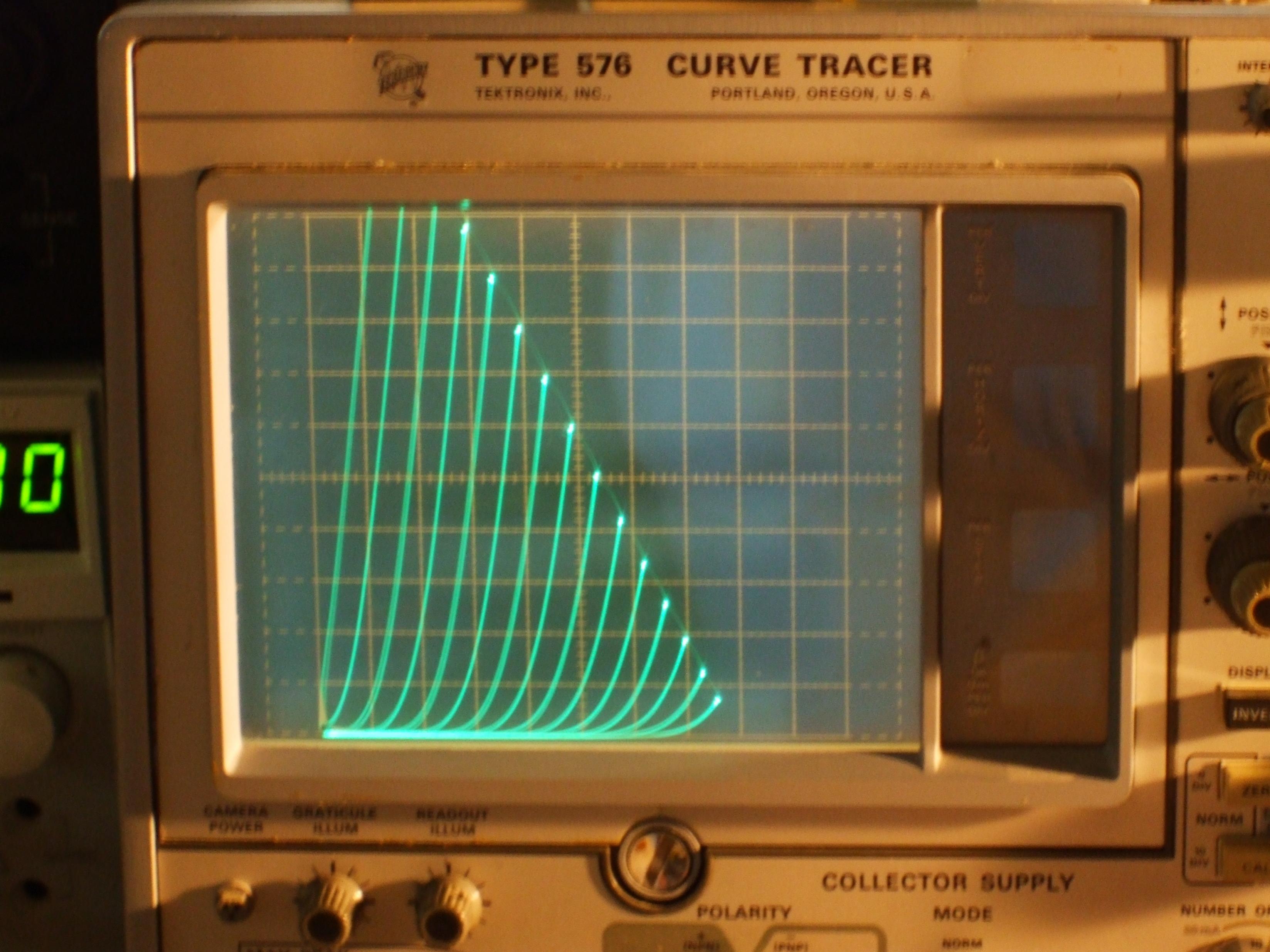

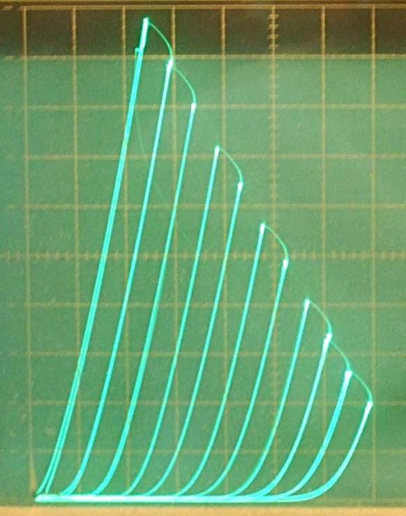

For a loong time 6JC6A was available on the $1 list. And a Japanese 6JC6A was available in quantity at $0.35 each. The US 6JC6A had great pentode curves (it's a frame grid tube) and the Japan 6JC6A had great triode mode curves (mu60, pic below).
With a big box of them, I never buy any expensive or mediocre triode tubes.
And if you need a lower mu triode (around 30) there was the 12HL7 on the $1 list. (2nd pic below) A cuve tracer selected 12HL7 leaves the best triodes behind, and in pentode or triode it leaves the D3a behind. Got a big box of them too, $1.
The 6LQ8 pentode (frame grid) makes a super triode (mu 50) too. The extra triode included is somewhat like a 12AT7. 6LQ8 was on the $1 list for years too.
There were others.

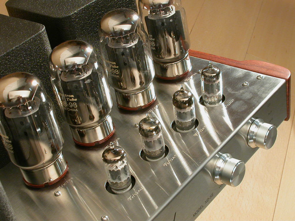

Many of us here know the " big wizard" Lampizator, especially when he started making updates to CD players to eliminate the "harsh" sound of the Dac's used in the vast majority of "entry level" devices.
The solution was to add tubes to the outlet.
I have not heard them, these experiments are not accessible for reasons of cost, freight, etc. etc. here, in the "*** of the world" .....
But many "high-end" CD player manufacturers, I think, copied the idea. The latter is to be confirmed.
Now, I do not pretend to be a defender or a detractor of Lukas, - my knowledge in electronics is not even remotely close to his -, I only recommend reading it to those who do not know him yet ......
So, on the subject at hand, (the OP opened the thread and has had so far only two minor interventions, but I suppose that in times of pandemic we can forgive any tendency to open threads "just to see what happens" , but I think that statement of the thread title, "bad reputation" has already been disproved ! ...... OMG!
That said, I have not seen Lukas propose or mention anywhere in the proposed modifications to so many amps, that 12AU7 should be replaced, why is that ? 😉

you can swap the 12au7 and the 12at7's and you may be in for a surprise...

Most circuits I've seen using 12AU7 run them at way too low a current. Get idle current up to 8 to 10 mA and their performance is just fine.
