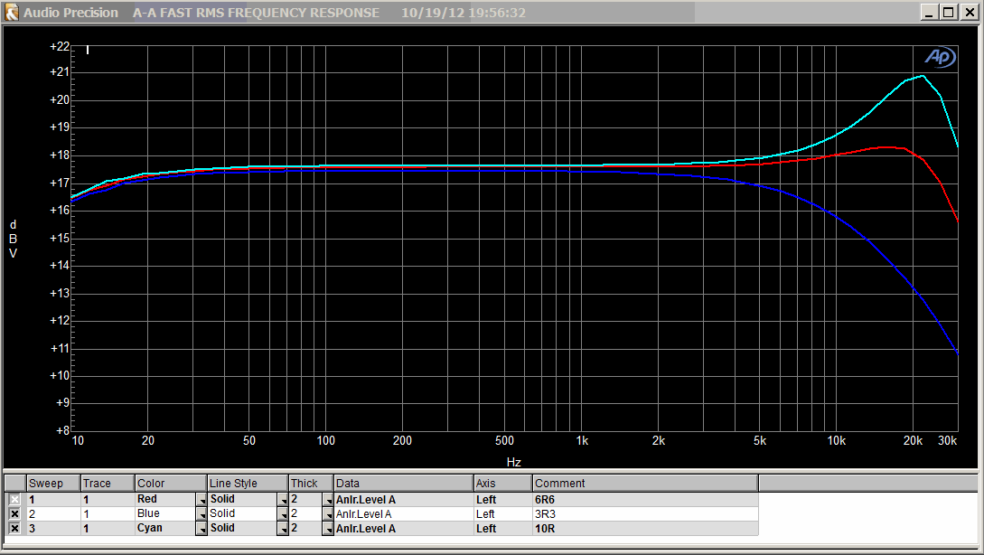

See attached FR plot vs load for a small commercial Class-D amp, based on some TDA749x (ST Micro) chip.
Only with proper resistive load (at about 5R in this case) a flat response is achieved, using a Butterworth characteristic. Too much or too little damping result in a drooping or peaking top end like one has to expect from a L-C tank circuit.
The level changes from voltage drop accross the inductor is rather benign in comparsion.

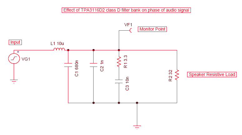

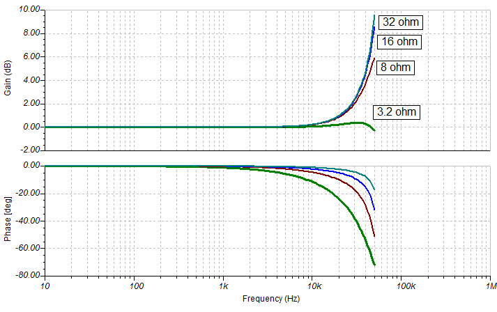

Well, this is a completely different class D amp as the 3116 is the latest gen from TI.
Here is a SPICE sim of the output factory specified output LC filter on the gain and phase for different loads ranging from 3.2ohm (design load), up to 32ohms. Note that the gain at 20kHz is 1dB or less. The phase effects below 10kHz are below 10deg.

How does that translate into magnitude response distortion? xrk971's data suggests the error is <1dB?
