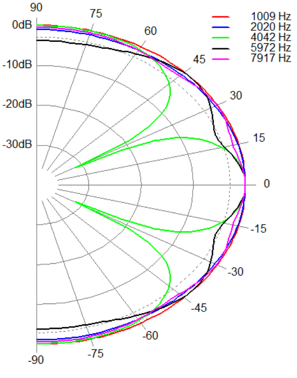

As an example.
The green line around the 0 degree axis would be called the primary listening lobe. Presumably because it looks just like a 'lobe' on a polar plot. I have never heard the word 'point' used to describe this.

As an example.
Your example only looks like a "lobe" because it is one dimensional - angle off axis - only in one plane. If you were to look at it as a polar map showing two angles - off axis and around the axis - you would see that the 30 degree "hole" goes away in different planes. If this plot were due to a finite sized piston then the null would be a circle and not be different in different planes. Using the term "lobe" for both effects leads one to believe that they represent the same kind of effect when in fact they don't. Use the term "lobe" if you like, it can usually be determined from the context which effect you are talking about, but I will continue to understand them as two different effects because the results are quite different.

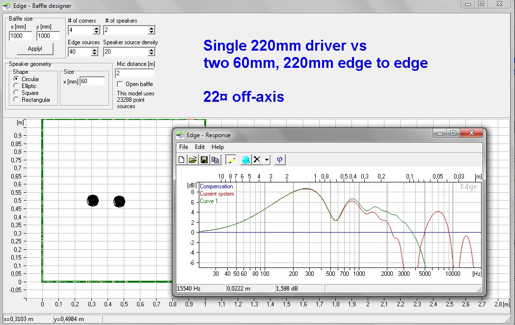

Here is yet another way to look at lobing/combing of a single source vs. two sources, both 220mm edge to edge. Two 60mm drivers simulated in the worst direction (along the line) in The Edge. As we have seen in previous examples, the lobing/combing gets even worse at larger off-axis angle. Low and steep xo helps to minimize these problems.
This worst direction of a loudspeaker is usually vertical. A clever MTM has driver diameter, separation and xo selected so that horizontal and vertical "valleys and hills" compensate each other. However, a cleverly designed coaxial maintains smooth response both vertically and horizontally.

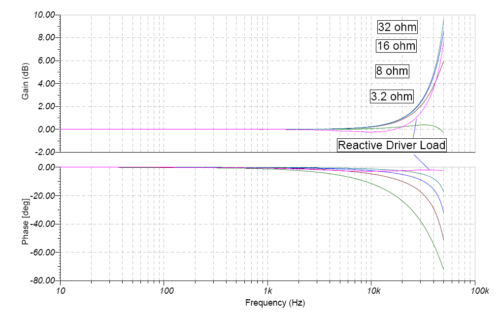

This is not distortion that I simulated - it is the effect of the LC filter used by the tpa3116 on gain and phase when tied to various resistive loads.
Any change on the input signal is distortion. Sorry if I'm using the term too strict. Nevertheless my question is, are those number posted by you and KSTR a real depiction of real amps connected to real speakers?
If I'm reading your post right then the error in real world applications is <1dB and therefore a non-issue?

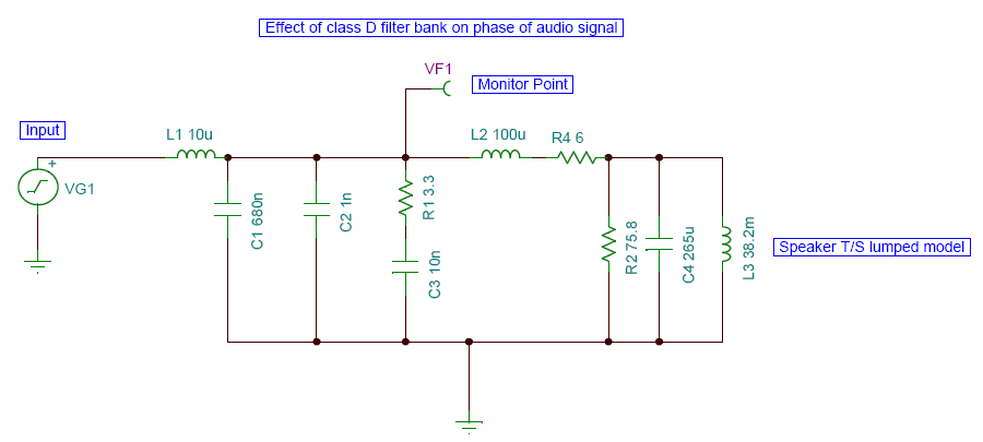

Well what I showed is a SPICE circuit sim, which is, I think, generally good enough or this kind of a circuit simulation of an LC filter. It does accurately depict what happens for an AC signal with a fixed resistive load. If you want to add the effect of a reactive load such as a speaker driver, we can do that by representing the T/S parameters as lumped RLC elements in the circuit. Here is a typical driver with a 4.6ohm DCR. The simulation, now accounting for how the reactive components of a driver interact with the LC filter in the TPA3116D2, actually provides a much nicer gain and phase error response. Working together as a 'System', the gain error is now under 0.5dB at 20kHz and phase error is under 3 deg.
Here is the schematic including a reactive driver (magenta line):
Here is the resulting predicted gain and phase response for this driver interacting with this LC filter (magenta line):
So you can see that for all intents and practical purposes, the class D amp LC filter is flat in gain and phase for a typical driver. Thus, if you do your XO actively before the amp, it is a non-issue. The LC filter essentially presents no distortion in amplitude or phase is used as an active XO amp.
As Dewardh said above,
- I agree.If you're DIYing it, and using the Class D amp after an active crossover, then it's not an issue at all. The effect is inaudible, and as a practical matter unmeasurable, with most class D amps driving the woofer or midrange, and it simply becomes a part of the device response curve if you are using the amp to drive a tweeter
