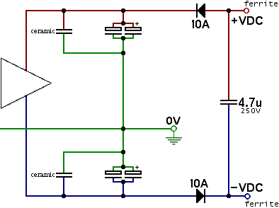

A basic high current DC power filter is in the attachment. The unlabeled electrolytics would be 470u for TI-Overture, or 220u for others. You may have seen something like this for front end power in discrete amplifiers (except that this is a high current version for the chip amplifier).
A cheap smps will add audible noise (hiss) to the amplifier, reducing your s/n to 75 db or less. A clean smps supply will cost a lot more.

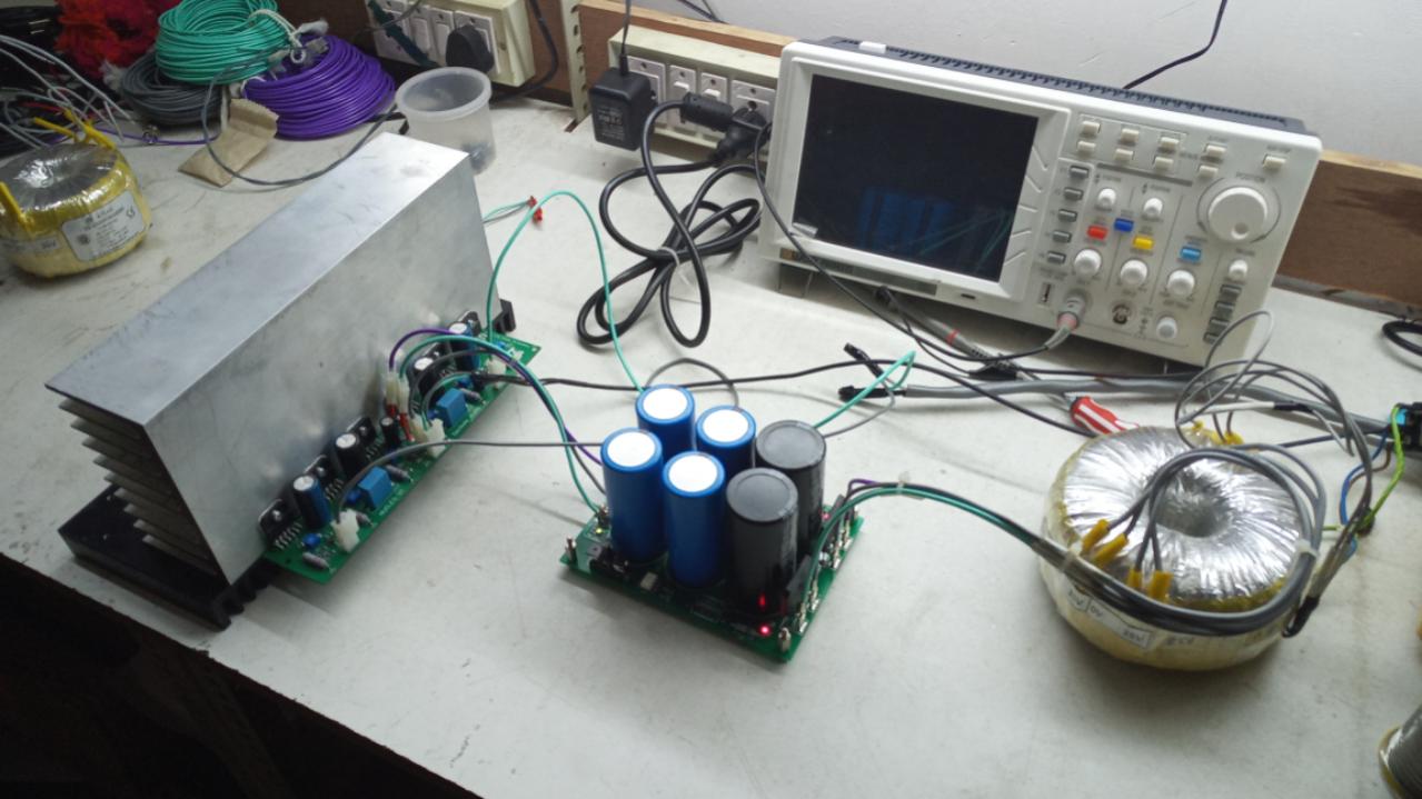

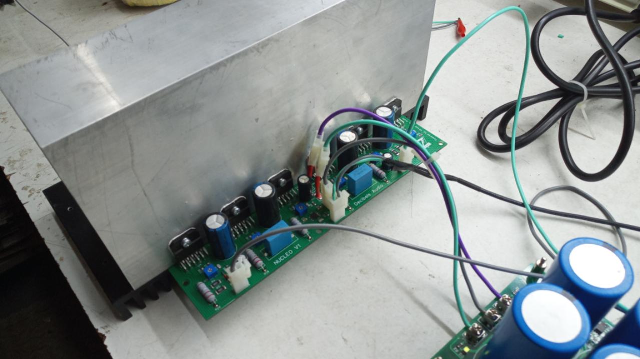

Hi All, a few words, if I may, defending eligibility of the chip amps for delivering high quality at relatively high power.
Attached pictures show one of my designs called "NUCLEO" - sorry I can't share the full detail about the design - at least right now - as it's been designed for the commercial customer.
However, I will give you a pretty clear idea of what it is. Take 3 x LM3886T, use a pretty much datasheet-recommended design for each of them, then parallel them using a 0.22R resistor at the output of each of them. That's one side of a bridged configuration. Use the same thing for the other side of the bridge (other 3 x LM3886T). Put some phase splitter at the input - I have used DRV135 balanced line driver, DC coupled with 3886 triples mentioned above.
Put the load between the outputs - this kind of thing is powerful enough to deliver up to 300W into the 4 ohm load (each side of the bridge sees 2 ohm in this case - no problem, but don't go lower than that). +/-36-36V rails - I'm using a 500VA transformer and 30000 uF per rail for my prototype. Don't forget about "fat" wiring 😉
Yesterday we did listening of this thingie driving a 6 ohm 300W speaker up to the level where it looked dangerous for the LF drivers. Very good sounding in general, delivering punchy bass in particular - it was very much up to the expectations of the customer.
Valery

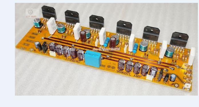

Is Jeff Rowland 's with balanced/ unbalanced input similar ? 79$ on Ali.
Looks pretty similar at a first glance.
that amp in post 65:
Looks good to me although I would use DC-servo-opamps with this ...... but then who knows if maybe they are below the pcb 🙂 ............
yes , underside are 4 tl072 but no dtv135 .
ZEROZONE (DIY kit) Hifi LM3886 Mono amplifier kit 360W base on JEFF Rowland amp L6 8-in Amplifier from Consumer Electronics on Aliexpress.com | Alibaba Group

In my Nucleo I use a manual trimmer for each LM3886, however, even with no trimming, DC offset between the output terminals is less than 4mV - nothing to worry about.
I would not trust parallel LM3885 without DC-offset-servo and very precise gainmatching .
The slightest imbalance leads to wasted power , overheating of one of them and sooner or later premature failure , wether the imbalance is offset or gain or , worst case, both----
That's why we use a resistor in series with each output. Use feedback resistors with 1% tolerance and you are perfectly fine withgain matching. Trim the offset of each IC when it's warm - no problem with the offset marching.
You have to build and test for being sure if you can trust or not 😉 Otherwise it's just a kind of unconfirmed disbelief 🙂 Servos are good to have, however the amps run nicely with manual trimming as well - all ICs are equally warm. For me it was important as I had rather strict budget limitation from the customer.
Did you measure any noise on the amp inputs, where the trimmers are connected? I am guessing you connected the trimmers between the power rails.
Sorry to disagree . Even if you use 0,5 ohm resistors an imbalance of only one volt for whatever reason will impose a current of 0,5 amps supplied or sunk by the two amps whose outputs are balanced and 1 amp sunk or supplied by the third one which is not and fighting against the other two. Unless you measure differences in temperature with a sensors on top of each chip and simultaneously even then you will not get the actual temp of the die but an averaged outside temperature. One amp in third chip at a rail voltage of 24 volts : do the math yourself..... and at 36 Volts worse still so all I can do is say dont do it even if the customer doesnt want to spend whats truly necesary as when it fails and it will fail YOU will be the one who is blamed....... just explain the maths to the customer.
you do not need expensive op-amps as servos and this plus a few resistors and a small capacitor or two do not cost much compared to the cost of what you are building.
Jeff Rowlands uses them and even the cheap chinese copy mentioned does use TL027s
