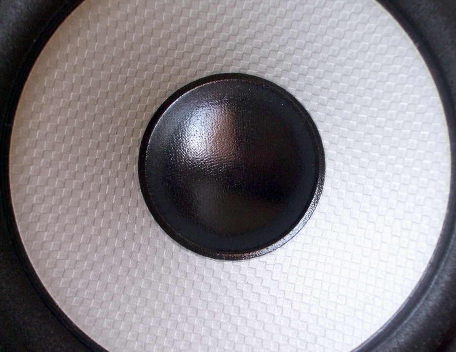

The speaker is fine folks....well boys, you should try one of those ones
China is also producing nice things...for a while they are are not producing unobtanium.
Maybe we will have to produce some "fashion" brands for Chinese speakers, then they will became awsome.
This one, for instance, reproduce without noises the sound you put on it.... do not distort more than others and also reproduces tone under and above our human hearing limits.... this one moves and compresses air alike all speakers.
Be happy and enjoy music boys.
