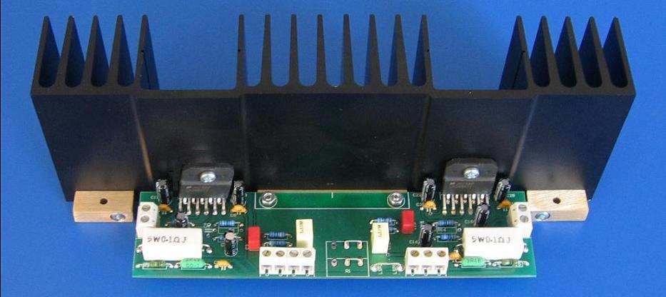

I agree with the notion that a lot of the bad reputation of chipamps is the stupid "gainclone" philosophy. When treated like any other solid state power amp, ie with a good layout, proper decoupling close to the IC, a good heatsink, good stiff power supply and MOST importantly not trying to exceed the chips rating, they sound very good indeed especially given the simplicity.
I think trying to get the maximum 68W out of the LM3886 is half the trouble. Personally I wouldn't use it past 30W, i.e. 25v rails, giving plenty of margin.
I had the opportunity to compare my LM3386 amp against a relatively decent Arcam Alpha amplifier, and i couldn't really tell any difference. Both amps had 160VA transformers, and the Arcam had 1x6800uF per rail (35v) versus my chipamp's 2x4700uF per rail (25v).
I do suspect that chipamps might be a bit suspect with complex loads, but for driving my Wharfedales and Eltax Liberty 5's, they sound great 🙂

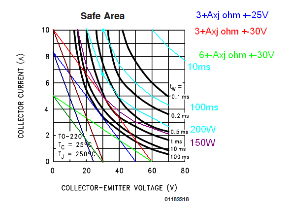

"I think trying to get the maximum 68W out of the LM3886 is half the trouble. Personally I wouldn't use it past 30W, i.e. 25v rails, giving plenty of margin."
Yeah, that's probably a very good idea - SOA is a bit challenged and contrary to discrete BJT:s with huge chips these have pretty short thermal time constants. (A typical big BJT like 2SC5200 can take for 10ms double the peak power a LM3886 output transistor can for *0.1ms*)

megajocke said:"I think trying to get the maximum 68W out of the LM3886 is half the trouble. Personally I wouldn't use it past 30W, i.e. 25v rails, giving plenty of margin."
I've made very similar plots to yours with BJTs, MOSFETS and several different chip-amps...and I can't agree more. The 3886 doesn't have the "guts" of a discrete amp. National's data sheet is partially responsible, claiming power ratings under conditions that are likely only to happen during development when you can absolutely control the load and rail voltage. To their credit, they do tell you all about the chip, and study the document long enough you'll figure out what it can and cannot do.

Technically there is no problem putting out 200 and more watts with chip-amps , its a matter of what one is prepared to spend on the things .
A bridged circuit using two LM3886 is no problem at all and can put out 100 Watts provided that the speaker is not less than 8 ohms. Lower the supply-rails accordingly as the chips will see 4 ohms each and use a very good opamp at unity gain to invert the input signal on one of them is all. Should be enough for sound at home.

Any solid state amplifier, chip or otherwise, will have good control over the loudspeaker if it is used within its limitations. It is sickeningly easy to use a small amplifier beyond its limitations. Doesn’t take much volume to clip a 40 to 60 watt amp. And when an amp clips, it’s damping factor is determined by the power supply’s output impedance. Face it, no one is going to use a $600 power supply with a $6 chip - you get what you pay for.
If you manage to get it to current limit, you fare far worse. During the time the current limit is active, say when driving a bass reflex speaker at it tuning frequency where the impedance hits 3 ohms, the output impedance goes high. It becomes a current source, which theioretically goes to infinity. Well it does go high enough that the speakers voice coil might as well be open circuited. Any transient, regardless of fundamental frequency, causes the speaker to ring like a bell at its fo. You’re going to get low frequency noise and extra spectral content, even if the offending frequency is higher. A speaker has another impedance minimum as well, and it tends to be in the low midrange where power content is high.
Even if you’re not going into full-on current limit, when the output transistors run out of current gain driving low Z the whole amplifier operates closer to open loop. Damping factor degrades, and so does everything else - distortion, noise, high frequency response..... you’re not going to get the data sheet distortion numbers published for an 8 ohm resistive load with a real speaker. - easoecially one that cheats on impedance to be “louder”.
