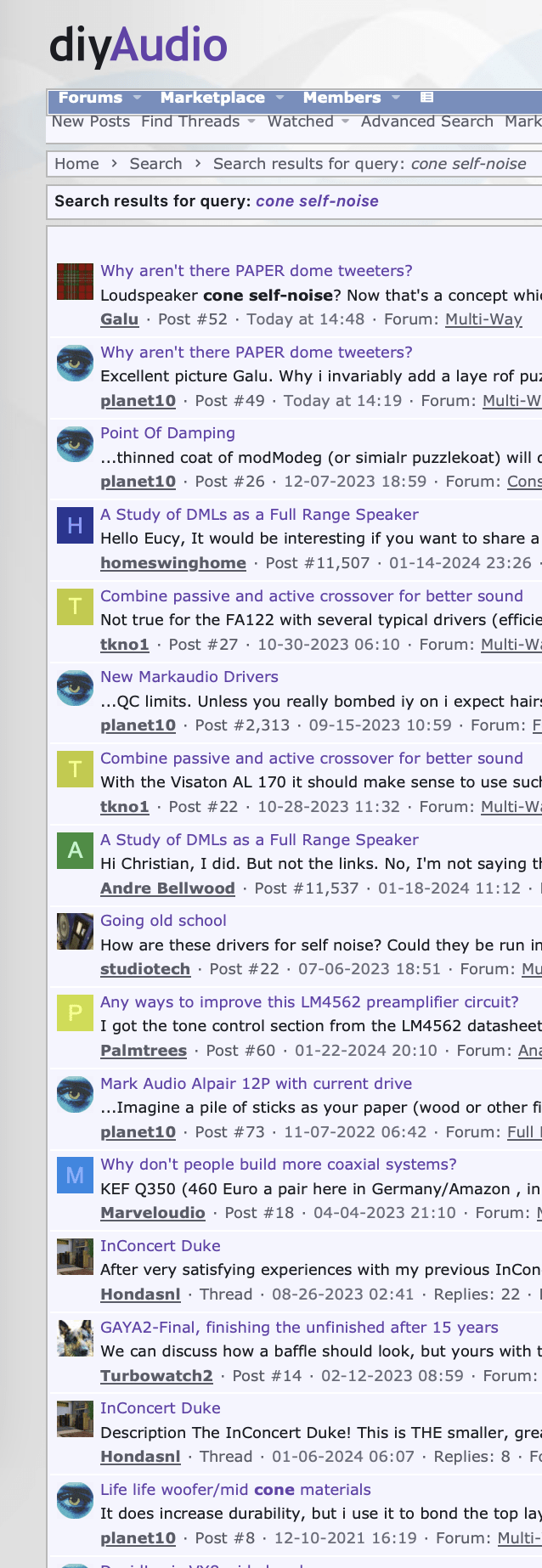

Why i invariably add a laye rof puzzlekoat/ModPodge to bind them all together so they can’t rub together an casue cone self-noise.
Loudspeaker cone self-noise?
Now that's a concept which is currently evading my legendary googlin' skills!

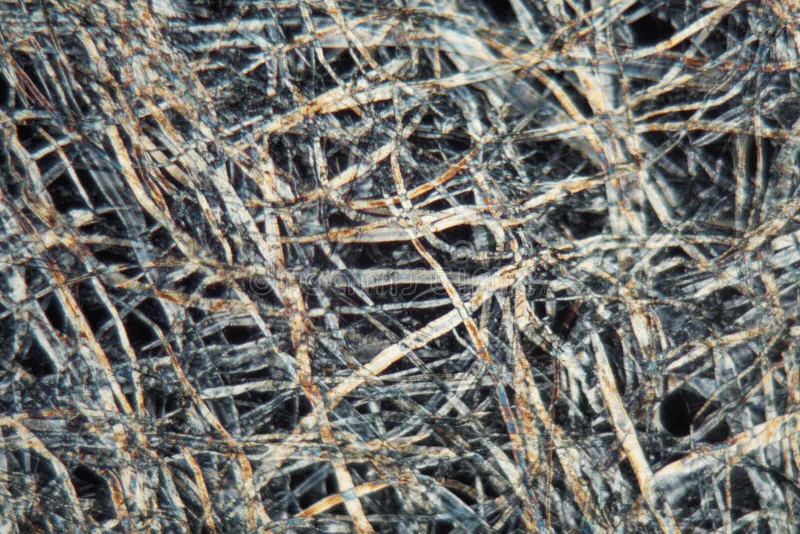

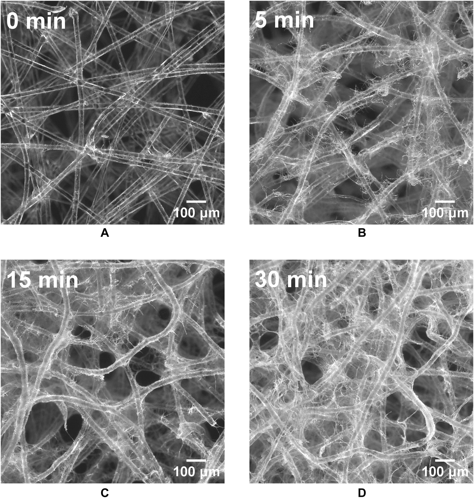

I do read that the addition of synthetic fibrillating fibres with their tree-like structure to the paper pulp can mechanically bind the paper fibres together so they won't rub together.
Images of fibrillating fibres:

A term i coined and likely mostly seen here, and likely my web-site. It probasbly has mosre names — it should.
As usual, all sauces are secret, cone makers don't divulge them even under torture.
