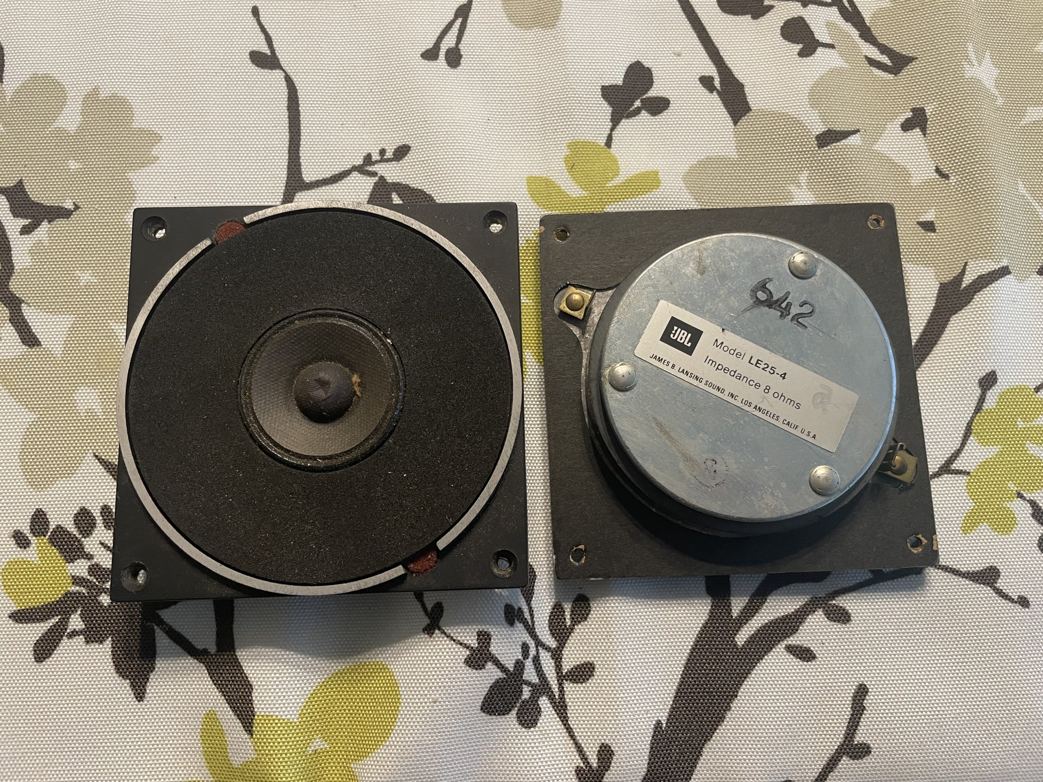

I think,one of the issues with cone tweeters is the mass of the moving structure. The JBLs get away with it by being smaller cones and a really strong motor. They can have their way the cone at really high frequencies. Impulse response is pretty good with them.

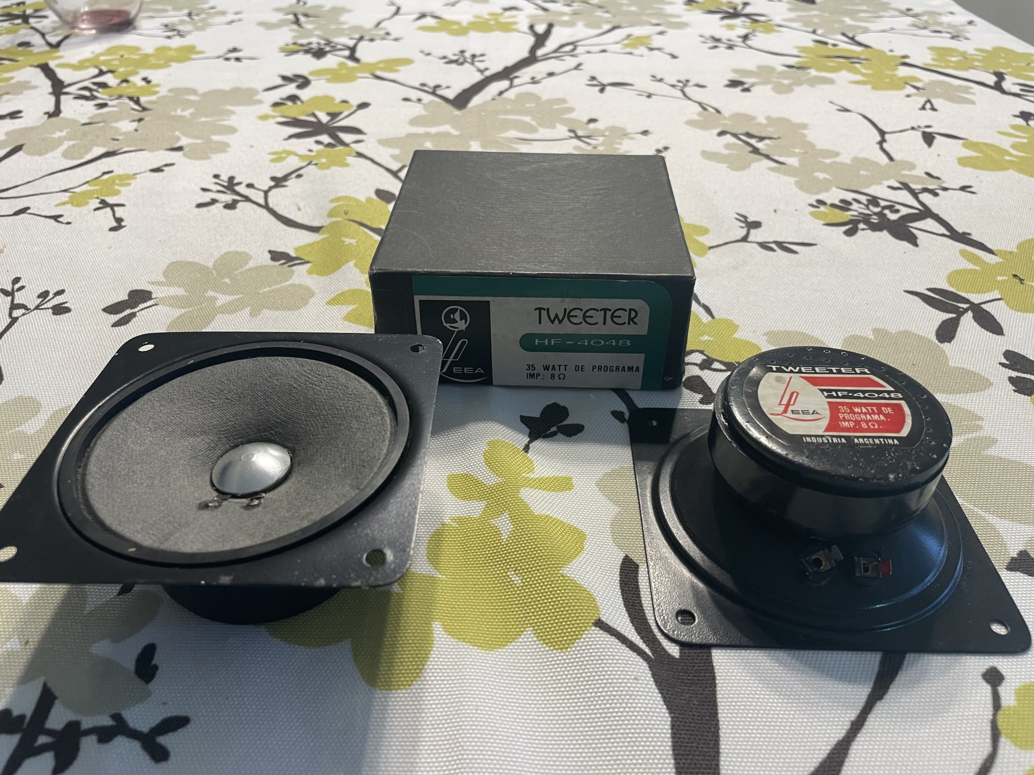

Hi JMFahey, I am pretty sure you also remember this ones:
Gee!!!
I LOVED those LEEA cone tweeters and used them A LOT:
They reach surprisingly high, notice the aluminum dome glued straight to voice coil.
Great for Hi Fi, only problem for my personal use (LOUD PA way back then) was that they were EASY to blow.
I had to use many (as in 8 per cabinet in 2 angled arrays) and even so ....
Maybe you remember Johnny Allon.
One night he was playing at some huge "bailanta", he approached the PA speakers too much (I had custom made his mixer, power amps and cabinets), a short loud squeal ... and instant mud after that.
He had burnt all Tweeters 😱
After that I was forced to make my own high power version ... or else.
That.
Cone tweeters are basically "small speakers" , with a definite rolloff point above which they drop like stones.
Making everything smaller/lighter does not beat the basic Physical problem, BUT if you can move it nearer to limits of Human hearing, that's "good enough" from a practical point of view.
JBL made a small light cone tweeter, period; the famous "phenolic ring" ones are simply a way to mount a 2" cone in a 4" frame.
Nothing intrinsic to the phenolic ring itself, it´s just a "mounting adapter"
They also made a "10" cone in a 12" frame", again using a "phenolic ring"
Or maybe it was Masonite!!! 😱
Can anybody check that?

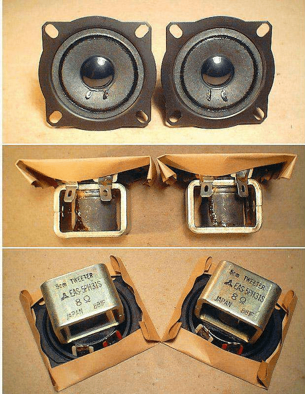

Anyone ever try a pair of these?
The big problem (for me) with most cone tweeters is the tiny VC, leading to low power handling. A big motor is the way around that, but unless the back chamber is very well dampened ( which most aren't), the tweeter won't be on the performance level of a good soft dome. The JBL LE25 was one of the few decent cone tweeters, mainly because it was designed with a large motor more like a good dome. The design of the cone was better than that of almost any other similar tweeter and was acoustically very well behaved.
The newer copy of the old CTS tweeter done by GRS is very good for the price. It sounds alot like a LE25 and is close to 95 dB / W.
