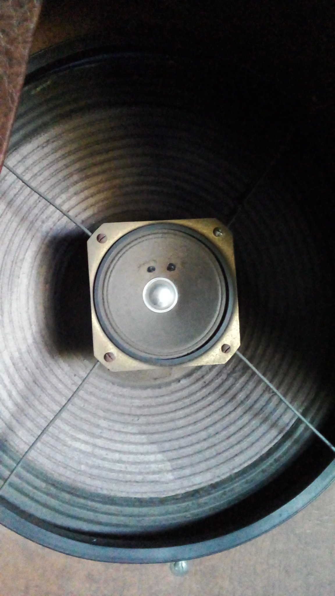

I am using cone 10cm tweeters to make my own coax in my Karlson's. They are Jahro, manufactured in Argentina some years ago. Now are imported from China.

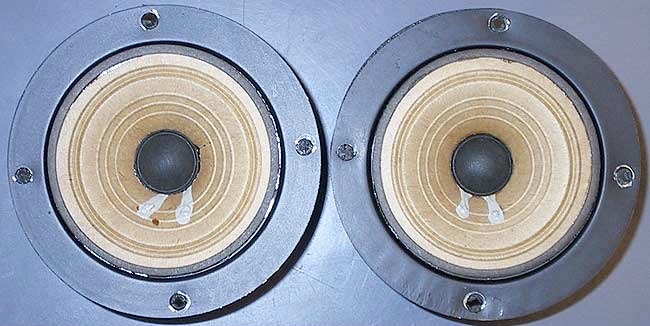

The Advent "fried egg" cone tweeter was an attempt to meld the dome and the cone tweeter designs, with decent results.
----------------------------------------------------------------------------------------------------------------------------------------------------Rick...

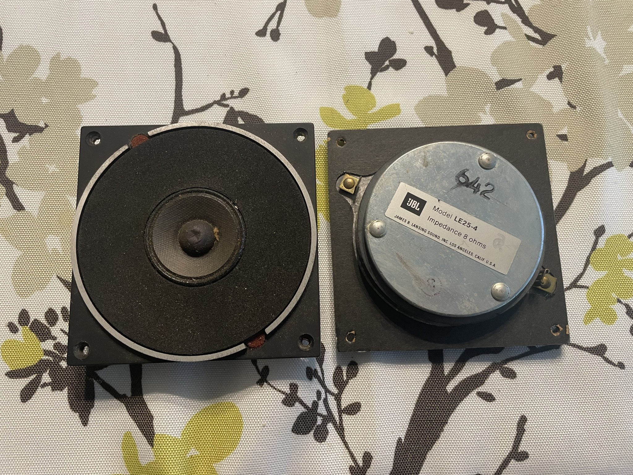

In 1989, Henry Kloss told me his Ensemble tweeter was his favorite tweeter.

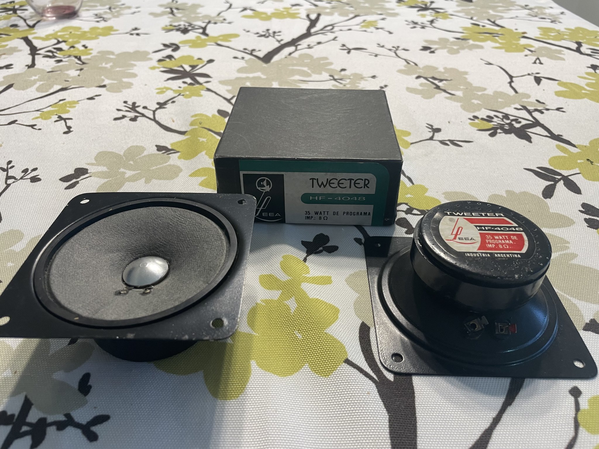

In certain applications they are very valid and quite useful.
So much so for me that I actually made my own, go figure.
I make MI amplifiers, speakers and cabinets, and here:
* they reach low, they can be crossed over down to 1500Z (try that with most domes, except maybe some $350 Focal dome o something)
* they handle honest 25/30W RMS.
Translate that to 350W RMS cabinets.
If biamped, can safely be used with a 40/50W RMS amp (LM3886?), because constant clipping at Bass frequencies is common (DJ/PA use); constant clipping at HF? not that much (it sounds F-ugly).
* MI and PA cabinets want to push sound straight ahead, where the Audinece is, so lobing is not a big deal and narrowing/focusing even less.
In fact, it´s a bonus 😉
* mine are LOUD, I used a strong motor (for a cone Tweeter) to achieve that: 76mm by 10mm magnets (twice as usual weight), 19mm high power voice coils, 6mm high gap.

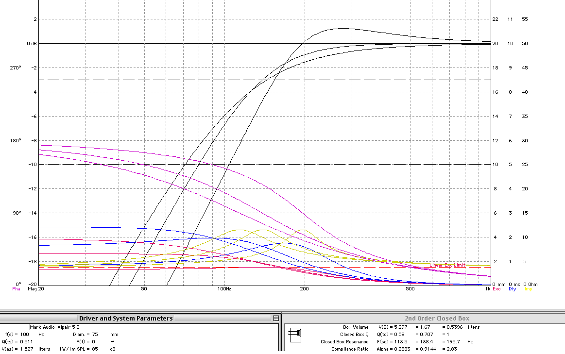

I confirmed the A5.2 (publ. Fo~95hz, Vas~1.8L) began rolling off ~140hz in ~3.5L sealed, as expected. Next step would be to fill the cab with coke cans to raise Fb and roll-off further up.
