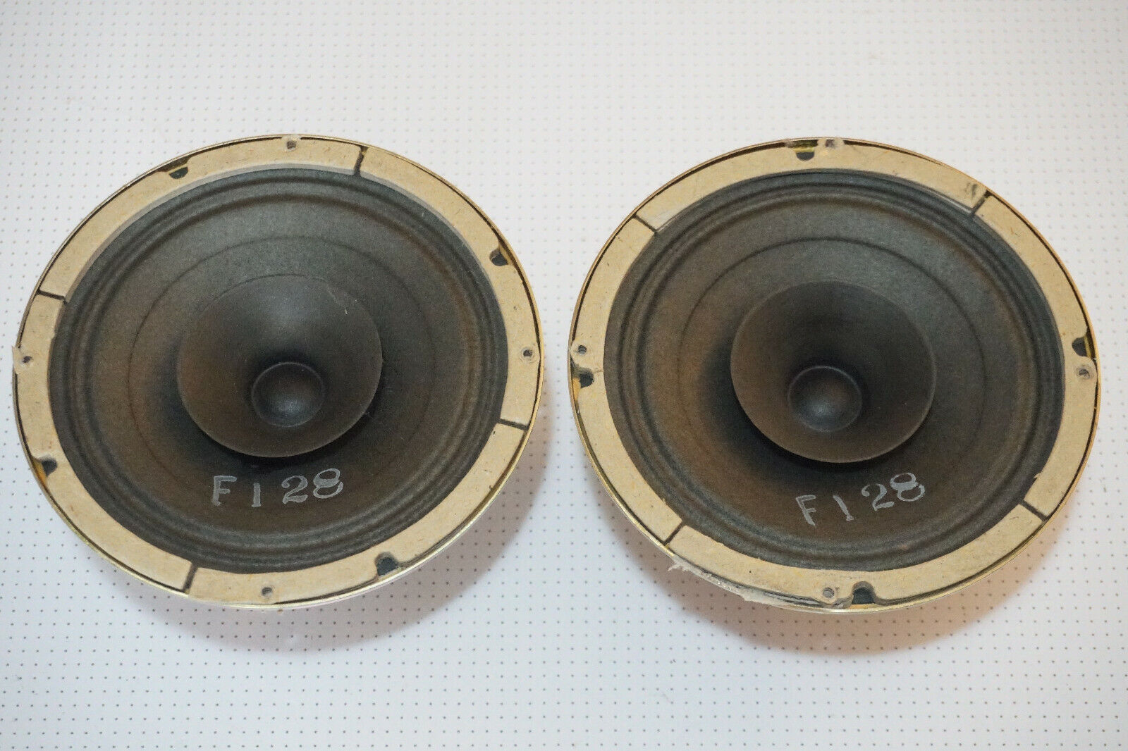

These 5" Plessey tweeters were state of the art in 1970s NZ, got a pair if anyone wants them.....
I'm sure cones would be used if anyone made good ones anymore, but when domes came out they were so superior they effectivly killed off cones except for low budget manufacturers
