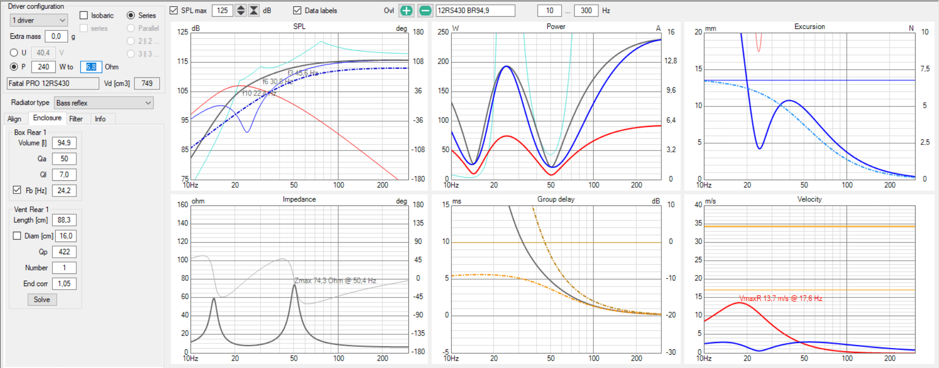

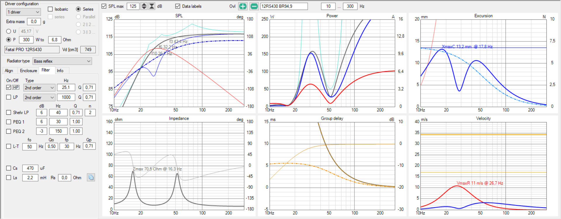

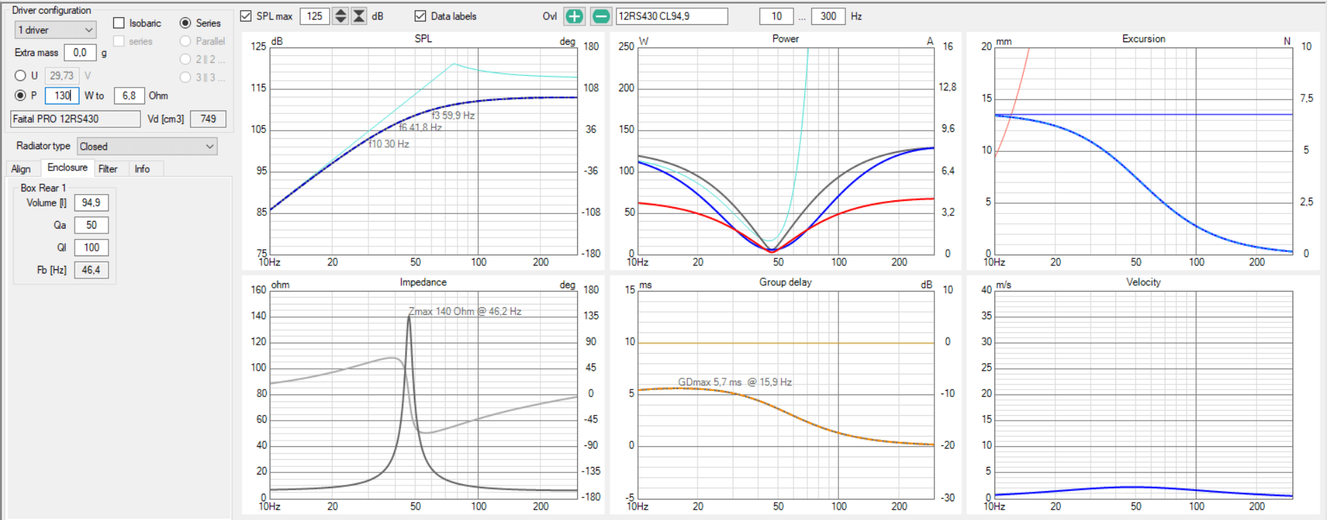

Another driver faitalpro 12rs430 in closed box, and in ported box with and without high pass. I cannot make the ported box not to exceed xmax and be louder than the closed box without high pass filter. Unless, there is assumption that say below 20Hz there is no musical content and one is willing to buy new driver should it break, then high pass filter might not be necessary. Ported and very low tuned box exceeds xmax on very low frequency and resulting group delay around 100Hz and even below is similar to closed box.
Here is the closed box, auto calculated by VCAD.
Same size ported box, lot's more output extracted with more amplifier power, but without high pass filter excursion skyrockets. This is adjusted here so that xmax is crossed about at 20Hz. Group delay is similar to closed box down to say 50Hz.
To protect the driver, high pass filter makes the group delay bit worse, but even more output can be xtracted with power. The driver should not annihilate when dropping the needle, or a mic.

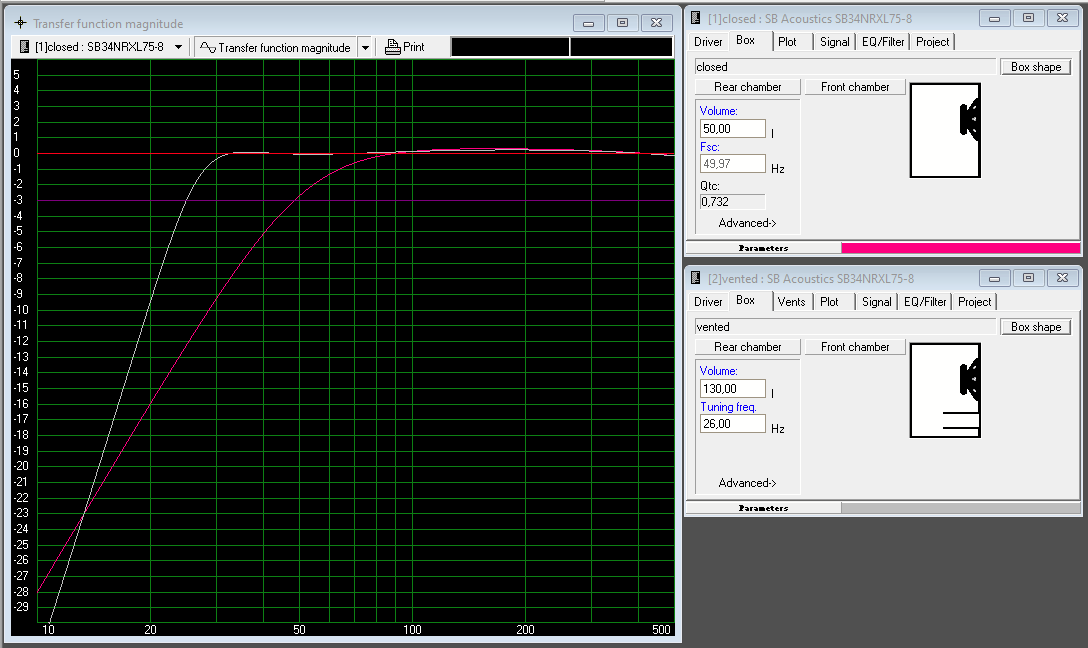

Thanks. I had run some sims with the Dayton RSS265HF-4 and SB34NRXL75-8, but I was busy yesterday so i could not post any graphics...I'm sure you all have simulated this stuff but here for others

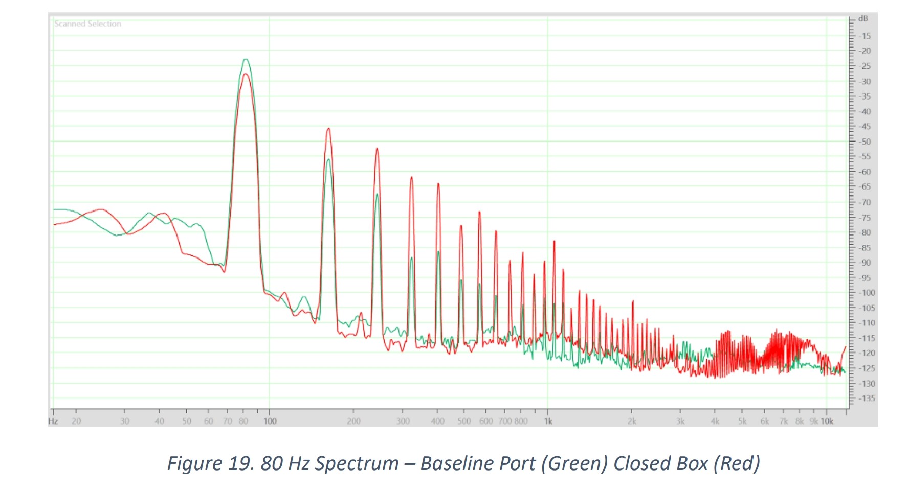

And now show the same measurement with a 40Hz signal .Here is a comparison of the same driver in a closed and ported box with the same strength 80 hz drive signal. The ported system clearly has lower distortion and noise as well as about 6dB more output at the tuning freq.The difference is not subtle.
Of course does the port help arpund the resonance frequency - but ONLY around the resonance frequency! Doesn't do anything above and it's horrible below without protection filter.
Yes, look at the responses of the woofers, they are vibrating at every octave. 40hz, 80hz, 160hz, 320hz, … They are ringing like bells! In a properly built properly damped enclosure the ringing should be very much reduced. The enclosures should be built from solid materials, braced, and stuffed with fiberglass or wool.Can you explain what you mean? I'm not sure how damping is related here?
