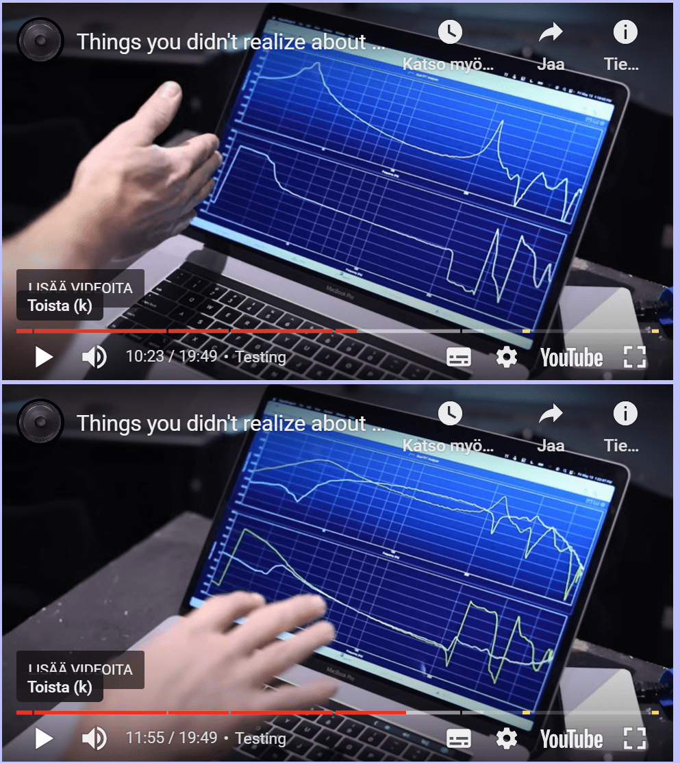

Also, if the port and woofer are separated, as in one in front and one in back, there could be some "lobing" at frequencies that are a little out of phase like what they demonstrate in this video. But to observe it you would have to measure in half space with no reflections? I believe this would be a small effect since the out of phase portion is lower energy. And this effect would be nullified by reflections and room modes....(pun intended)

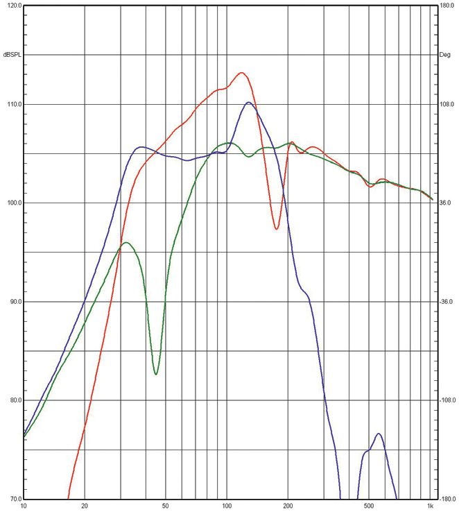

1 Transient vs. steady state behaviour is very different for resonating systems vs. direct radiator
2 There is phase shift in the output signal of the resonator (port or passive driver). Delay as term is not relative to frequency like phase shift!
3 Summed spl of nearfield measurements is a simplification that gives false result

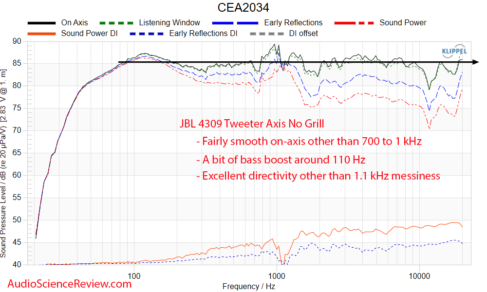

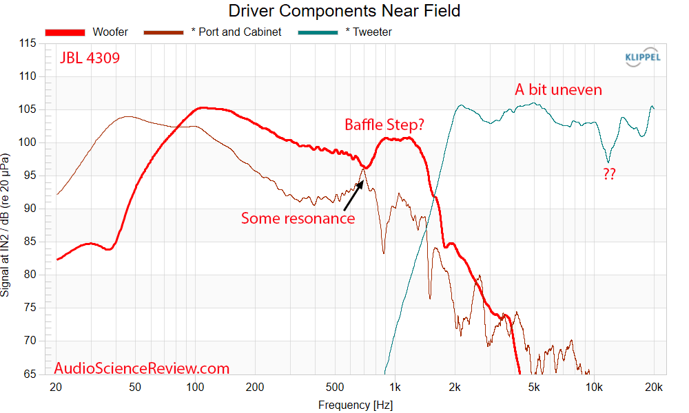

As an example look at Amir's measurements again! https://www.audiosciencereview.com/forum/index.php?threads/jbl-4309-review-speaker.27255/
-these are steady state measurements!
- impedance measurements tell that tuning frequency is 45Hz, but woofer's spl minimum is at 37Hz
- notice also what ports do at 700Hz!

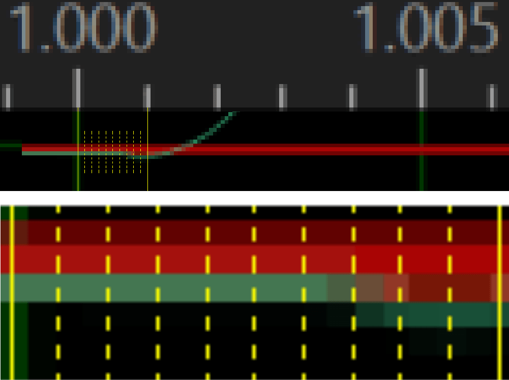

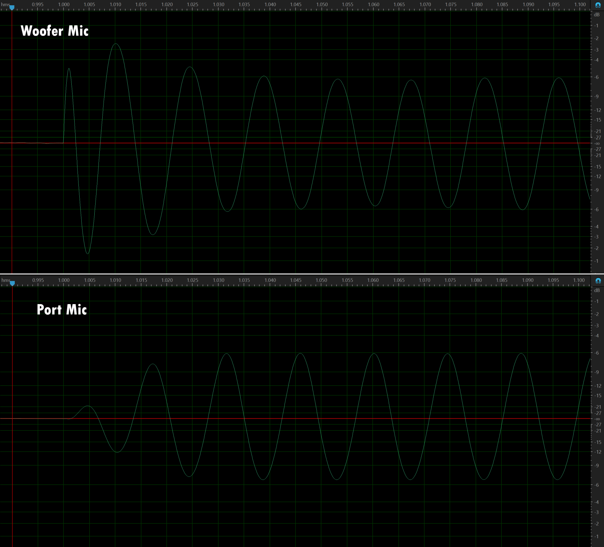

Again, the confusion stems from faulty methodology. You simply can’t look at time/delay and draw conclusions with a steady state signal. Plse redo with a transient, f.i. a step, and get back.Here you are, woofer and port at tuning frequency of 70 Hz recorded with two mics simultaneously and normalised to the same steady-state level. I've also attached the files so you can look for yourself. Let me know what you see here!
My impression:
There is approx. 1 ms between the woofer and port rise off the line. The woofer and port exit are physically separated by about 20 cm. This is clearly not a delay equal to 180 degrees at 70 Hz, which would be closer to 14 ms. The propagation of sound over 20 cm however would only be about 0.6 ms, so there is a small delay I can not account for there.
It is true the port takes a few cycles to build up. This is clearly seen in the woofer amplitude being higher on the first cycle and then reducing as as the port builds up.
I think, we can say the combined response is minimum-phase and the system phase is simply linked to the frequency response. This does not change the fact the woofer will have to work harder on the first few cycles of any waveform until the port resonance is established. Of course, it would need to work harder all the time, without a port. I don't really see any 'time smearing' that would not also be caused by EQ'ing a sealed system.
What do you all think?

Graphic presentation is summed nearfield spl

But many more cycles to decay once the resonant energy has been built up in what is simply a poorly damped Helmholtz resonator. This time smearing after the signal has ceased is minimised in a sealed enclosure.It is true the port takes a few cycles to build up

Correct, I think we might need an explanation of minimum-phase systems here so I'll do my best:Damping is provided by the driver and is defined according to the response, calling it good or bad would be a reflection on the alignment.
Minimum-phase refers to a set of predictable behaviors in harmonic systems that vibrate or oscillate. The essence of these 'rules of behaviour' is that frequency response and phase are inextricably linked and mathematically predictable. This means that any adjustment to the frequency response of a loudspeaker will result in a corresponding and predictable change in phase, both transient and steady-state.
The key here is that minimum-phase systems are not only found in the mechanical world like loudspeakers and resonators, but also in electrical circuits. They are functionally equivalent and can be interchanged. For instance, a resonance causing a peak in a loudspeaker's frequency response can be neutralized by a counter resonance in an electrical circuit, which will adjust both the frequency response and the phase behavior of the system.
Thus, if the combined behavior of a port and driver in a loudspeaker constitutes a minimum-phase system, the phase behavior—including transient response, ringing, and decay—is determined by the frequency response. If EQ, which is also minimum-phase, is applied to make a ported system's frequency response mirror that of a sealed system, the phase response will mirror as well. Conversely, if a sealed system is EQ'd to enhance its bass as in a ported system, it will exhibit the same phase behavior as the ported system.
The measurements @stv and myself have shared show that while the combined port and driver system is indeed minimum-phase with no 'excess delay' in time of arrival, the individual components of the woofer and port do take a different share of the load on the first few cycles of a waveform. The distortion and max SPL will therefore suffer in a dynamic and non-linear way, even regardless of EQ, but those two metrics will never be worse than without the port.
