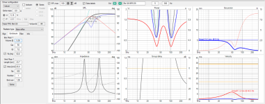

Example to illustrate what it means when excursion skyrockets below tuning. Took random small driver as example. Here in this case tuning at 60Hz excursion of the system hits xmax with 5W of power, without high pass filter. In a closed box it can make similar output at tuning frequency, just takes more power. Extension gets much lower as well with closed box. The closed box would require very different crossover to maintain system response around the 60Hz, so there is a lot of difference between the two in system context. If the room has modal peak around 60Hz the closed box would work better and so on.
I'm not for or against either, both could have very similar response and sound for example and either could work better or worse in system context depending on many things. My point is bass can be achieved many ways, where the difference is mainly with the trade-offs. Select the trade-offs that suit best.
For completeness same data as above but overlaid, so without high pass filter the closed box could perform better, be louder above and below and at tuning within limits of xmax, because it has less excursion 😉 In reflex box xmax exceeds below tuning without high pass filter.
With high pass filter engaged the situation reverses, excursion is truly less and reflex box gets louder within xmax.
It's likely possible to juggle a reflex box that is better than sealed even without high pass filter, but to really get advantage a high pass filter is required.
