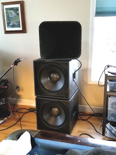

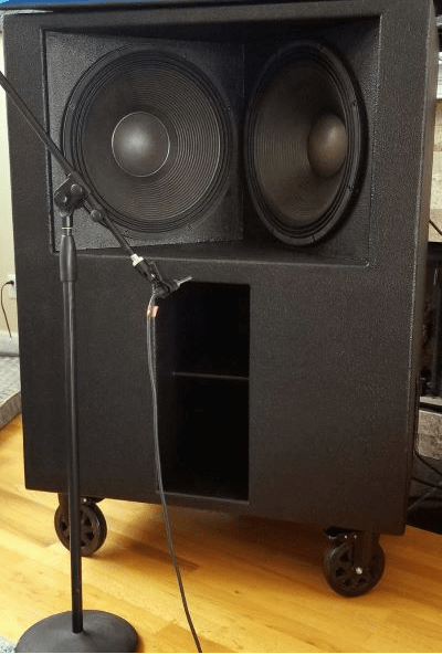

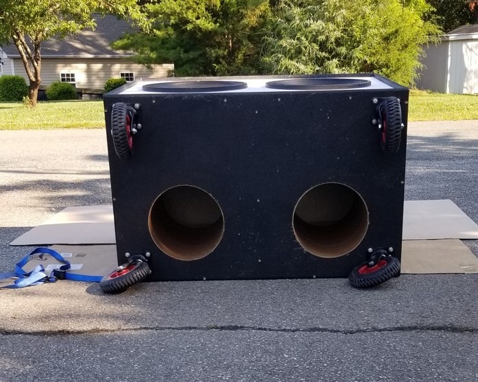

Yes, both are good ways to make opposed arrangements, however both do require some extra cabinet volume/size. Which is a bit of a bummer.You can use 45deg bouncers on the driver-pair or slot-load them. But I see this thread has become one for the beer lounge.

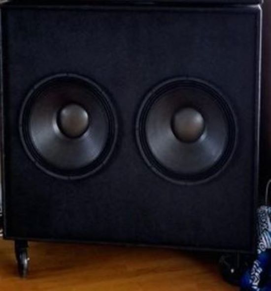

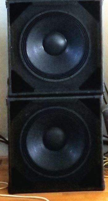

I've made both.
And two other versions of double 18"s ported.
Standard singles with corner ports I could stack,
and a big whooper of a double with downward firing ports.
And the last double 18, the first 18" subs I built, single sealed that could stack.
All of these used the same driver, the bms18n862.
All the ported were tuned from f-3 at 30Hz to f-3 at 25Hz, with close to the same port velocity.
As I got better at building the subs, i was able to keep getting a little lower than 30Hz from the starting standard ported with corner ports.
All have used steep 96dB/oct lin phase low passes at 100Hz....so nothing beyond sub frequencies to muddy up comparisons.
Best comparisons and measurement are always outdoors, that's a given imo.
But how they end up indoors is what counts most justly based on listening time. So far outdoor and indoor comparisons have essentialy been equal, after fiddling with indoor placement some. This is with regard to a single sub setup/stack only.
As said earlier in thread, it didn't take any time for me to realize the advantage of ported vs sealed, once sealed was EQ'ed to match the standard type ported boxes.
From then on, ported comparisons have been more about how the boxes felt, the visceral tactile feeling of the bass both steady state and transient.
Steady state, I haven't heard enough difference to think I could match any kind of blind test.
Transients are another story' The big single box with the downward ports has been the worst. I think good old standard corner ports , stacked, have been slightly the best. But not enough to forego the advantage of opposed vibration reduction found in the slot loaded or the 45 degree guy.
I know most will probably scoff at the 'empty beer can test' i floated for measuring transient impact..🙂
But honestly, i've found it to be a hell of a good objective measurement.
An empty Monster Energy drink can is best I've found....the aluminum is so thin and light, it doesn't take as much SPL to get movement.
Personally, how much the can moves at carefully matched SPL and distance, is a damn good measurement imo.
An aside....I've found multiple subs make a can dance in place, or maybe hover heading somewhere. Whereas a single sub, mainly moves the can in straight direction.
fwiw, a lot of anecdotal i know...
But i'll also be so bold as to say, at least outdoors, they are some of the best measuring subs i've seen, both by mic and beer can!!!! haha
i do like to experiment off of the beaten track...😀

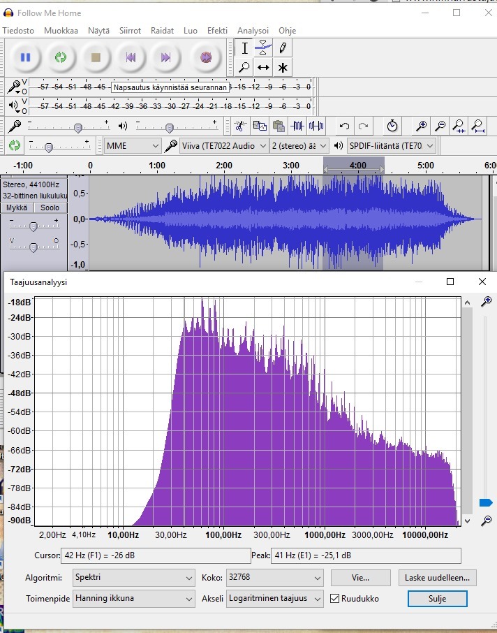

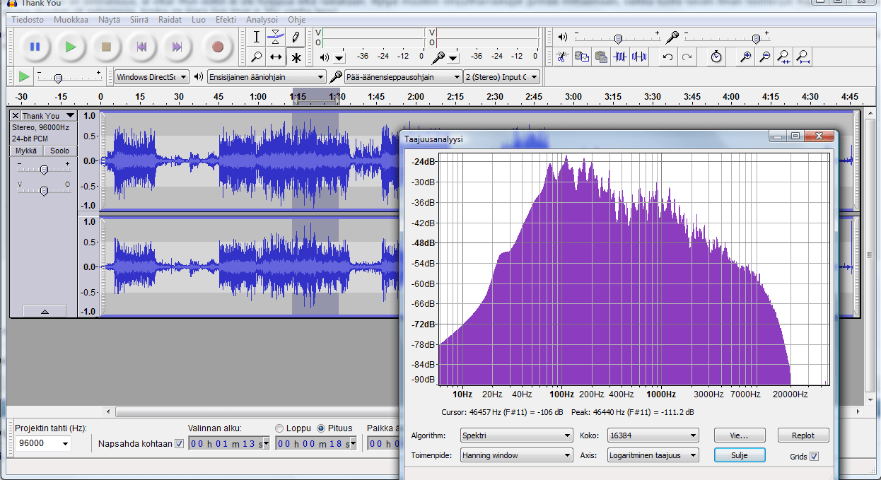

The graph shows good what's happening. You have a 6db peak at 70Hz. So you need the most energy there!The 25-100 Hz range had the highest levels for this particular recording. Even the 10-20 Hz range showed some very low-frequency rumble. If I deliberately select something electronic, the low-frequency register can be even higher in level and lower in frequency.
Then you have very low and loud bass in this track - that's more as in common music and goes down to 30Hz. Still in normal range.
You rumble is already down 20dB! It's normally a technical mistake to let it there but at -20dB it should not do too much harm.
At high frequencies you see a fall of above 1kHz, that sometimes starts later, depending on style.
So when you use 2 speakers in the same volume as one ported speaker - you have more SPL level at 70Hz and can not damage the speakers with 10-20Hz signals.

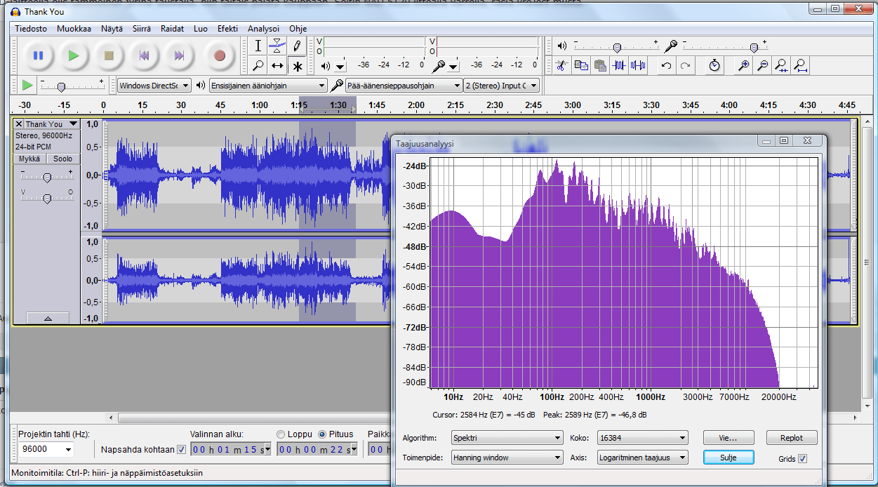

In 2012 I checked spectr, loudness and compression of some vinyls and CDs. I was digitizing vinyls with Audacity and tested 3 decks, 2 preamps and 4 cartridges too. With Audacity it was easy to apply rumble highpass.
A vinyl preamp without highpass is a killer for BR speakers! But luckily most hifi speakers in 1960-70s were closed boxes, also in studios (eg. Yamaha NS-1000 and most British monitors).

Follow me home is a very typical example. Peak at 60Hz (Kickdrum), 6 dB down at 40Hz (Bass) and not a lot below.
A deep tuned port ... does not give a lot of benefit here. But sounds good. So many manufacturer put port frequency at about 40Hz and even make a hump ... what doesn't sound good to me.

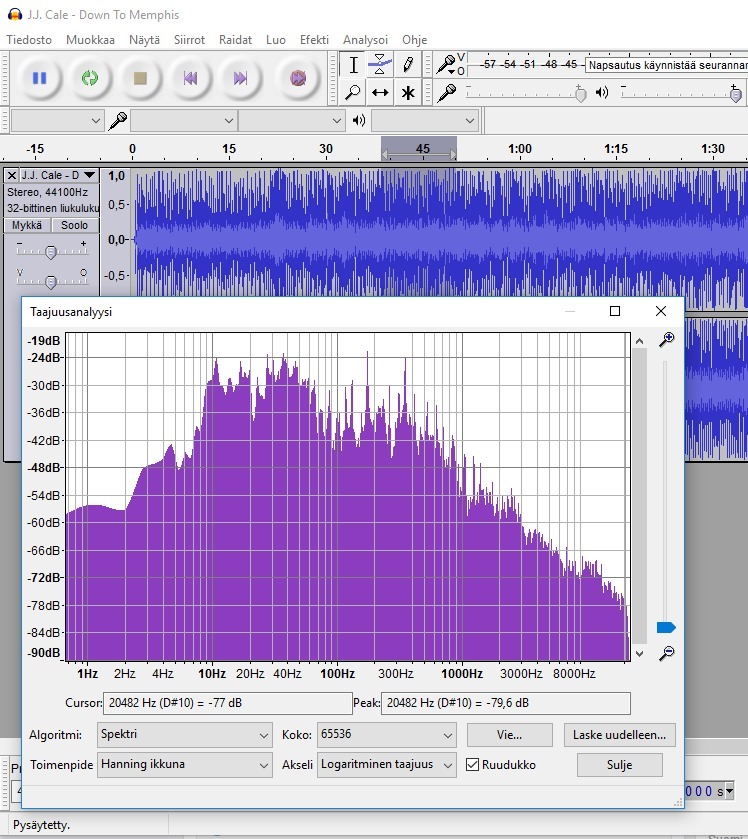

JJ Cale's Down to Memphis is a rarity on CDs, Roll On was released in 2009. We know that he was interested in equipment and knew a lot of recording/mixing process. I wish we could ask him why there's so much infrasonics left
https://en.wikipedia.org/wiki/J._J._Cale
Obviously this clip has different spectr

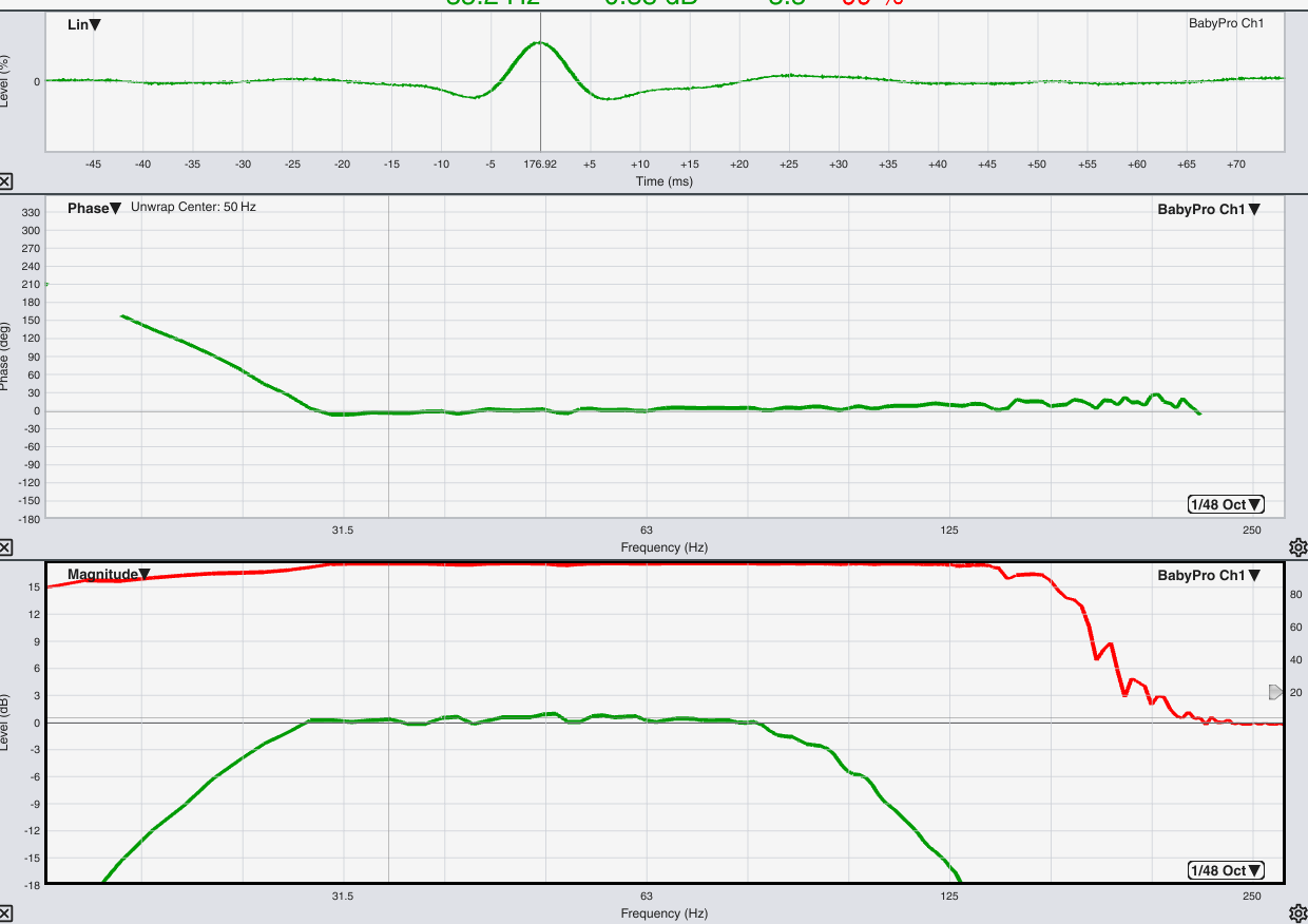

I like ported speakers to be tuned for maximally flat, then rolling off to f-3. (By f-6 a sub is over imo, who even cares if f-10 even exists lol.)
25Hz f-3 works for me. Over the years with the subs I've owned, as f-3 has moved from low/mid 40Hz to present 25Hz,
I've found more and more music has content at 30Hz than I might have believed.
I'd like to go lower just to see, buy my reality wall (which has a lot of freedom) says 25Hz is the limit.
Anyway, here's how I like to tune ported...my latest 45* version. Indoors close, ungated. Lin-phase 100Hz low pass, and min-phase EQs.
Has BW3rd order hpf which only lets me get f-3 to 26Hz lol
The room!By f-6 a sub is over imo, who even cares if f-10 even exists lol.

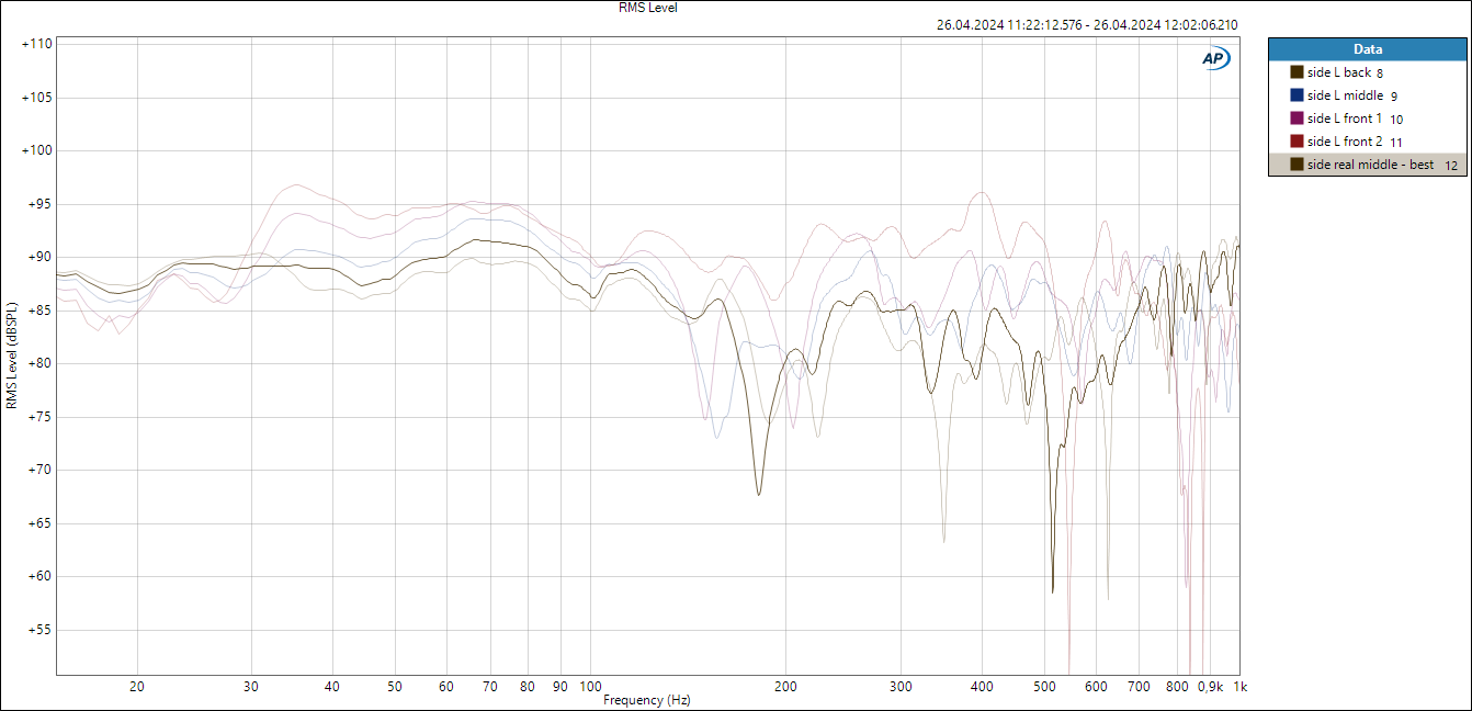

The slow falloff of a closed sub often fits the room - here some measurements of one of my prototypes in the room. Placed middle of the room length at the right side. This room is heavily dampened but still some basic room modes exist - normally. Middle position works extremely well.
This is a closed woofer with resonance frequency of 43Hz! It fits perfectly the room position and no boost at low frequencies is needed. FR post 20Hz.

The room!
Ime, there's always a few mic positions that can show strong modal < 40Hz. Personally, i can't count modes as valid low freq extension.
(Multi-sub wants to maximize and disperse modes to smooth response, as well as gain low extension. I want to minimize modes to smooth response and use few subs to keep transient capability as I've already ballyhoo-ed about)
Cabin gain i can see as real gain. But i've encountered that's often much more theoretical than not, unless very solid floor, wall, and ceiling construction.
Minimizing modes is always the goal! But they are still there in most circumstances and you preceive it as boost in frequency response (boomy bass), so I target it and integrate it with room EQ WHEN THEY ARE STABLE, at least in the listening area. When doing so I often need way less EQ to linearise closed woofers as i calculated. In this extreme situation of the measurements above I don't need any EQ and there are no narrow resonances in the room (1/24th smoothing).
