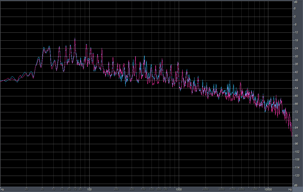

I'm constantly coming across statements that the Linkwitz Transform for sealed enclosures is a good option because the energy levels in the lower registers of music recordings are lower, giving you headroom to apply the correction.
I believe this is completely wrong. I analyzed a track I was listening to at the time (Tape Five - Grand Central - Slow Motion) with an FFT analyzer and found the following:
The 25-100 Hz range had the highest levels for this particular recording. Even the 10-20 Hz range showed some very low-frequency rumble. If I deliberately select something electronic, the low-frequency register can be even higher in level and lower in frequency.
Therefore, you need to pump a lot of watts to get those lower frequencies below Fb. For example, you might need over 50 watts for a 90 dB/W woofer to reach 96 dB SPL below Fb, and you'll reach Xmax very quickly. There is no headroom in the recording. If you operate your woofer close to Xmax, you'll negatively affect the rest of the reproduced range, as motor (force factor BL) and suspension nonlinearities are real and more noticeable than your typical harmonic distortion.
if i use an ltx to move F3 from 50Hz to 25Hz, that equates to 3dB more output at 50Hz
your telling me that you cannot turn your bass knob up 3dB without destroying your amps and speakers?
Just keep in mind that by doing this you now also increase the power at 25 Hz 16 fold and the excursion fourfold. Whether this is fine or not can't be generally decided and depends a lot on the program material, the speakers used and your expectations.
