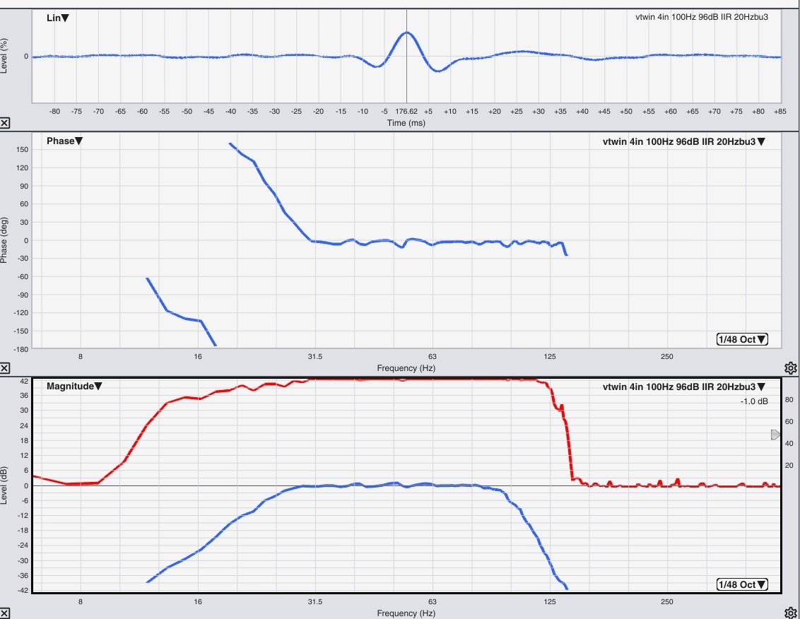

ah, i just saw the impulse response with pre echo but that must be from the lin phase low pass xover? as you say, the high pass is minimum phase so no pre echo from that. The low pass on the graph is about the same slope as the high pass? (you mentioned 96dB/ovtave)
Yes, I think you're right...that the pre-echo is low-passed induced due to not having any commentary xover offset.
i watch the dip in the sub's impulse response before it's peak go away when the rest of the speaker is added.
Here's a quick example with just the next driver up, covering 100-250Hz, when added to the sub.
Red sub, blue woofer, and black their summation...if not obvious to others.
The black summation impulse...the left side dip is already a little less than the right side dip....with just the addition of the 100-250Hz woofer.
As sections are added, mid, then HF, VHF....I watch the left side dip melt into flatness.
Thanks for pointing out that the look of the slopes on the transfer function I posted, didn't seem right....
Yes, the low pass should be 96dB oct, but I can see it was falling short of that.
I'm learning a new FIR generator and goofed..
Here's sub redone...same 96 dB/oct lin lpf, and same 20Hz IIR bu3 hpf
Have to retune speaker and check for further goofs...only got to adding woofer so far, like above example.
Can/will, show full speaker with sub for impulse when done.

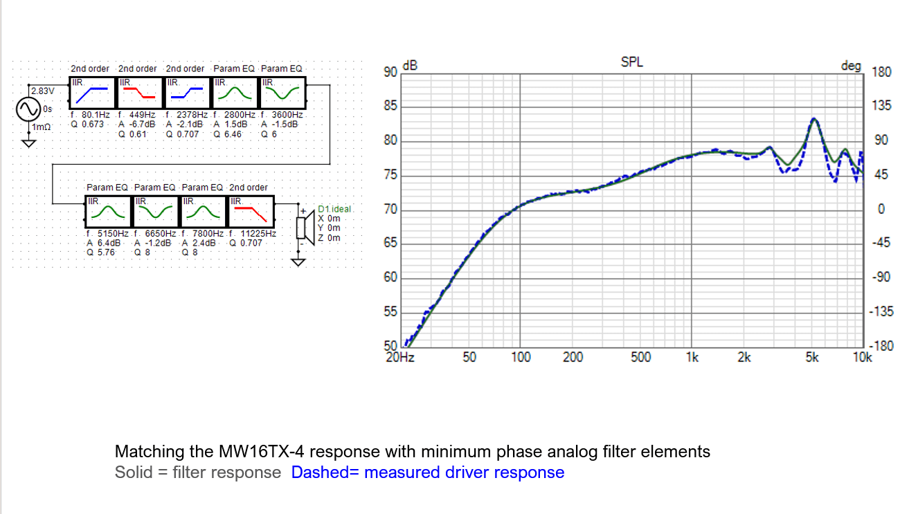

I really believe we must have some kind of miscommunication or misunderstanding about the term "Minimum Phase".Loudspeakers are in no case minimum phase !

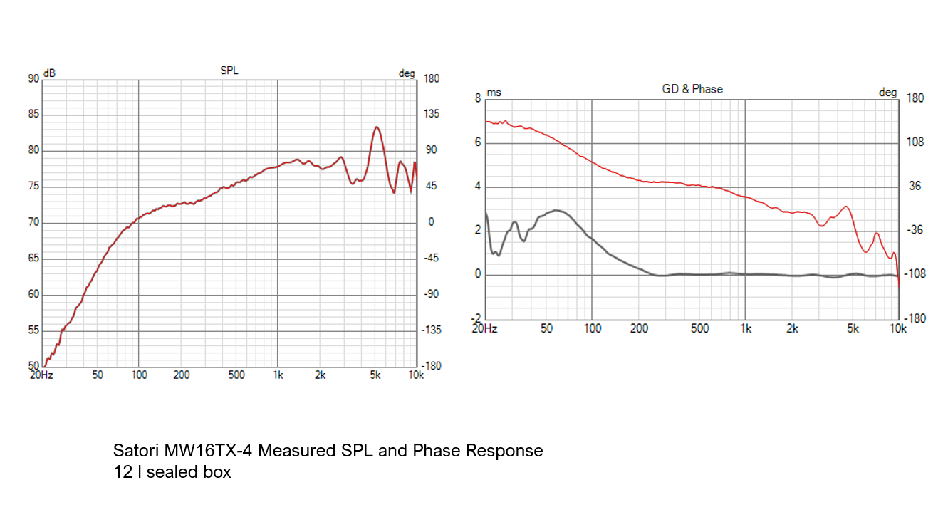

To demonstrate the point in a practical way, I took the measured response of a driver I have, Satori MW16TX-4. I measured the frequency response, capturing both magnitude and phase.
Next I used analog filter elements, which are minimum phase, to mimic the driver's response as closely as I could. The resulting filter is made up entirely of minimum phase elements.
If we compare the magnitude and phase response of the driver and the filter, it is clear that they are very close, and the difference is insignificant for any kind of design purpose. If the driver had a phase response which was drastically different than the filter phase, we could conclude that the driver was not minimum phase. But this is not the case. The driver follows the minimum phase response very closely. So from a practical standpoint, this driver is minimum phase.
Perhaps you mean something different by the term "minimum phase" ?

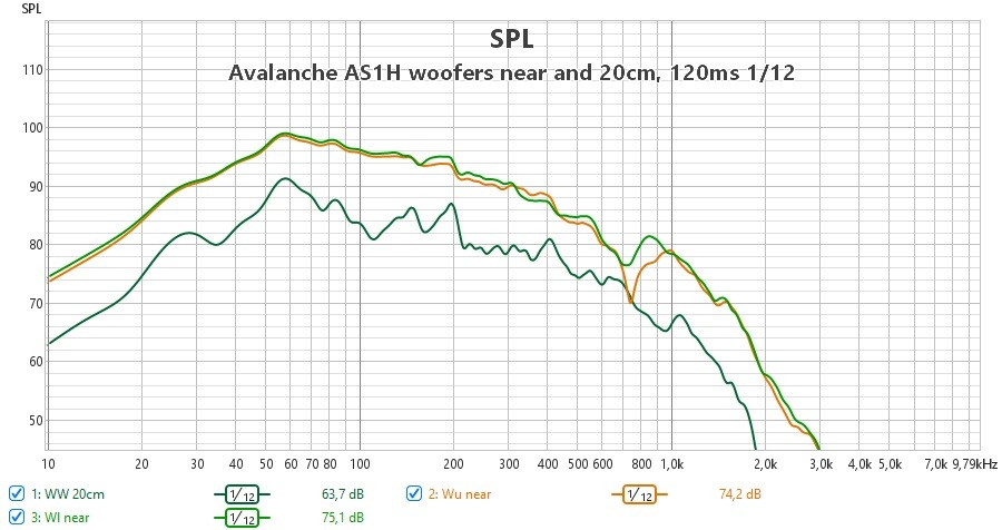

I have a pair of 3-way towers with double woofers. Neardield measurement tells that vertical standing wave in the box makes difference around 800Hz. Insignificant in 3-way...Hello. I am going to build 2 sealed bass cabinets with 2x 10" Seas drivers. They should have 25-40 liters each. What is best solution; seperate chambers or back to back ( vibrations canselling) Today my speakers are Mirage OM6 with dual 8" back to back. The other solution is to put the one in the front high in the cabinet and the one in the back low in the cabinet like Mirage M1. Should I separete the woofers in each chamber or should the play in the same? Could the cabinet be smaller when they share chamber?

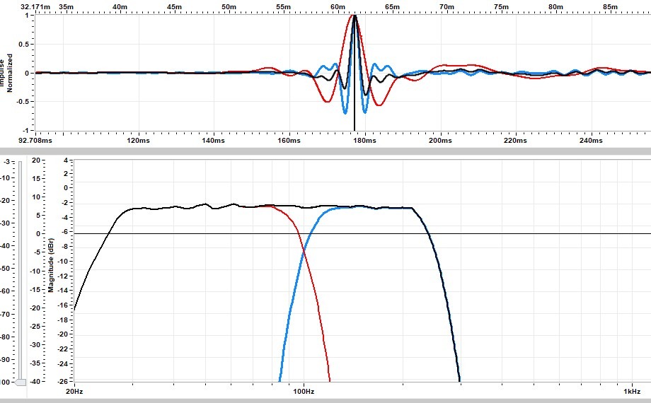

Ok, following up on info i said I'd provide in #405.....in discussion of pre-echo potential.
Here are the impulse responses from each section of a 5-way speaker.
All are acoustic measurements, made close to the speaker indoors.
Each clearly has a lot of dip below zero before it's impulse peak. (and after)
Xovers @100, 250, 750, & 4000Hz...all linear phase 96dB/oct.
Here is the full speaker's impulse in Black, iow all impulses summed together. (along with the sub's impulse again, for reference),
System impulse kinda says it all, i think..
