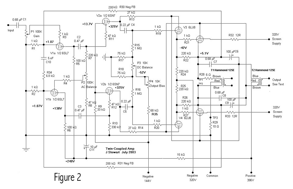

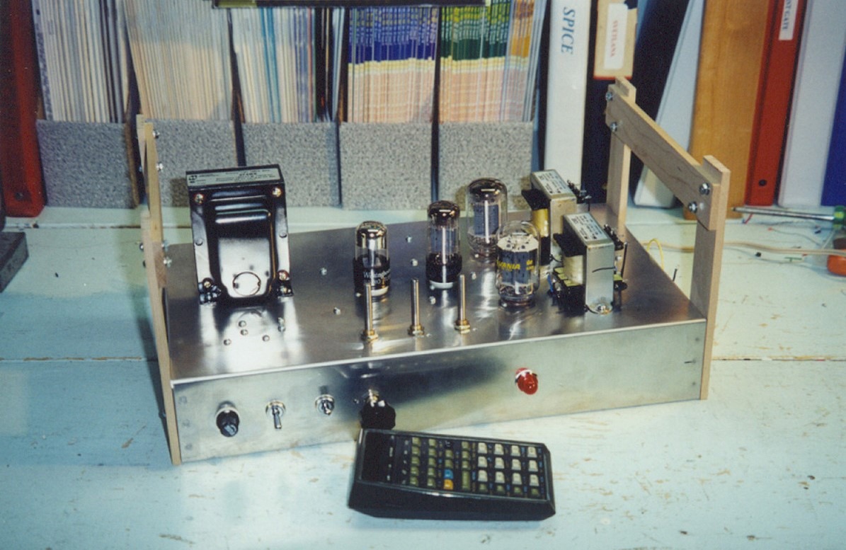

I built two versions of Crowhurst's Twin Coupled Amp. It is a way to get a poor man's version of a McIntosh.if Norman Crowhurst were here today, he'd be very elated....
Both built in the past 25 yrs for experimental & measurement experiments. The first is a PP output of 6LU8s.

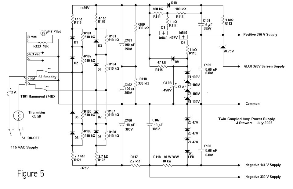

The triode in each forms a CF driver for the pentode. The amp has a SS regulated B+ with some delay built in. 400V B+ on the plates.
300V on the screens, the drivers & CFs are bootstrapped just as in the McIntosh. The OPTs are simply a pair of Hammond 125E's.
The front end is a 2-stage diff-amp, 6SL7 & 6SN7, simple resistive tails to -150, regulated. Switchable to Crowhurst's front end.
The wooden end pieces are not there for beauty but rather a convenient stand as changes & measurements are taken.

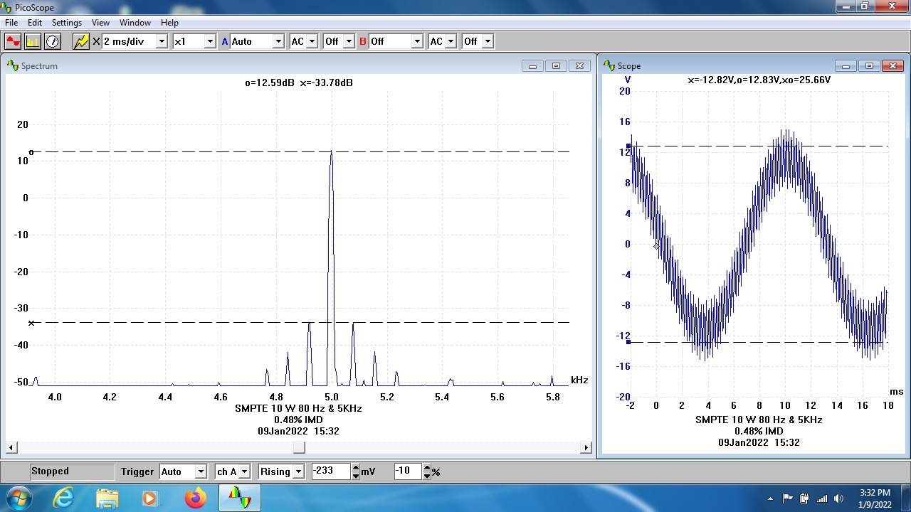

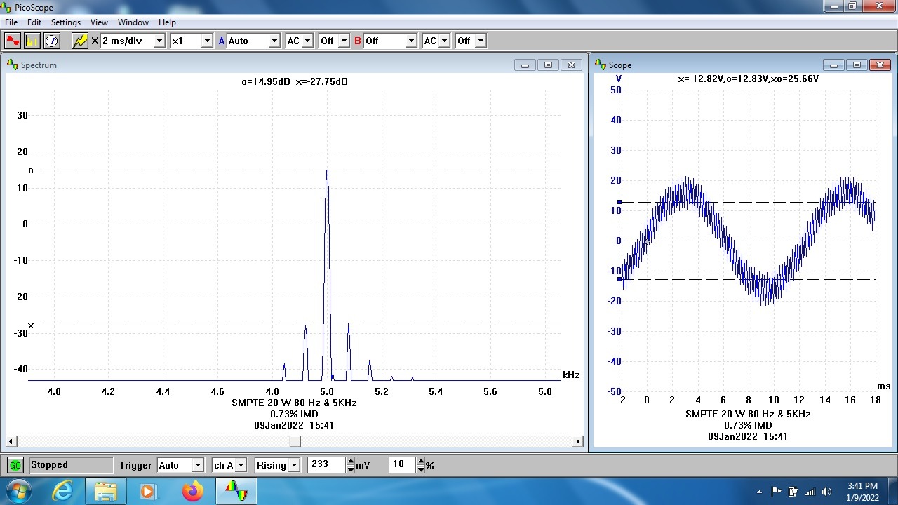

About 35 watts at clipping. And very good test results, Harmonic Distortion, IMD & so on. Better than most would expect.

Can you show a schematic?I built two versions of Crowhurst's Twin Coupled Amp. It is a way to get a poor man's version of a McIntosh.
Not sure how you connect a Hammond 125E for a McIntosh / Crowhurst circuit ... which requires separate Anode & Cathode windings for each output tube (4 identical windings) ... while 125E has a single centre-tapped primary and is only rated at 15W 150Hz.

i have Norman Crowhurst to thank for my tube education, and of course the tube gurus here and they are many....I built two versions of Crowhurst's Twin Coupled Amp. It is a way to get a poor man's version of a McIntosh.

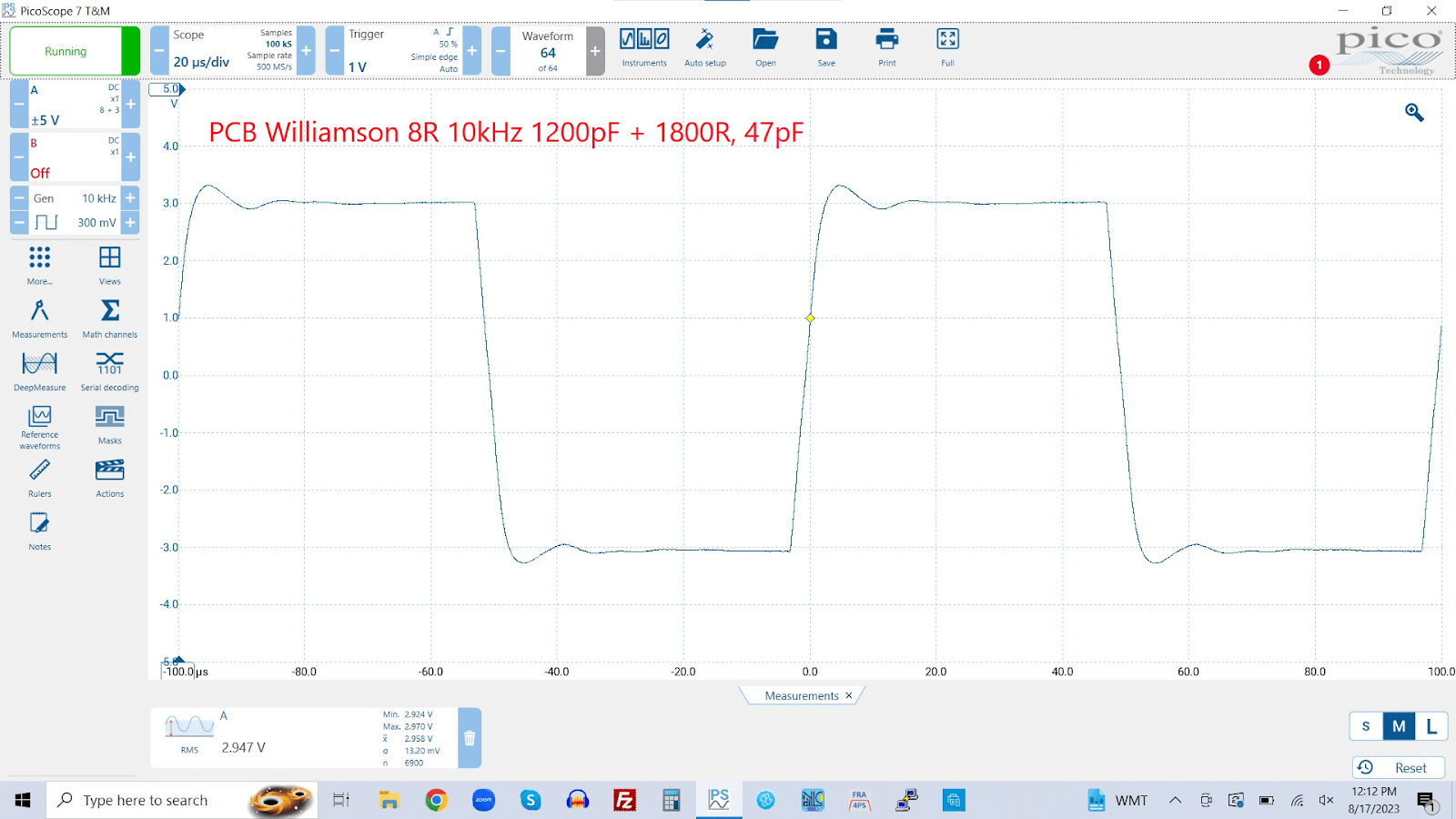

My current Williamsons, which use a Heyboer copy of the Peerless S-265-Q, will not break into HF oscillation either unloaded, with .22uF across the load or with a .047 capacitive load only. That's not bad. It could possibly be better but I'm still learning about phase margins and how to identify and improve them. In any event, I don't think they'll eat my ProAcs. ;-)
If you modify a vintage Williamson using Dave Gillespie's instructions over at Audiokarma, you can be assured that the amp is very, very stable and performs as well as that amp possibly can. I recently sent Dave a Heyboer/Peerless S-265-Q for testing and he gave me some tips for getting the best performance from it. He also felt that it was an excellent copy, with only "incrementally less" performance than the original.
He's currently working on an Audiokarma thread about the Heathkit W5 which will include the two Peerless outputs originally designed for that amp as well as information on the original Peerless S-265-Q and the Heyboer copy. Since W5's are still plentiful on the second-hand market I imagine it will be of great interest to DIYers.
You can also always add a zobel network across the output for safety, but it can affect performance and I prefer to do without it if possible.

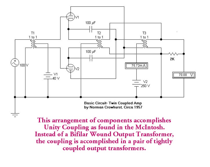

The Crowhurst Twin-Coupled amp uses two identical output transformers. Not quite the same as McIntosh's "Unity Coupling" but it's similar in purpose.
https://www.pearl-hifi.com/06_Lit_Archive/02_PEARL_Arch/Vol_01/Sec_03/190_Twin-coupled_Amplifier.pdf
This project was originally published in the Volume 35, Issue 8 of AudioXpress magazine in August of 2004.
One of the schematics here shows a simplified version of Crowhurst's idea.
The transformer primaries in this case are tied together using a pair of 100 microF electrolytics.
In all of my projects I tried whenever to use off-the-shelf parts so that anyone could do the build at reasonable cost.
This often requires some compromises. The H125E's do not have ratio's suitable for secondary parallel operation.
To get the loadline required it was necessary to use series connexions. The result is DF of about 3.
The attached Amp schematic uses the Crowhurst front end. As built, it is switchable to full differential.
Money would have bought the correct OPT's. But I already had the data I was looking for.
This & several other projects are all experimental. I moved on.😀

it was a low cost solution to the McIntosh..The Crowhurst Twin-Coupled amp uses two identical output transformers. Not quite the same as McIntosh's "Unity Coupling" but it's similar in purpose.

Thanks for this grovergardner & jhstewart9. I have a Crowhurst book which mentions his Twin-Coupled amp but the circuit shown led me to think he was describing the McIntosh.The Crowhurst Twin-Coupled amp uses two identical output transformers. Not quite the same as McIntosh's "Unity Coupling" but it's similar in purpose.
It has the same cons as the McIntosh but is certainly worthy of further study.
Thanks for this Grover. Does this mean you found some instability with other loads? In my previous life, Williamson (in)stability was of great interest to me. 🙂My current Williamsons, which use a Heyboer copy of the Peerless S-265-Q, will not break into HF oscillation either unloaded, with .22uF across the load or with a .047 capacitive load only. That's not bad. It could possibly be better but I'm still learning about phase margins and how to identify and improve them.
If a Zobel 'affected performance' it would certainly have affected the sound. I would have it in. Marginal stability is one of the things proven to make amps 'sound different'. 😱You can also always add a zobel network across the output for safety, but it can affect performance and I prefer to do without it if possible.
I can't push the capacitance too high, loaded or unloaded, or it will oscillate, but as it is I think it's pretty solid. Dave Gillespie suggested a fairly steep step filter to use with the Heyboer/Peerless and it works pretty well, given that I'm not yet skilled enough to do the kind of fine-grained stabilizing he is able to do. They sound much better than with the stock compensation networks I was using, I can tell you that. Here's a 10kHz square wave at 8 ohms @ 1 watt:
In my experience a zobel can affect the sound, but it can also cure a lot of ills. ;-) I'll have to experiment with one on these amps.
My Picoscope has the ability to pinpoint phase shifts and margins up to 1mHz, but I need to learn what to do with that information. ;-)
