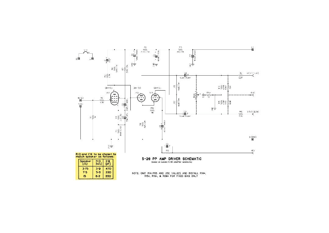

Why are people still touting the Mullard 5-20 circuit?
It is the year 2023 and I still think that the 5-20 is one of the best capable amplifiers out there that you can easily get parts for and is relatively simple and very powerfull.
I only have 2 main issues with the original. High input gain and the "weedy" driver stage for the EL34s.
In an effort to solve these problems I have kept the original EF86 designed a biasing circuit arround it in the cathode and made it so it accepts a +4dBu input level with the original EF86 and the driver stage was remodelled with a ECC81 a current source in the cathodes and grid biased EL34s for that extra botom end safety margin (with auto biasing circuit for them too)
When you use PROPER iron, and by that I mean the polish TTG Toroidy transformers which are toroidal sintered powder core transformers that have a frequency response of 8Hz to 54kHz -3dB this thing beats most transistor amplifiers in sounding basically like a refference amplifier. (extremely sterile with stern bass response). With the incredibelly high NFB its basically only as tube sounding as the EF86 itself is. And with it modified to take a +4dBu signal thats very little.
Stabillity wise I only had issues at the lowest of the low frequencies 5-4Hz due to the transformer being far better than the circuit originally was designed for.
I could let loose the anode RC compensation and this thing would go 10Hz-50kHz literary flat 20W RMS output power.
To adress some misguided opinions here.
The original amplifier was noisy because the anode resistor of the EF86 was likely really done for. With brand new ROHM resistors this thing was dead silent with the original gain setting (grounded input)
The driver is quite sub par. But not bad enough that it would impede performance hugely unless driven into absolute extremes. Adding in very large cappacitors into the cathodes of the final stage helped the low frequency response so it wouldnt get into gain limitations in the driver, however I found that grid biasing wasnt going to be an issue to mod in so I have done away with the cathode biasing and added in my automatic biasing circuit that sets grid voltage to achieve a set cathode current.
Even if I were to let the 12AX7 live in my ampifier I dont think it would have cause much trouble. The thing is that the EL34s are quite easy to drive tubes and they really dont mind being driven from such a high impedance source. Even if it is a little non ideal.
I really like the topology used in the 5-20 and assuming that we can expand on it with todays knowledge and components (Transistor voltage regulators for each stage) we can make it perform more like a powerful amplifier that has no distinctive sounding compared to a refference amplifier. Quite impressive that we can achieve such parameters with devices designed more than half a century ago passing sound, with transistors just assisting the operation.

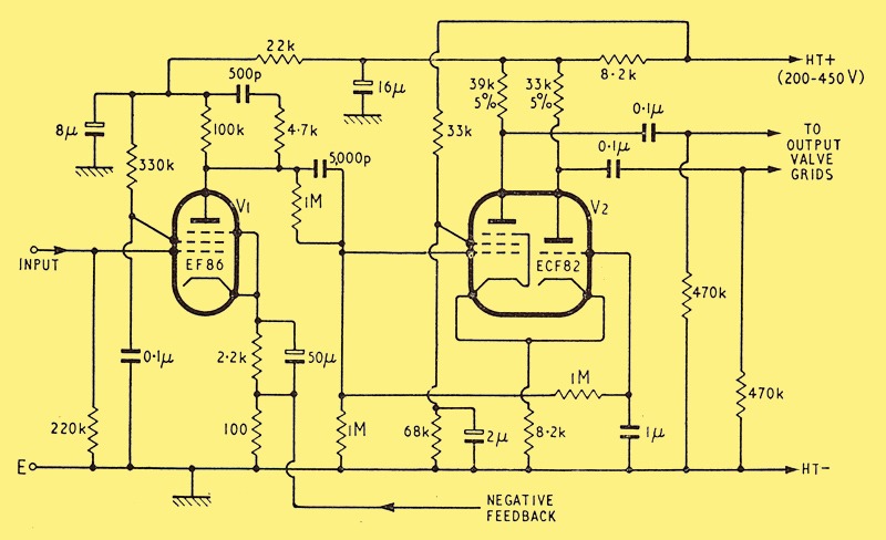

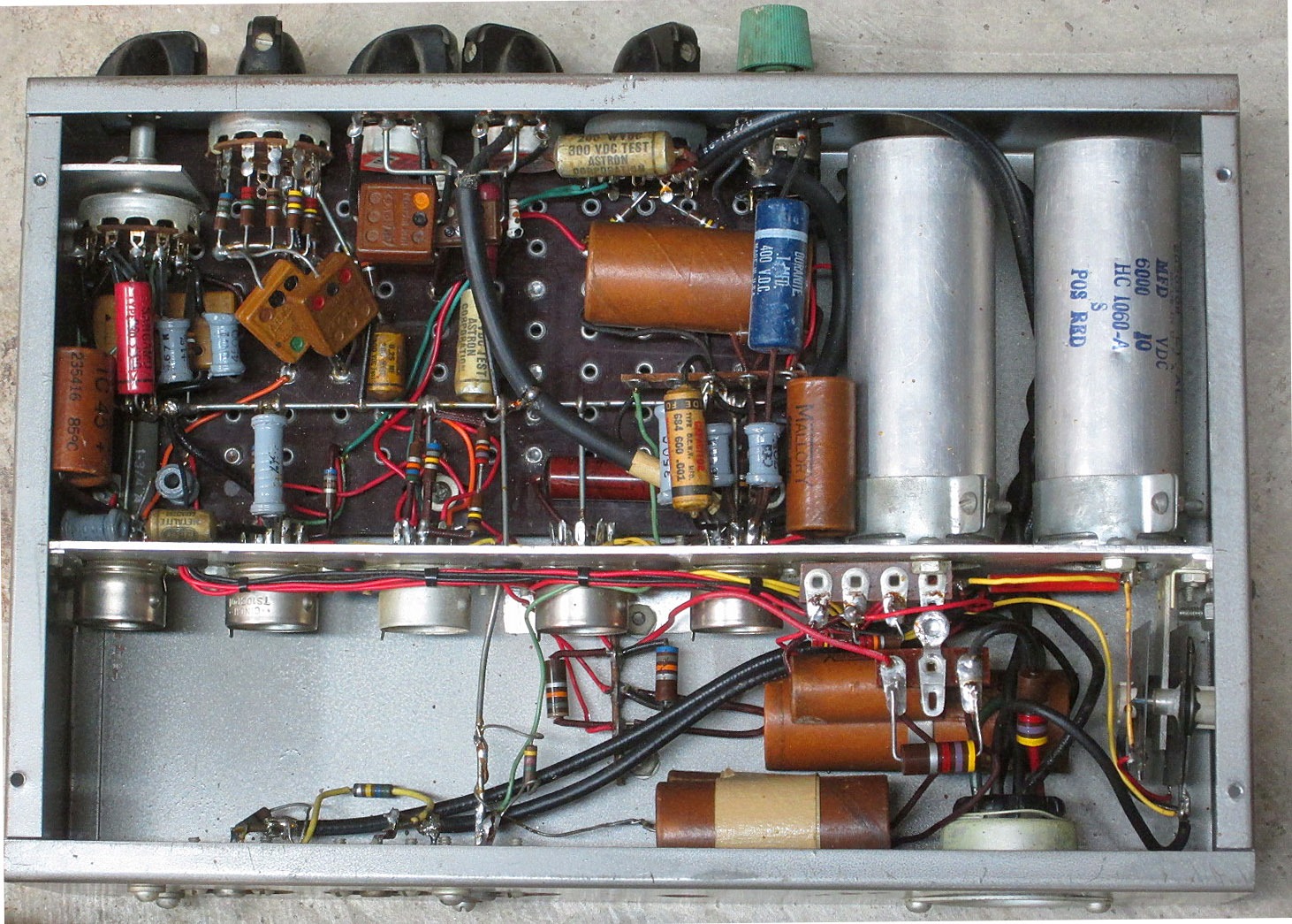

In my fossilized opinion, the Mullard 5-10 & 5-20 are bullet proof circuits when carefully built,
without dry solder joints. If the gain is too high it is easy to rewire the EF86 / Z729 for triode operation.
Then adjust the NFB to suit. If there is a noise problem in the front end, stuff in another EF86.
Or start looking for a noisy resister.

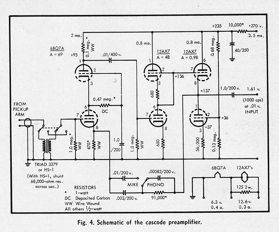

The fossils like me here on DIY had more serious noise challenges to deal with,
The signal from a vinyl player thru a magnetic pickup is usually mVolts.
But many solutions were found.

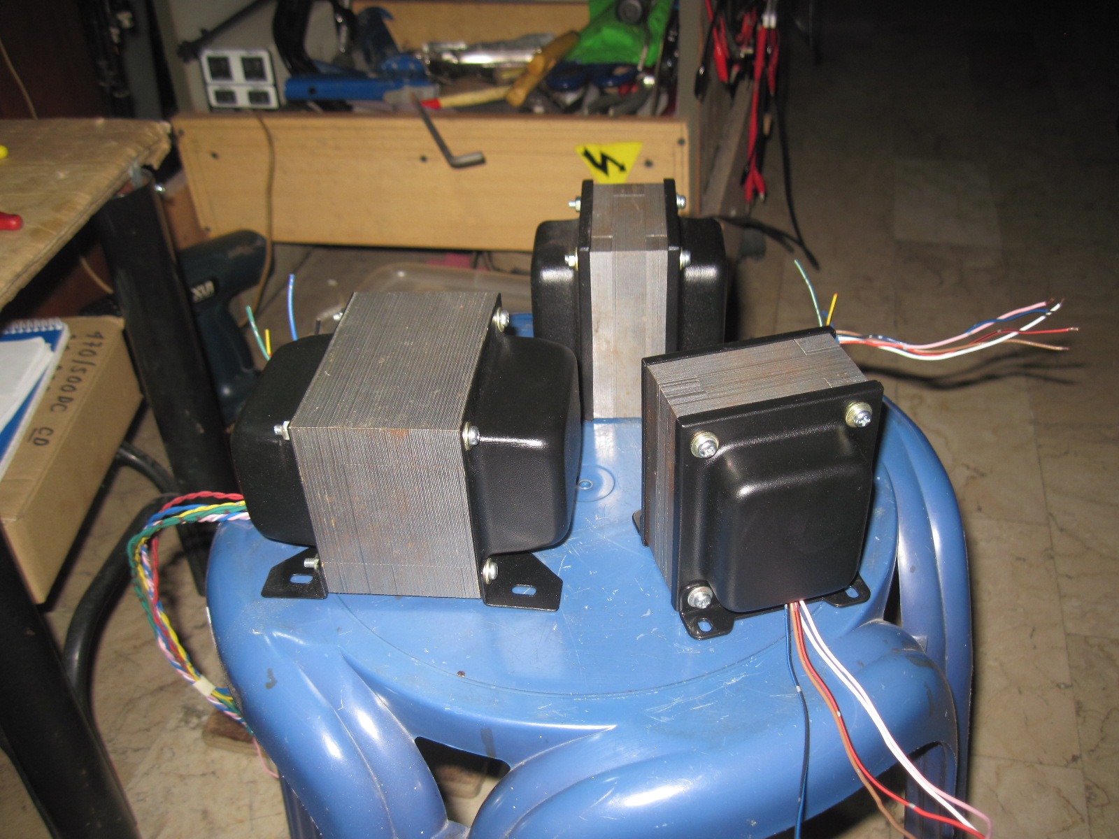

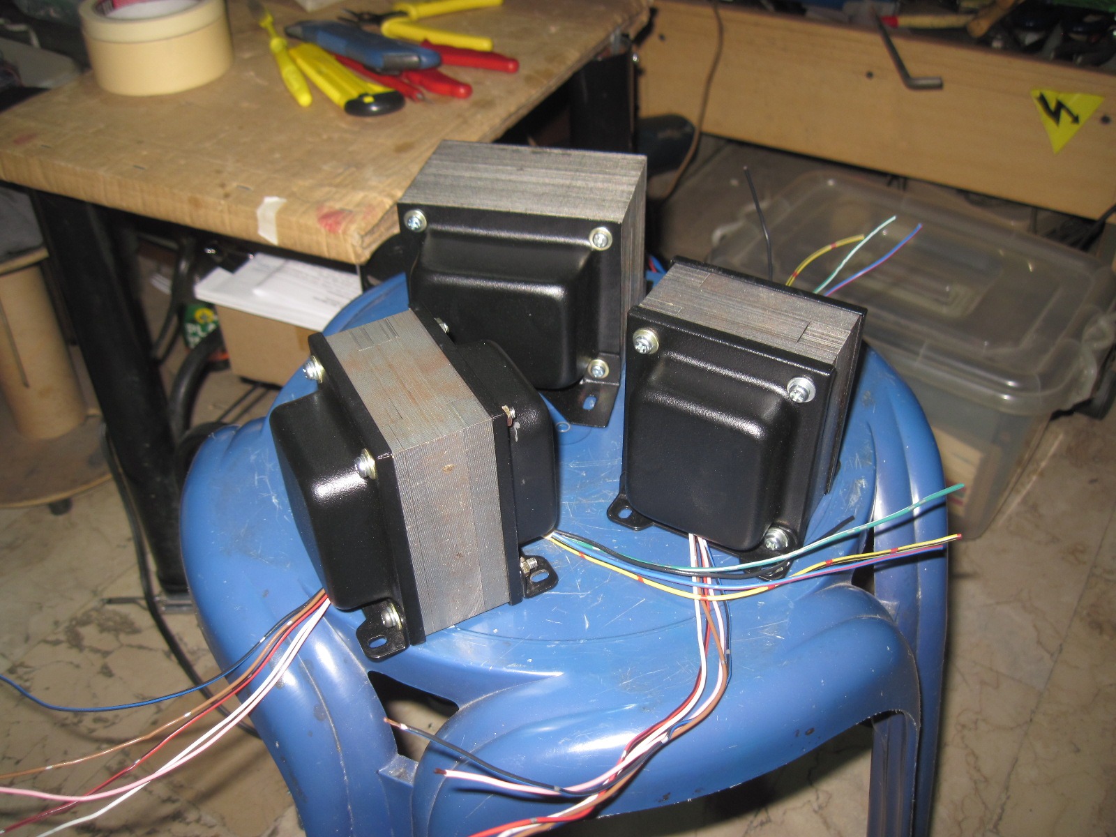

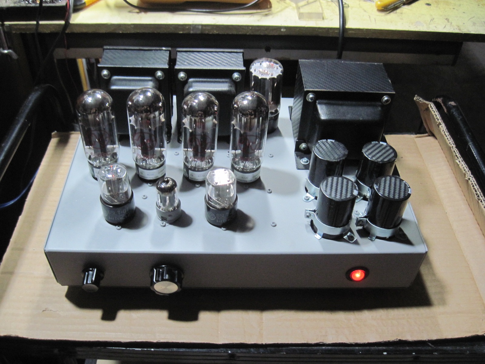

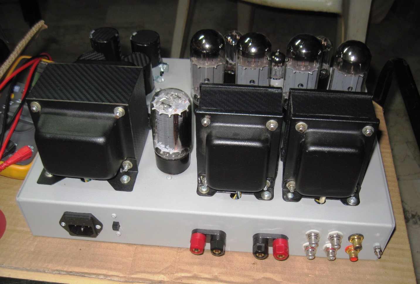

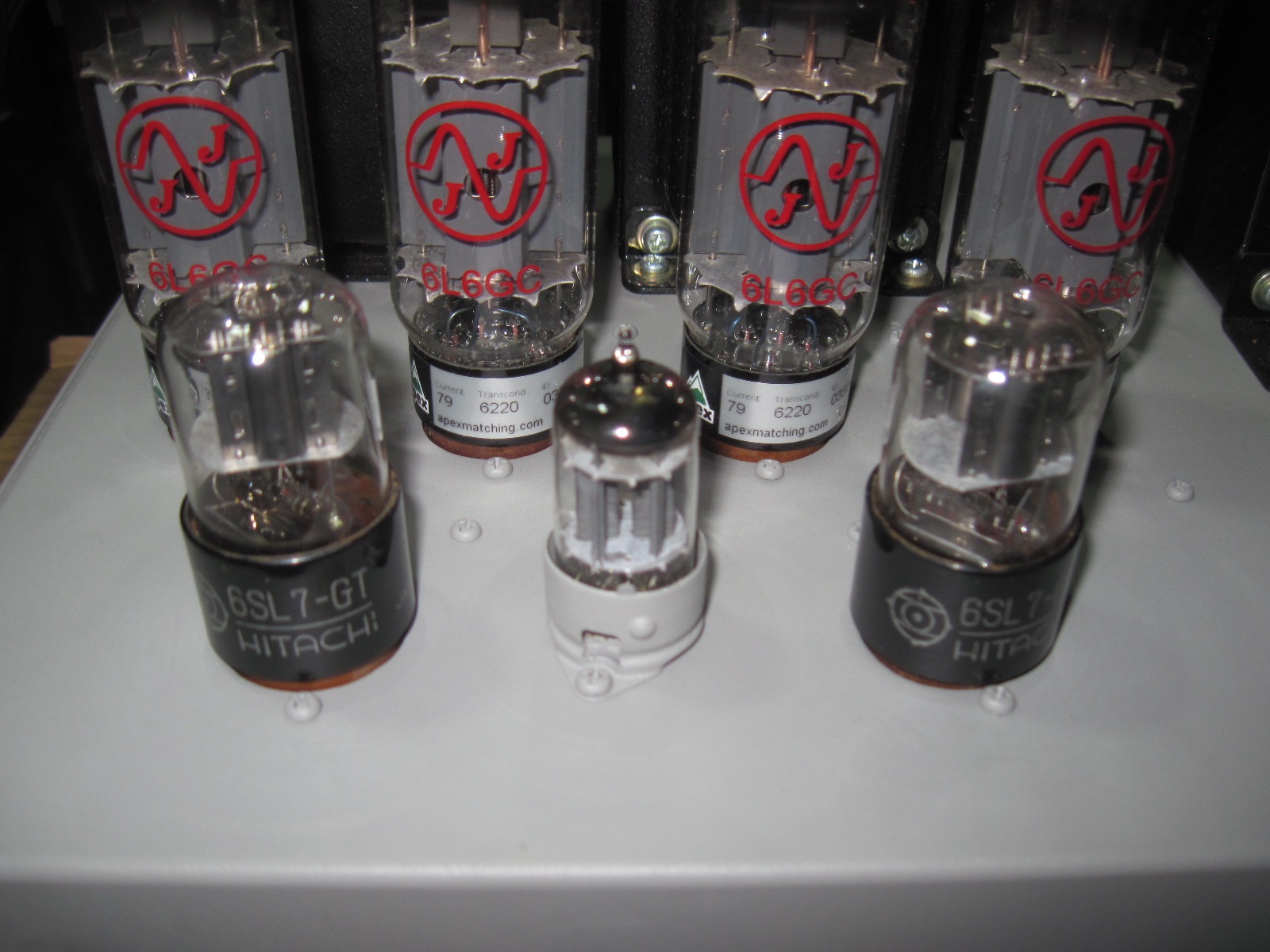

my best implementation of the Mulard520 had the 5814 in front as voltage amp, the 6SL7 in ltp and JJ6L6gc output tubes, my client was very happy and i am happy for him, the amp is now in Australia and making good music...
btw, the JJ's were really matched in bias at 22.6x vdc, individual cathode bias resistors, how close can you get?
below is the said amp, all irons that i used were all designed and built my me....

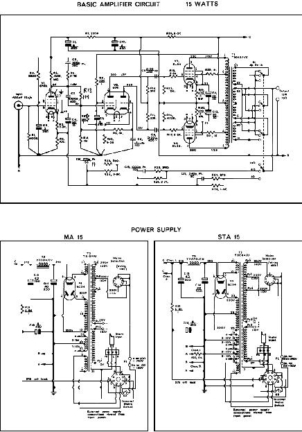

On the topic of Radfords, the Radford MA15 Mk2 amplifier design was described in detail in HiFi News 1962 in 4 parts by Bailey and Radford. Design is based on the Mullard 20W amp from 1955, and the article makes comment on the Williamson and provides some good insight in to extending high frequency performance. The Williamson output transformer was described as having "immense proportions" to achieve low phase shift at low frequencies, and the high frequency shunt resonance was too low "to provide a gradual roll-off in the forward gain" before OT resonance interaction. And although core and winding advances by 1962 allowed a more economic transformer to be made, the MA15 Mk2 still required a special and custom output transformer with tuned feedback networks in order to achieve the stability requirements, especially as negative feedback was increased to 27dB. So no practical way to clone that amp nowadays. The MA15 also added LF and HF step networks to manage its feedback level back to 20dB or so at bass and treble frequencies, so used the same mechanisms like the 'new' Williamson 1949 circuit for HF step, and the more commonly used LF step in the 1950's to improve LF stability margin.
