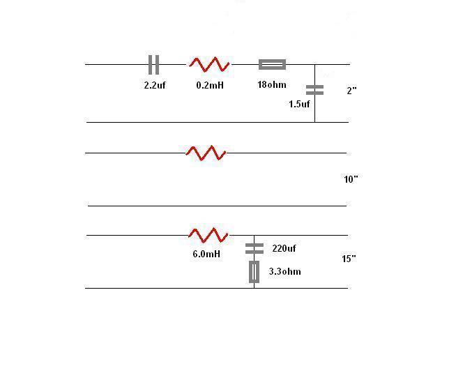

That doesn't stop the diy crowd but I believe the majority of the time DIYers are trying to recreate an expensive ideal speaker from existing experiences (regular box speakers) or they build dipole open baffles because they have the romance of simplicity and are extremely easy to build (or at least a basic one is). Dipoles OB's appeal because they are fashionable at the moment (along with constant directivity waveguides for good reason) easy to build and come with the promise of boxless presentation. Dipole = promise of imagined Electrostatic like presentation on the cheap. Cheap and easy to start (low DIY skills required, easy to fettle), still fairly exotic, apparently easy to build = lots of people having a go.

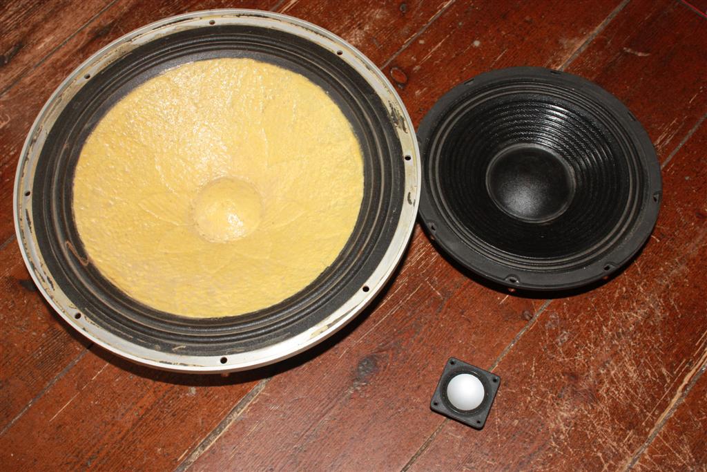

For an omni what drive units do you use?
