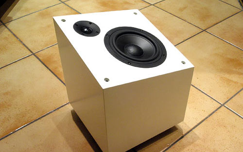

So, it's essentially an upward firing full range driver in a very short cabinet near the ground or is there some magic inside there?
no magic whatsoever, in it's basic form it was that simple, pure psychoacoustics
Well, that is certainly easy to try and I should have a working, albeit rudimentary prototype tomorrow.
It's going to be a 2 way because those are the spare drivers I have on hand at the moment, probably a little closer to some other pictures in that thread that show the small cube with the angled top.
Edit: like this one.
I'm very, very curious to do some A/B testing so that I can quantify what I think is happening versus what's happening scientifically.
Curse you Graaf, I'm going to have to move one of my couches!
yeah, the Carlsson-like Audio Pro, actually Carlsson once offered a model very much like fostex flooder - the Sonab V1
