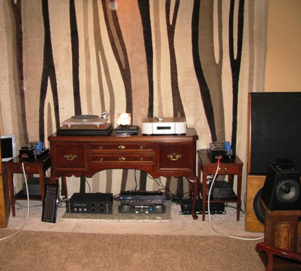

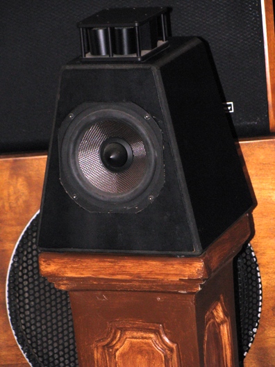

Correct-o-mundo (American slang for "you are correct". Perhaps used by others as well). Check out this speaker - which I got to listen to this past weekend for several hours at the Nashville Audio Society meet. I'm not trying to push these speakers down anyone's throat - simply agreeing with your statement.
According to their manufacturer (High Emotion Audio) Pyra Bella 7 - Products - High Emotion Audio these speakers have been used in studies at Vanderbilt (a medical university) and Belmont (a music university) in studies about acoustic neural response primarily due to the very fast response of the tweeter.
But guess what? They also happen to be omni drivers. Annnnnnd are being used in some of the local recording studios. Of course Nashville being the home base and recording haven (hmmmm heaven) for many Country and Western artist I'm not sure if that is a positive endorsement for many of you.
Me? I'm a fan of omni - and use my omni speakers often. Buuuut I also have some Fostex 167 full rangers and have owned many flavors of "box" speakers in the past - so I DO know the difference and what I prefer to listen to given my desires at the time. I'm also a fan of Country and Western - so that there juz goes ta show ya - 😀😀😀

If I am not missing something, these speakers are not omni (360° 20 to 20000). The tweeter must be bi/dipolar, and the boomer mono.
But as you have been there, how do they sound ? Are their claims justificated ?
The tweeter is dipole and there is a passive radiator on the rear of the speaker that matches the 6.5 inch driver.
These were crossed over with stereo sub-woofers @ 80 Hz.
A very nice speaker - one of the best I have listened to. vertical dispersion is limited - I would guess about 20 or 30 degrees - so placement at ear level height is important.
The tweeters are very efficient so lots of dynamics.

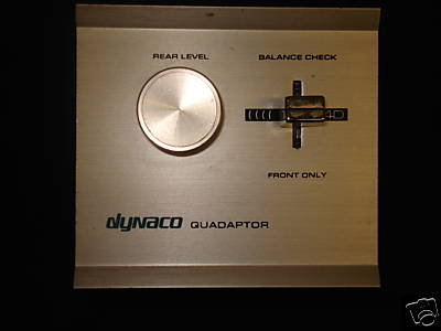

One interesting way to recreate a spacious sound in an average listening room is to place a third speaker behind the listening position, wired from the two stereo + (positive) connections, one + to each of the third speakers terminals.
This results in only L/R difference information coming from the "phantom" speaker.
Dynaquad! I think this method was even described in The Whole Earth Catalog.
The device that inspired my name!
Jez - can you even get that mag anymore? I think the last one I had was from around 1970......
