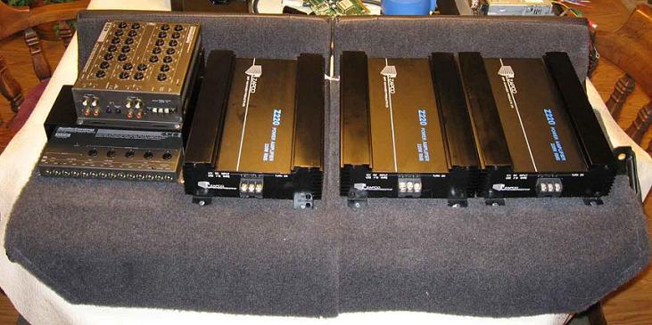

Here are the three Zapco Z220's I'm putting into my 3000GTVR4. I did this this week, by removing the upholstery on the seat back, and reinforcing the seat back with galvaneel >>> which is very easy to jig saw).
I used SS pop rivets to mount the plate, then used hot melt to attach the carpet back down. Finally I laid out the first 2 Z220's on the reinforcement on the passenger side rear seat back, and used SS rivets to attach them to the reinforced seat back. (stainless rivets are very hard to drill...and these amps would not be easy pickings for a thief.
At any rate on the drivers seat back, I bent up a galvaneel pedestal to mount the Audiocontrol 4XS (bottom), and the EQQ (top). Truly an old school setup, as these pieces were the heart of an older competition system I had built.
I have 4 Z220's, and was going to use 2 subs (BA 10.5LF), but decided to go w/just one. Next up is the custom cabling to made the shortest possible cable runs.
Any ground loop noise abatement will be mounted under the galvaneel plate by carefully cutting a space in the PUR cushion. Shouldn't miss it. In the 16 years we've owned it, someone has been in the rear seat maybe 20 times?

lgvenable said:Here are the three Zapco Z220's I'm putting into my 3000GTVR4. I did this this week, by removing the upholstery on the seat back, and reinforcing the seat back with galvaneel >>> which is very easy to jig saw).
