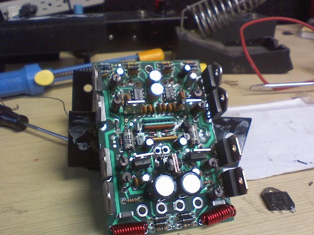

It may have the same exact audio circuit design, but the board layout is totally different. There is an aluminum tunnel going right down the middle so the transistors are going to be mounted on either side of it. Kind of like the denon dca 800 car amp and several of the home amps. Or even the kenwood kac 921. Surely more reliable than the non fan cooled models. I had a pma 2175 and that thing was ultra powerful, I managed to somehow fry it though. 🙁 I never had a chance to get it repaired, couldn't find the correct parts and was too busy with work back then.

ppia600 said:It may have the same exact audio circuit design, but the board layout is totally different.

That's nice to know. If they bothered to redo the board, I'm sure they would have revamped the problematic circuit as well. Looks like another item to add to the collection!

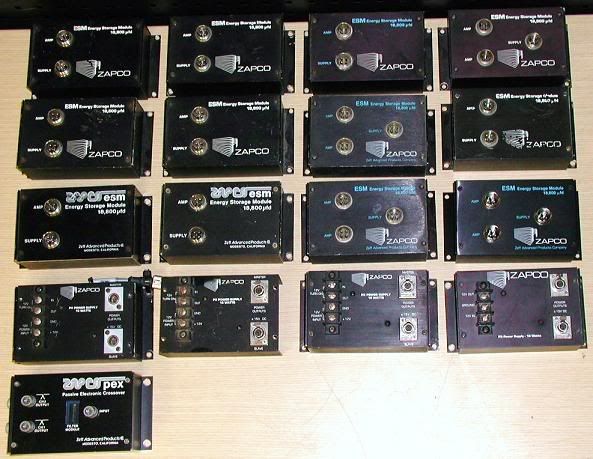

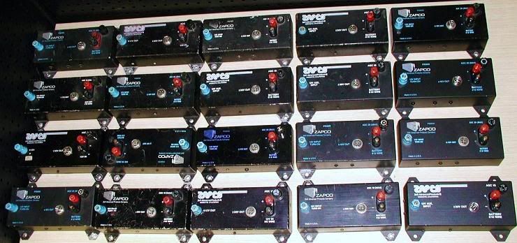

Till then, here are some new pics of the 150's and 151's. I think 2 sets are not pictured. (need some more ESM's if anyone has any extras) . Plus here is a pic of the Linear Power amp's guts.
So this board was designed by someone in Berkeley? I wonder if the entire amp was assembled in the US?

Pic of the inside of the amp section of a 151. Not much to it, but they sure sound nice.
I think *I'm* going to cry. At least sulk...

ppia600 said:So this board was designed by someone in Berkeley? I wonder if the entire amp was assembled in the US?
Very cool amp. There seem to be a couple of give aways to the build. AFAI remember, the 80's models also had the Berkeley reference. Seems like the Class "A" models claimed "technology under license by Threshold" in the manual. They were designed in the US and made in Korea, thus the ability to sell them at more affordable prices.
I guess they were ahead of their time in that respect.
The board design is the same as the older models -as in single sided with familiar looking traces, the same green solder mask, and no silk screen layer on bottom. But the top side in your amp looks much cooler in flat black then the raw phenolic color.
(It is definitely neater inside and looks easier to disassemble than the older models.)
As well, the interior hardware looks like the previous Korean bits, but the external stuff does not.
I'll take apart an older one in a couple of days to check my memory and compare, but I dread the individual mica insulators...
