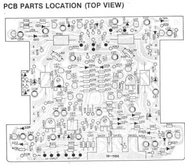

The Crown Suspect is most of a triplet of Proton 250’s. Looks like the soft-clipping circuit and speaker level inputs may not be there. A single 250 was about 6” by 12” and stood on little legs for ventilation.
At the time the Proton version was produced (early 80’s), they only marketed the 250 and its little brother the 222. They were both very good sounding amps, evidently targeting the ADS P100 and P40 as competition. I liked the Protons better. Neither brand was built for bassheads who hadn’t quite emerged yet, but I did run a few 222’s on 10” woofers with good results. I was told Proton products were actually NAD products by a few Proton reps and NAD dealers, and similarities are evident.
There’s a bank of switches outlined on the board, but not in place:
SW201 is the Hi/Low input selector, and goes straight into the 4559 op-amp labeled IC 201. That *is* the gain control, as in 2 choices- speaker level or preamp level. You could replace/modify the voltage divider there for adjustable gain if it’s important to you.
SW202 turns on/off the ‘Soft-Clipping’ circuit that Proton used on virtually every amp they made (home and car) in the 80’s. NAD also used this circuit. Looks like a limiter that works to reduce the output of the buffer?
SW203 is the bridging switch, and could make 3/4/5 channel options easier for your amp.
I had to crop and compress this scan to post, hopefully it's at least visible...

Thanks for the info. Good to know what the missing switches are for. Luckily the boards are labeled pretty well. SW201 and 202 are missing but there are pins where SW203 goes and on the section that is bridged has a couple jumpers soldered across the pins. Looks like it's just a matter of adding/removing the jumpers for stereo/bridged operation.

Interesting, I have an NAD home amp with soft clip lights on it that don't seem to work. Has some buttons on the back for it but I don't know what it does, nothing seems to make it work. Nice little amp but my old HK sure is nicer.

I can send you the whole set of readable scans if you'd like, just send me an email. Schematics, board layouts, etc.

Proton's home division called it 'Anti-Clipping Circuitry', and the button was labeled ACC. It may be that the light isn't on until it clips, I can't remember.
If you'd like the 250 schematic to see how it was implemented, send me an email.

Email sent. Maybe if I get bored and start feeling frisky I'll add the soft clip circuit and hi/low switch.
